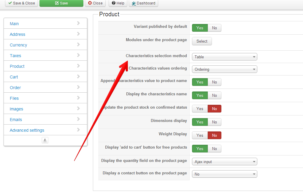

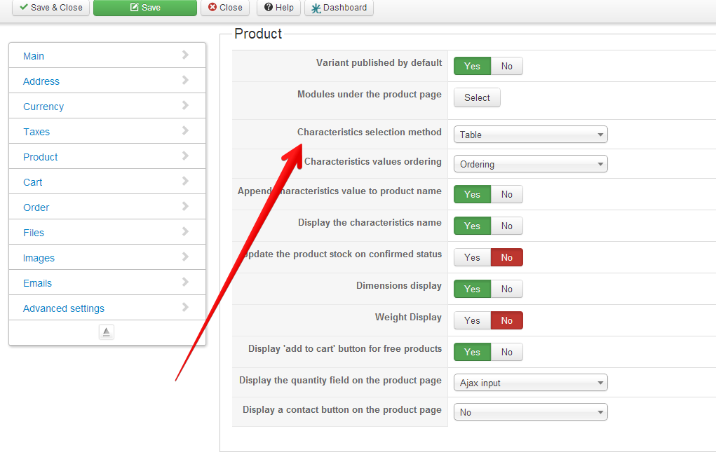

13 years 5 months ago #94451

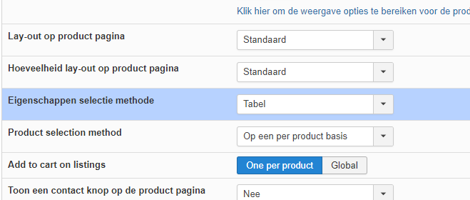

You can change the characteristics display method to "table" in order to not be able to select non existant variants when you have two characteristics for products.

13 years 5 months ago #94903
It's in the configuration page of HikaShop:
The following user(s) said Thank You: Digiwacht

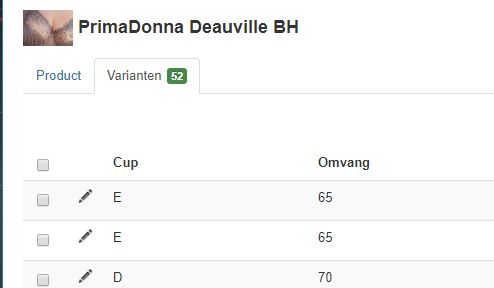

8 years 6 months ago #288232

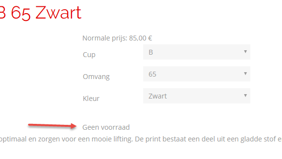

Firstly, are you using the last Hikashop version ? Can you download it on our end, install it and test it again ?
If that's the case, can you show us screenshots of your product variants listing ?
Thank you.

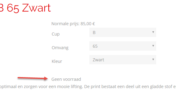

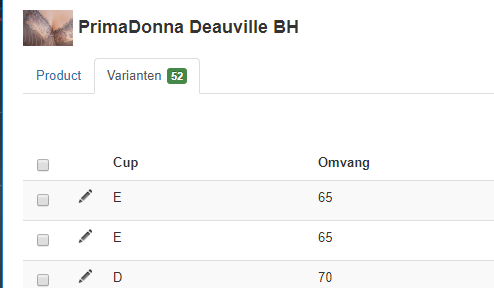

  • Posts: 61
8 years 6 months ago #288278
Just updated to Hikashop Business 3.3.0 on Joomla 3.8.5.
Attached you'll find the screenshots. Front-end and back-end.
This product ranges between A-G, 65-115, black and nature. But the size 65B doesn't excist. No stock it says (Geen voorraad)

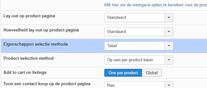

8 years 6 months ago #288285
Can you try it with the "Characteristics selection method" option set to "Table" via "Hikasop->System->Configuration->Display" ?
Thank you.
  • Posts: 61
8 years 6 months ago #288357
Already did.
  • Posts: 86112
  • Thank you received: 14209
8 years 6 months ago #288365
The "table" display of characteristics will only work with exactly two characteristics. But on your product it seems that you have three characteristics.
You should rather use the "list" selection method which can work regardless of the number of characteristics.
