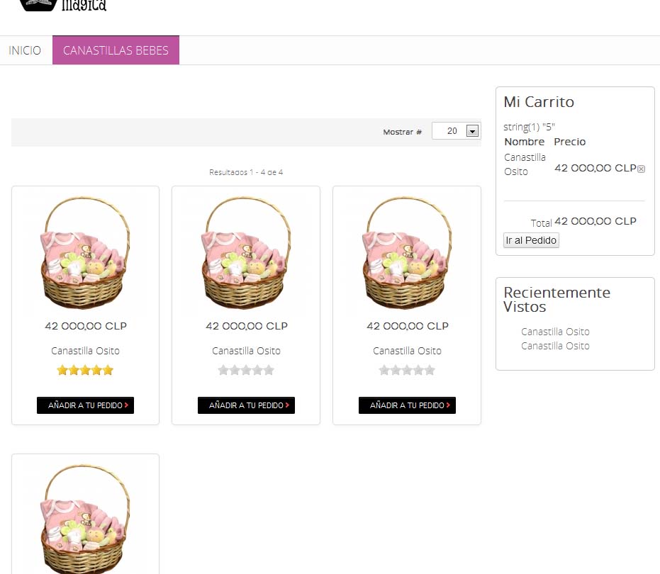

12 years 11 months ago #96522
if i add the last string you gave me nothing is displayed when i add the first one <?php var_dump($row->cart_product_id); ?>
displays: string(1) "5".
i´m sure i have an image on it i
i´m using joomla 3 and last hikashop version.
