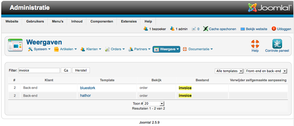

I did a clean install of Hikashop Business 2.1.1 and so far everything is working just fine. The one thing I cannot do (so far) is to change my invoice layout, because there is no invoice layout. I have checked just about all the forum discussions but I can't find the answer I need.
For the layout I go to "Display -> Displays -> Filter on invoice". The is only the invoice for the backend. Please see the attached screenshot.
What do I have to do in order to be able to change the invoice?
  • Posts: 86216
  • Thank you received: 14222
13 years 5 months ago #97079
With the PDF invoice plugin, you need to edit the file plugins/hikashop/attachinvoice/attachinvoice/invoice.php to modify the invoices generated.
