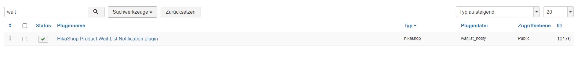

Did you make sure your cron task is up and running ?
www.hikashop.com/support/documentation/5...cron-task.html#check
Also, did you make sure the wait list plugin is enabled in the Joomla plugins manager ?

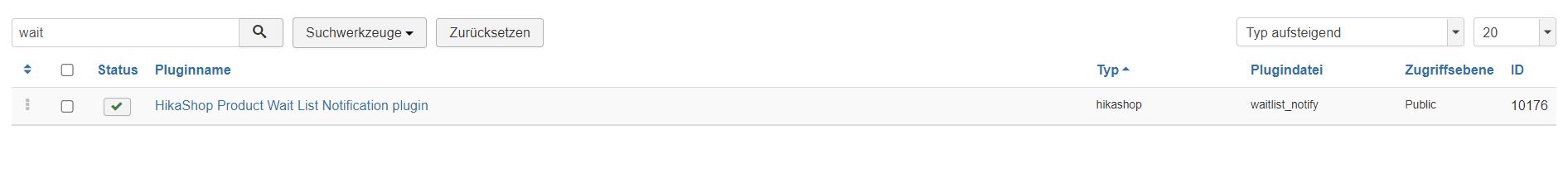

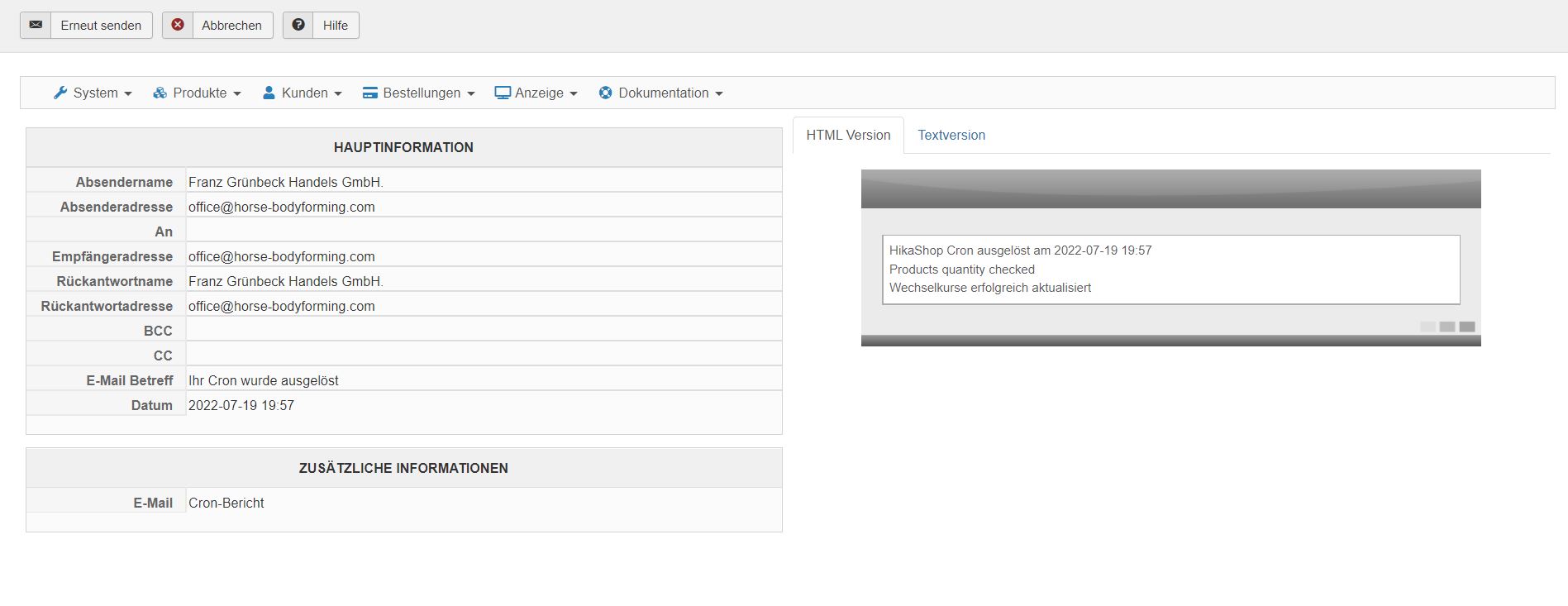

Hello, thank you for your answer.

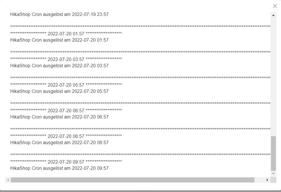

Plugin is enabled, cron job is running. I get mails when stock is zero from cron job but peple are not informed when stock is > 0 even there are waiting people. I read the documentation and think I did all the things that shoulc be done ....

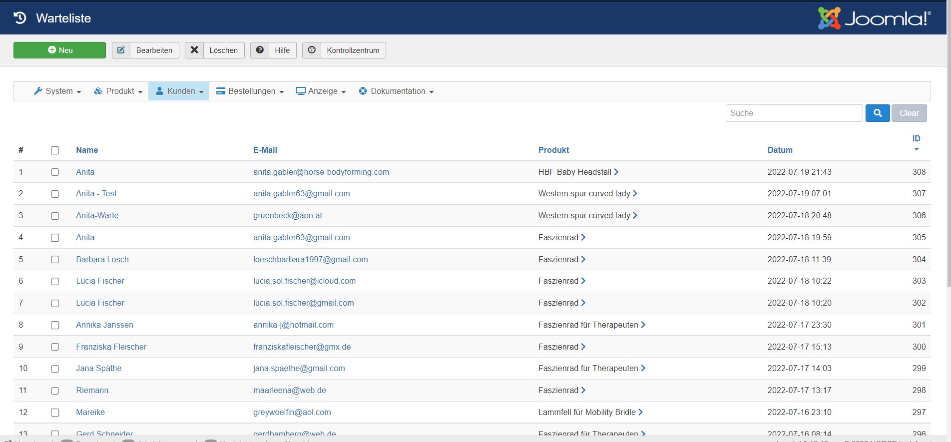

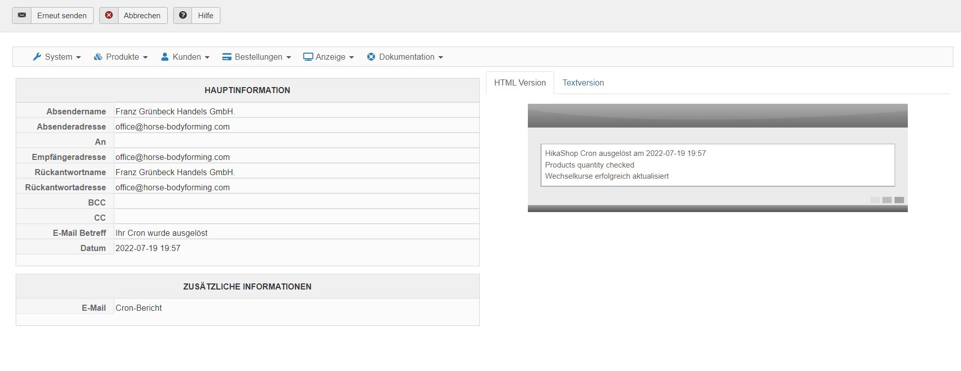

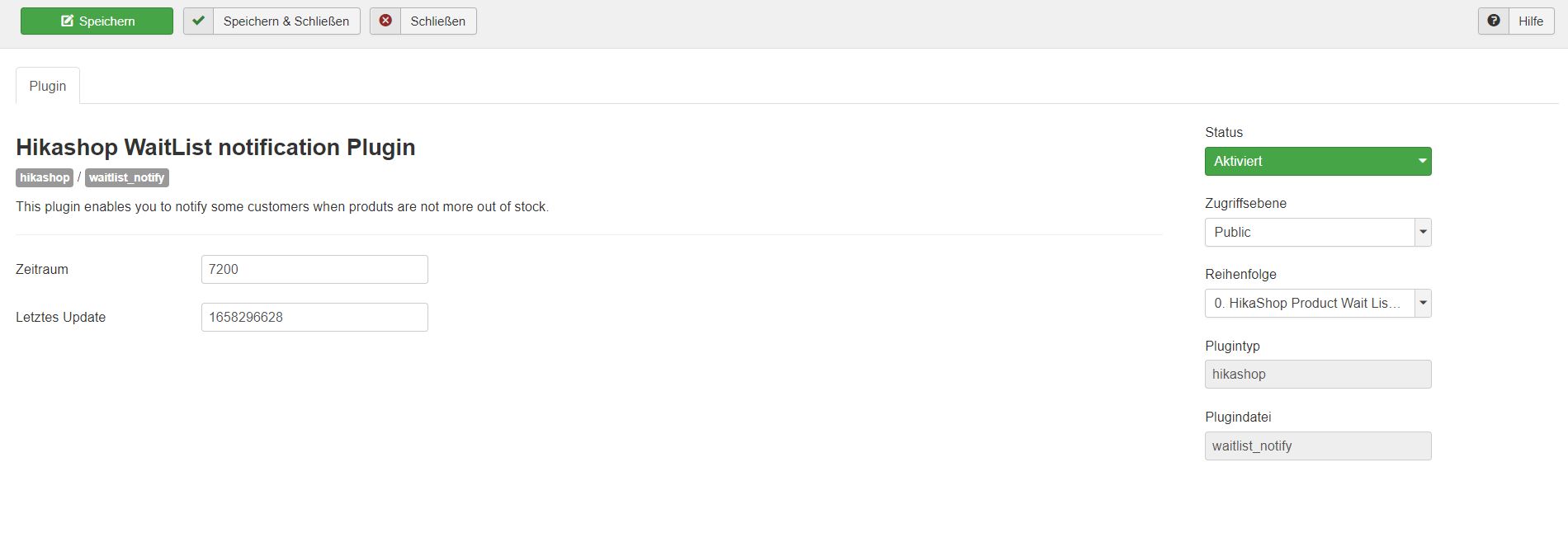

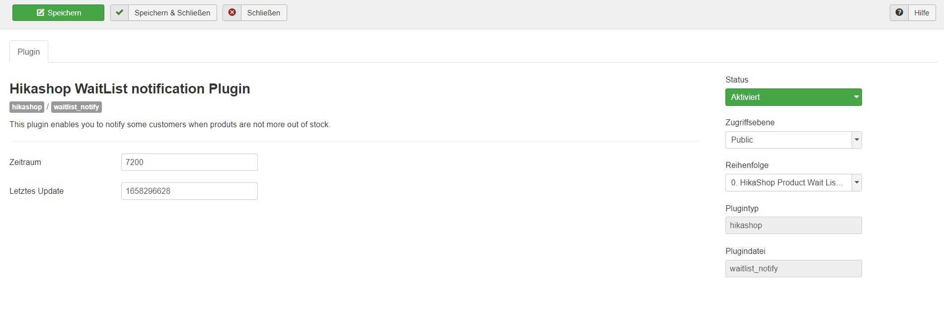

Could you provide a screenshot of the settings of the wait list plugin ?
Also, can you check the menu Customers>Emails history ? There, you'll see all the emails sent by HikaShop. So you can check if the emails are sent by HikaShop or not, regardless of whether the email ended up in the spam folder of the user or was rejected by their email server for spam reasons.
Also, in the Customers>Waitlist menu, you can check the list of users waiting for a product. Once the email is sent for a product for a user, the entry will be removed from that listing.
Finally, note that the notification to the users is not instantaneous. There is a delay as the email is only sent when the cron task triggers the wait list plugin.

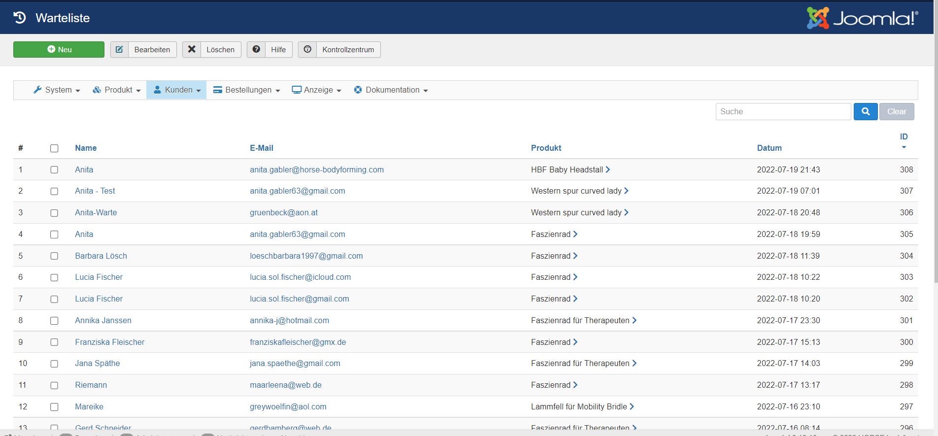

  • Posts: 40
  • Thank you received: 4
4 years 2 months ago #343369

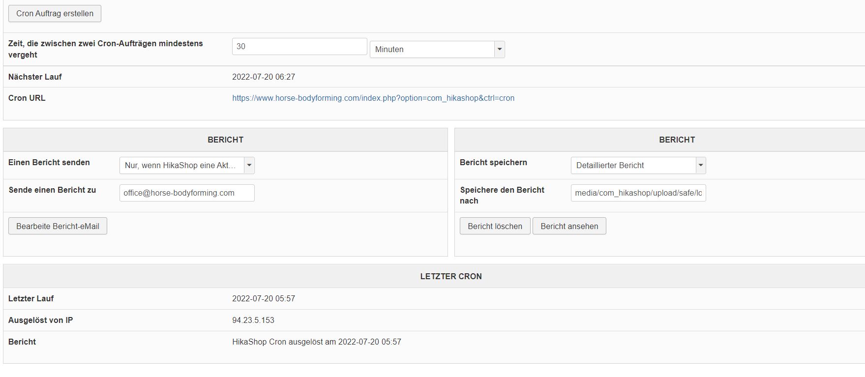

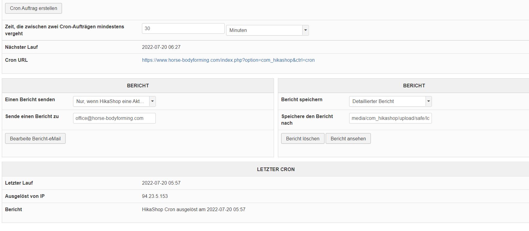

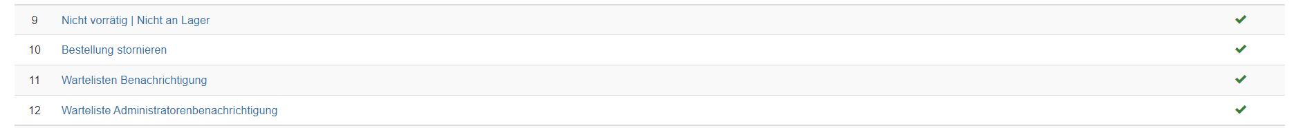

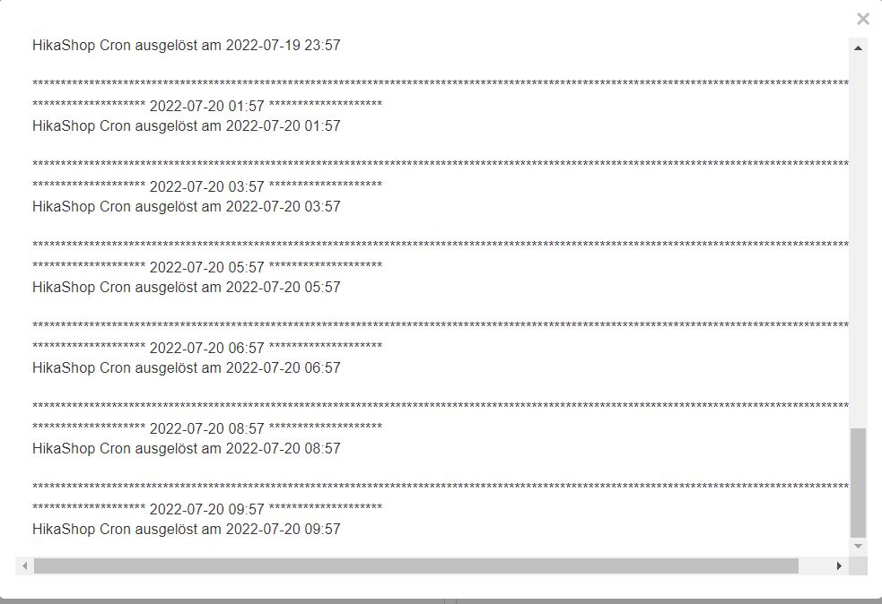

Here are screenshots. Cron job is running, but no emails are sent to the waiting customer. products are now on stock.
Last edit: 4 years 2 months ago by Agabl123.
  • Posts: 86183
4 years 2 months ago #343373
Could you provide a backend access so that we could check everything more in depth ?
Please provide it via our contact form with a link to this thread for reference:
