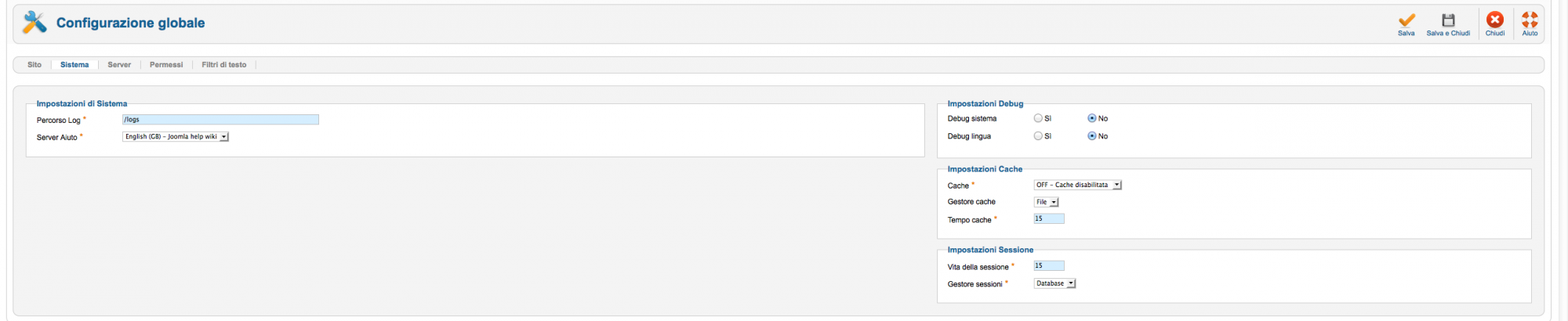

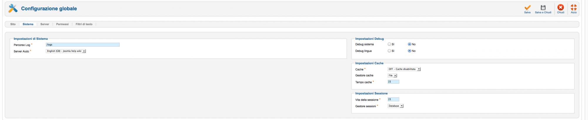

sorry, i was to "Control panel->Global configuration->system" but here there isn't "New User Account Activation'"
here there is that is in screenshot

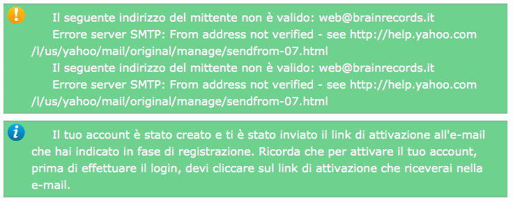

mail arrive always to me. ihavei to change some another parameter?

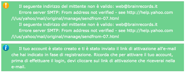

mail arrive always to me. have i to change some another parameter?

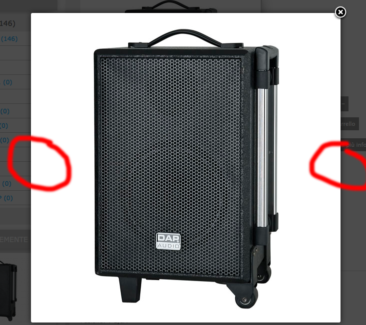

appear like sreenshot n1
in details page, i have added more photos, like screenshot n2, and it's ok
but when i click on one of these, i can see just one photo. there's a possibility to add two arrows for to see all photos, like carousel?
like screenshot n3
  • Posts: 86180
12 years 7 months ago #142984
1. As you can see, you have an error returned by your email server. It seems that the "from" address that you entered in the Emails section of the configuration of HikaShop is not ok. Please check it with your email server (your hosting company probably) support so that they can tell you what to do regarding that.
2. If you want arrows here, you need to use that:
www.hikashop.com/support/support/documen...ox-media-player.html

12 years 7 months ago #143092
hi,
the error mail appear if i change the joomla mail cofiguration not f i change the hikashop configuration.
this is the prblem.
heave you idea why its append?

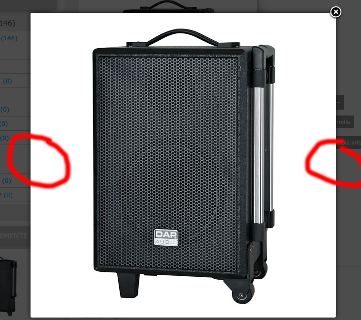

2. I used that module, and i followed the documentation, But nothing appene.. like a screenshot.
What can i do?

i went to: hikashop > system > main > emails and i setted Bounce Address with my customers email and now when person is regitering, email comes to he. it ok!!!

2. The problem is probably coming from the fact the missed one of the documentation step. You should try again, follow each step of the documentation and tell if something isn't clear :).

2.i installed the Shadowbox Media Player plugin and i setted it on enable
i Download the override file.
i extracted it to my pc and i put hikashop_image.php into /templates/beez_20/html
i see that you can see in the latest screenshot only images without anothing.
what can i do?
