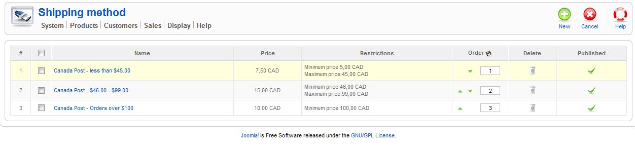

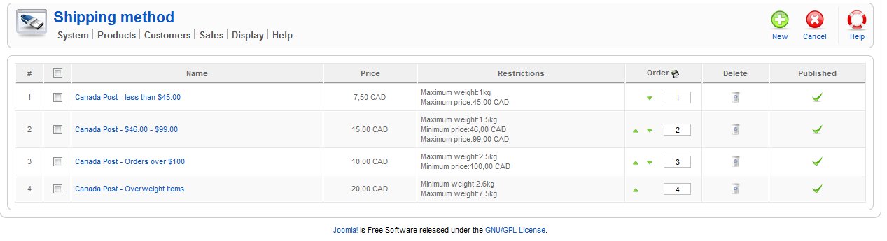

I am having problems with making the shipping amount consistently applied to a order. Sometimes it is and sometimes it is not. There does not seem to be a rhyme or reason to it. :(
I have attached a image file showing the manual shipping methods I have setup.
  • Posts: 86183
15 years 6 months ago #8918
If your order weights between 1kg and 1.5 kg and that the total is below 46 CAD, you won't see an shipping method available because you don't have any shipping method for such case as well as other cases.
The shipping methods restrictions need to be all matched in order to be displayed. If you have an order between 1kg and 1.5 kg and that the total is below 46 CAD, the first shipping method won't match because the weight is too high and the second won't match because the price is too low.

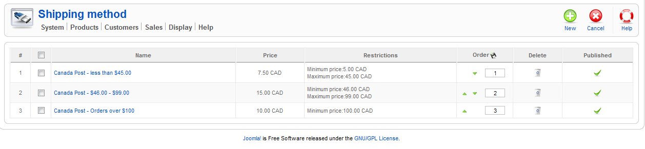

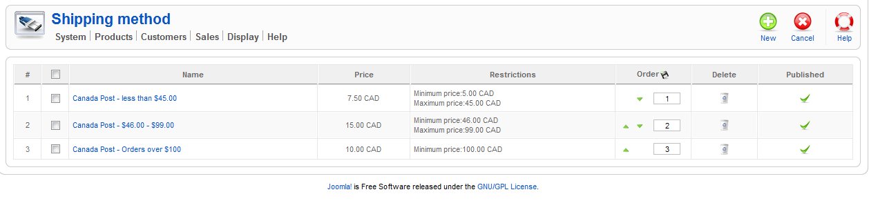

Sorry, I am still having problems with the shipping. I have attached the shipping methods that I am currently using which is just price dependent. Sometimes the shipping cost will be applied but often not. I remove all the items from the cart and start again with still the same result.

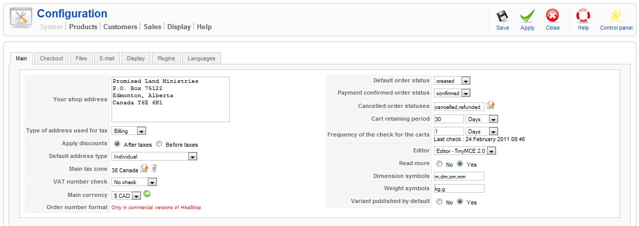

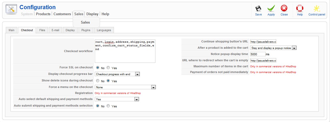

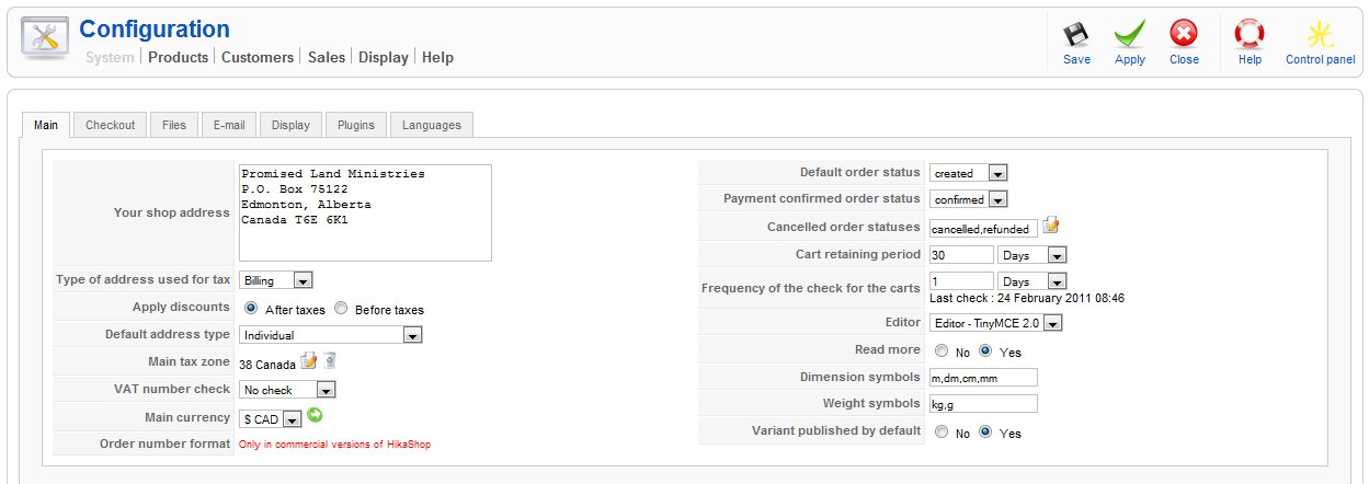

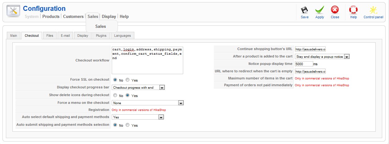

Have checked all the points on the FAQ. Attached is the screen-shot of Checkout
  • Posts: 39

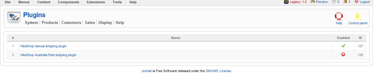

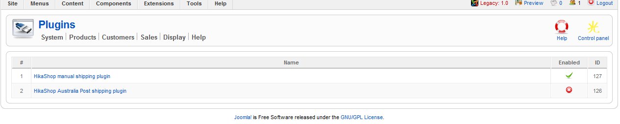

15 years 6 months ago #9188

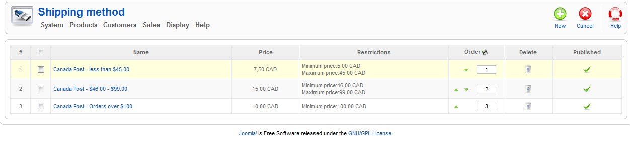

Attached is the screen-shot of Plugins
  • Posts: 39
15 years 6 months ago #9189
Attached is the screen-shot of Shipping Methods
