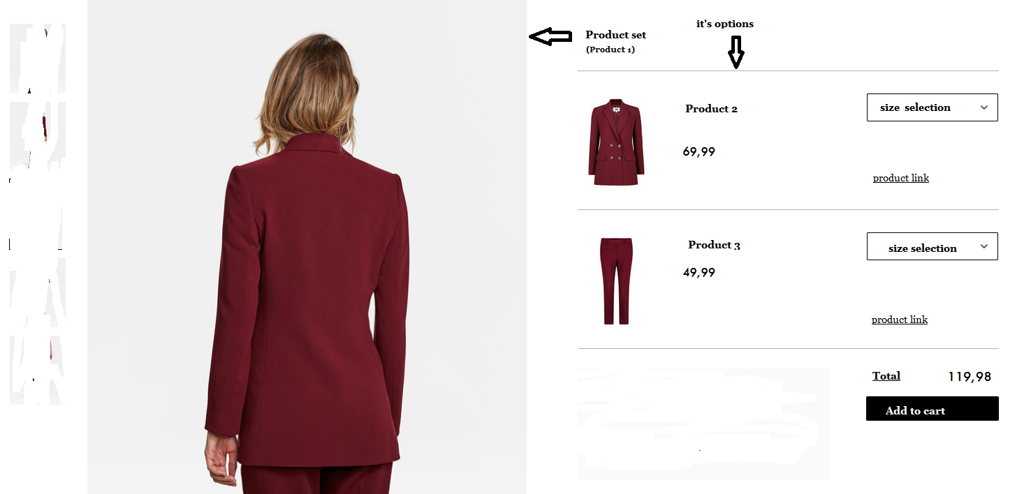

We have 1 product which is set of 2 products. As example for better understanding lets call it. Pants and t-shirts.
Those pants and t-shirts are on sale seperatly too. So basicly we have 3 products on sale.
In the product page which is set of the product we would like to show pants and t-shirts in the list and allow to chose size for each of product option. I am not sure how to explane it well so take a look to the screenshot.
The customization it's self is fine i am just struggling to understand how this can be done with hikashop.

You would have 3 products:
- the "product 2" with a characteristic "size" with a variant for each size available for that product.
- the "product 3" with a characteristic "size" with a variant for each size available for that product.
- the product set" with both product 2 and product 3 added as options.
That way, you would get a product page with one dropdown for product 2 for the size selection and one for product 3 for ths size selection, the total with options and the add to cart button.
Then, it's just some customization to add the product 2 and product 3 images and some CSS to make it look like on your screenshot.
