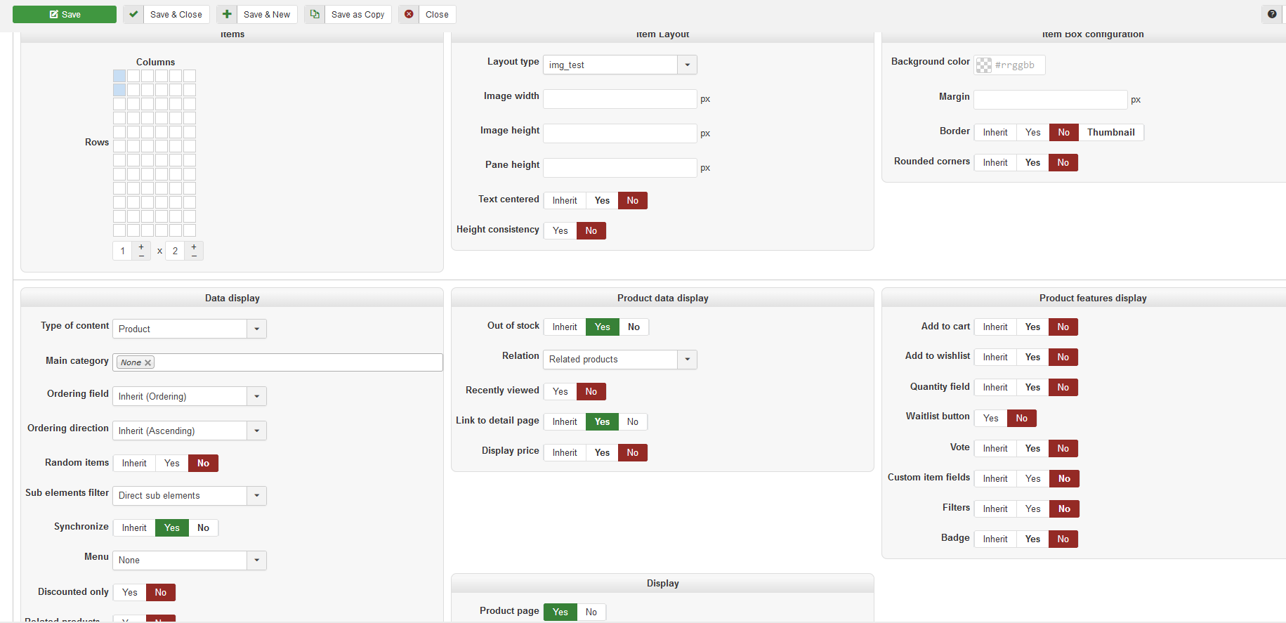

step 1 : create a new hikashop content module - > setting set relation : Related products
step 2 : go to hikashop setting -> display tab -> Product options section -> Modules under the product page = select a module Related products
step 3 : go to product and set a Related products (search product name show a product and select ->save)

Also, p30yaran's method is generally valid in this case, too. Plus, as far as I understand you, you want to take the following additional steps:
4:
Create a view override of a product listing view file close enough to what you want through the Display -> Views menu in the HikaShop backend, e.g. for listing_img_title.php.
If an override for this view already exists (indicated by the trash bin in the views listing), give the new one a new name, e.g. listing_related.php, and save.
5.:
Edit this view to your liking, including all the PHP you want.
6:
Back to the module which you created following p30yaran, there with "Div" selected, find and pick your new view under "Layout type".

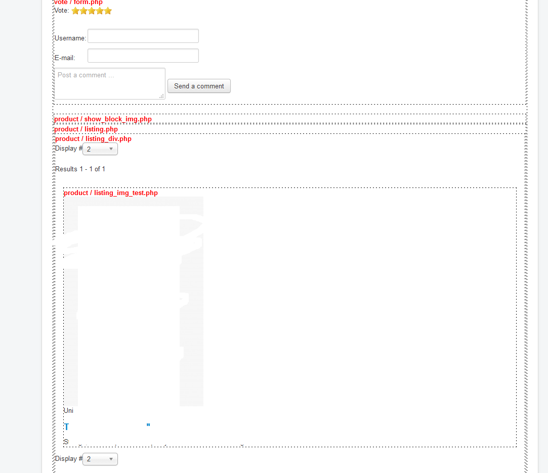

1. Well that doesn't help. The issue is that that view is wrapped inside 3 other views. As we have done some modifications to listing_div.php view so some unwanted html which we use on product listings is also outputed...
Maybe there is some params we could use so if relation is set to related products via module settings do or not do something....??
2. Another thing we noticed that pagination is also displayed which shouldn't be for related products? Setting random items to "YES" does fix the issue....

1. If you look at the code of listing_div, you can see this:
Code:
$itemLayoutType = $this->params->get('div_item_layout_type'); ... $this->setLayout('listing_' . $itemLayoutType); echo $this->loadTemplate();
That's the code which loads listing_img_title or listing_img_desc, etc based on the item layout setting of the menu item/module.
So you could modify product/listing.php, get the $itemLayoutType = $this->params->get('div_item_layout_type'); line of code to load the item layout of the module, and if it's your custom layout, then you could call listing_custom instead of listing_div in the line:
Code:
$html = $this->loadTemplate($layout_type);
2. Pagination is supported for modules under the product page so that if you have more related products than space available to display them, you can have a pagination to see all of them.
Now similarily to point 1, you could turn off the pagination if the item layout is your custom layout like that:
$this->config->set('pagination', '');
The following user(s) said Thank You: kyratn
