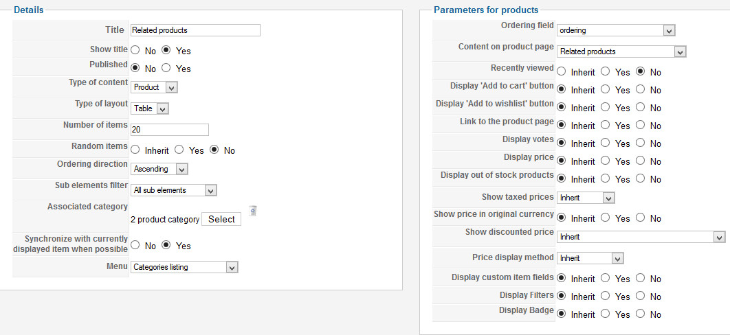

On the same paragraph of your documentation there is a link that pops the following screenshot:
On "HikaShop Content Module" there is no option "Display filter" as there is on your screenshot. Please help us find a solution as we are trying for days to resolve this issue.

When we say "product listing module" on this documentation page, we mean "an instance of the HikaShop content module configured to display a products listing". So it's not that we changed the name of the module. It's more like a small imprecision in the documentation. So yes, you're using the correct module to display your products listing on the vendor page.
And regarding the screenshot there, it's an old screenshot from years ago. That option never worked as filters can't be displayed in products listing modules (instance of the HikaShop content module configured to display a products listing) so the option was removed early on.
The fact that this options appeared there was because the interface was a big copy / paste of the interface used to configured products listing menu items which was then modified to adapt it to the module settings and the person who worked on it forgot to remove that display setting from there at first.
