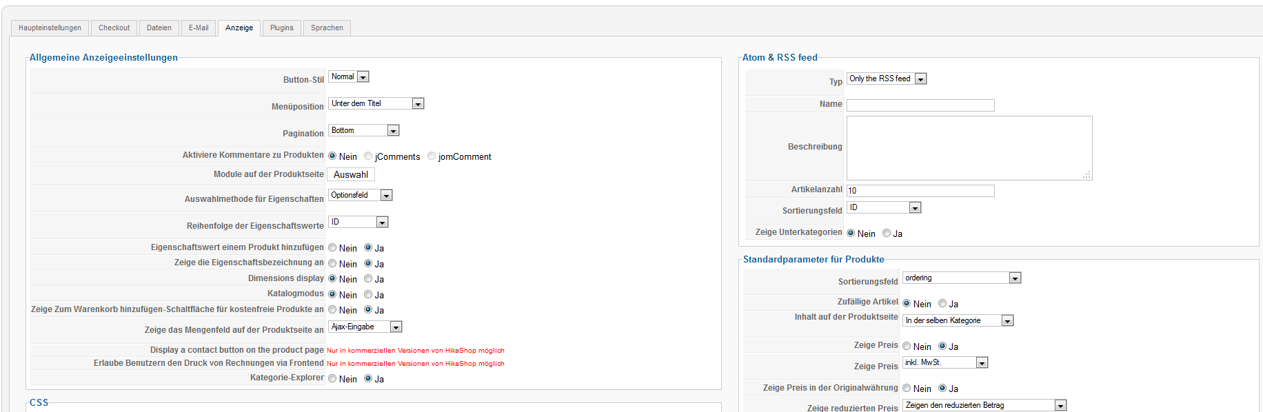

  • Posts: 10
14 years 10 months ago #29073
yes i think i did this settings.
I made any pics from the different settings.
Uploaded with ImageShack.us

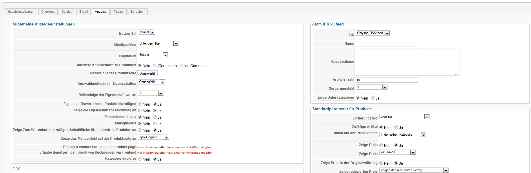

  • Posts: 10
14 years 10 months ago #29111
Hi again,
i did have a look to the settings you told me. I think they are all right.
There are two pics i made.
The settings for Germany are about 19% MwSt. Germany is the default tax kat.
I do not understand, that i only get an affect in the frontend, if i choose the setting: exkl. und inkl. MwSt.
The pics will show you what i mean.

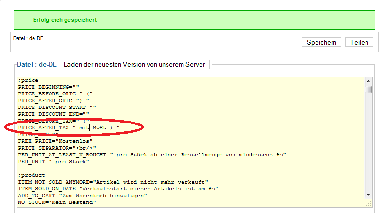

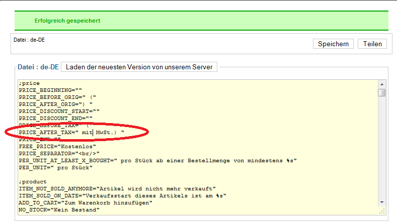

  • Posts: 10
14 years 9 months ago #33262
Hallo zusammen,
um es nochmal klar darzustellen, habe ich diese Änderungen wie beschrieben durchgeführt.
Auf Bild Nr.1 wurde die Sprache angepasst:
Wie auf Bild 2 zu erkennen ist fehlt trotzdem jegliche MwSt. angabe im Shop, in der Kathegorie und im Einkaufswagen:
Dagegen bewirkte die Änderung dass der Preis bei dem Versandmodul jetzt falsch dargestellt wird. Nämlich der Preis ohne MmSt. wird als Preis mit MwSt. dargestellt:

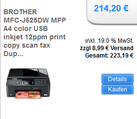

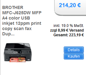

  • Posts: 10
14 years 9 months ago #33278
Ok, now I have got it work
and I can reproduce the error also.
The bug? concerns the tax rule -> zone.
Go to -> Hikashop -> System -> Taxes -> Icon New
In the new opened window click on the edit-icon (pencil) besides "zone". Here choose "Germany", save.
Go to Product, make a new one, and do all settings and choose under tax categories, this one you have just made with zone german. The price in product is calculated WITH tax, all okay. But in frontend, it's shown WITHOUT taxes.
@nicolas:
I will have sent you a PN, with login data and URL to full backend access to hikashop and menus.
You will find "product one" with taxes zone 0 - all fine, Tax is shown in frontend
and "product germany" with taxes zone 81 (germany) - Tax is not shown in frontend.
Last edit: 14 years 9 months ago by Pixel.
