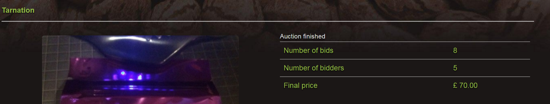

I have another issue now. This software seems like it should still be in beta. When someone checks out it is charging the starting price only. Now we are losing money here.
Here is the closing price:

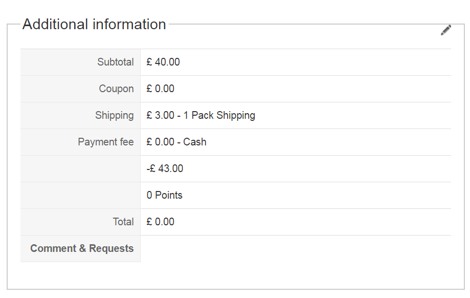

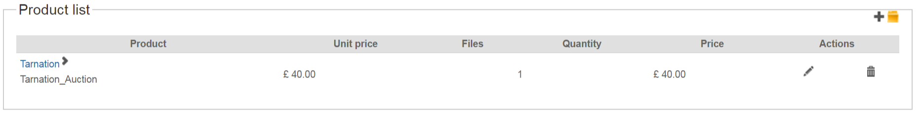

this is what they were charged at checkout using points for some of the order and selecting cash for the rest.
