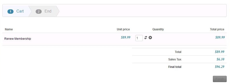

Also I just updated my HikaShop version to see if that would help but still having a problem. After updating though, now the product currency is italicized and the word "Finish" on the button is not visible. I do not want the currency italicized. Please see pic.

Please provide a screenshot of your checkout workflow.
About the design, HikaShop 2.3.0 now include new styles.
You can use the "old" style in the HikaShop configuration in order to retrieve the old style when the price is not in italic etc.

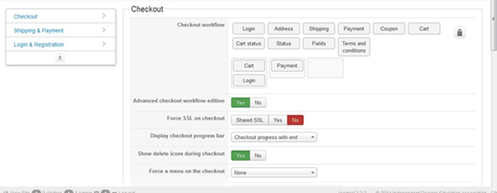

  • Posts: 54
12 years 6 months ago #148198

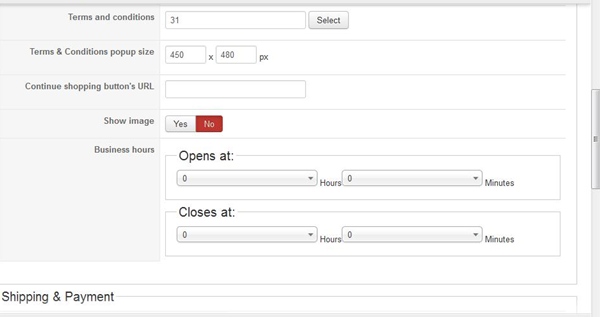

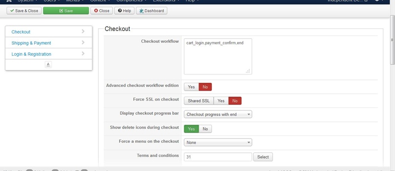

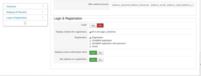

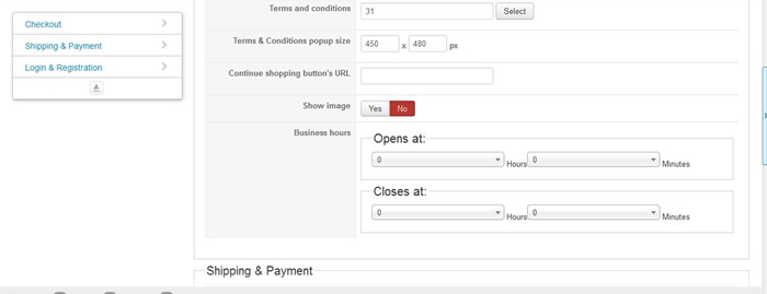

Thank you for the help Jerome. Here's the pics of my checkout. I was just messing around with it and added payment to the workflow and then tried it. I get the error "Wrong_Shipping_Address". So it must be due to shipping? How do I 'turn off' shipping altogether? I am only selling memberships so there is nothing to ship.
12 years 6 months ago #148223
You checkout workflow is not correct, you need to have the steps "Address", needed in the order for the billing address.
And generally the "Payment" step is asked, without this step it's normal that the customer is redirected to the home page.
But with this step, the customer is redirected to the payment page.

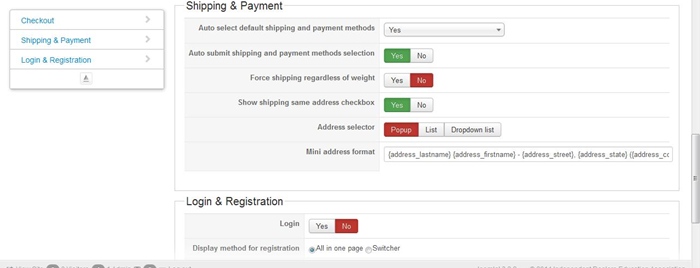

12 years 6 months ago #148277

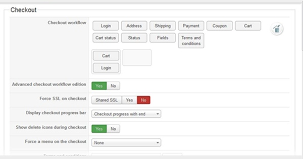

I had Payment in the workflow originally and it stopped working. I took it out and that's the workflow I took pics of to show you. I have put Payment back in. My users can either sign up for membership and register then pay or they already have a membership but need to renew so they log in and then pay. So the checkout workflow has them register if they are not already.

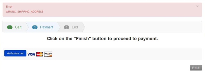

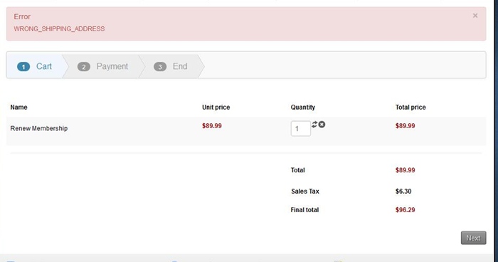

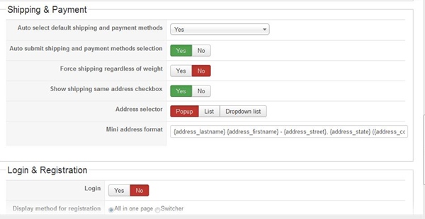

Here's the revised checkout workflow and the errors I am getting. Both of my products, membership and renew membership do not have any weight associated with them. The error pics are from the view of a user who is already registered and trying to renew and pay. This is the same thing that happens if a new user registers on my site and tries to pay. Why is the error saying wrong shipping address?
12 years 6 months ago #148282
Can you test it with the address step added to the first step of your checkout workflow ("Hikashop->System->Configuration->Checkout") ?

  • Posts: 54
12 years 6 months ago #148360
I appreciate everyone's help on this. I just added Address to the first step in the checkout workflow and I am still getting the same error Wrong_Shipping_Address and when I try to process the payment anyway clicking on Next then Finish it just goes back to the home page and not to Authorize's payment form. The order is created in the backend though.

12 years 6 months ago #148467
Ok I was able to get the error Wrong_Shipping_Address to go away. It was the TaxCloud plugin!! When I updated Hikashop, I enabled this plugin to hopefully starting using TaxCloud. So I disabled this plugin and the error is gone, BUT I am still only redirected to the home page when I click on the Finish button when I should be redirected to Authorize.net's payment form.

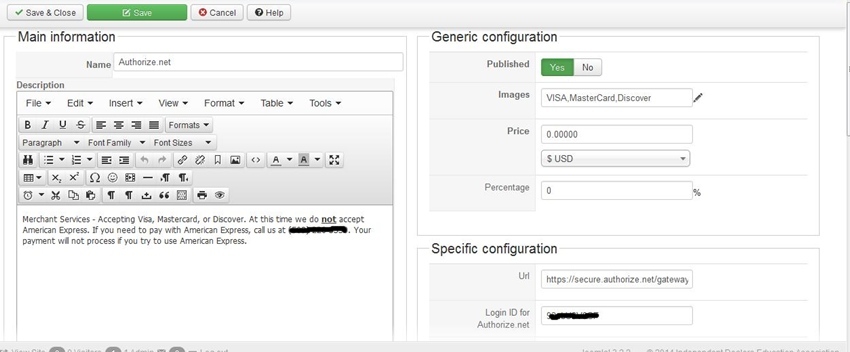

12 years 6 months ago #148558
Can you show me how did you configured your Authorize.net payment method through some screenshots ?
  • Posts: 54
12 years 6 months ago #148572

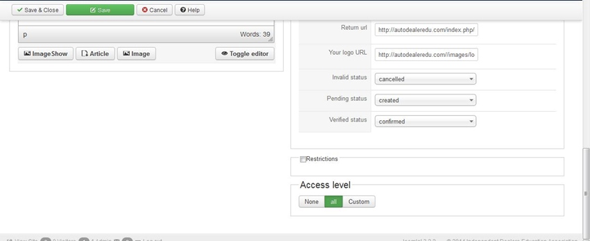

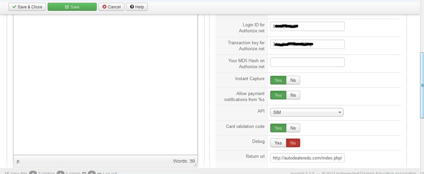

Thanks for the help. Here's the screenshots:
Last edit: 12 years 6 months ago by dbarnhart863.
12 years 6 months ago #148660
Note that you should also complete the "Your MD5 Hash on Authorize.net" option of your Authorize.net payment method.

12 years 6 months ago #148707
Ok,
Can you :
- give me a link to your shop so that I can directly test it ?
- go to "Hikashop->System->Configuration->Checkout"
- set the "Advanced checkout workflow edition" option to NO
- Show me a screenshot of your checkout workflow
Thank you.

  • Posts: 54
12 years 6 months ago #148830
Thank you! I will send you a pm with the details of the login. My site is live so users cannot register on it right now. But I have a menu item published for logged in users so that you can test it. Please log in, go to Renew Membership on the main menu to test.
Here's a screen shot of the checkout workflow with the Advanced Workflow set to No. That's the only thing that I changed so everything else looks the same and can be seen in the above pics in the previous screenshots.
