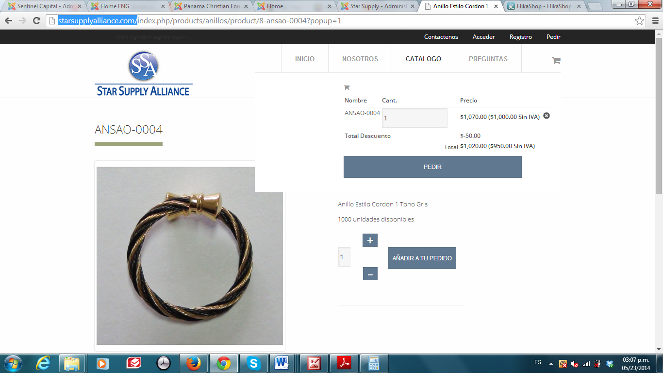

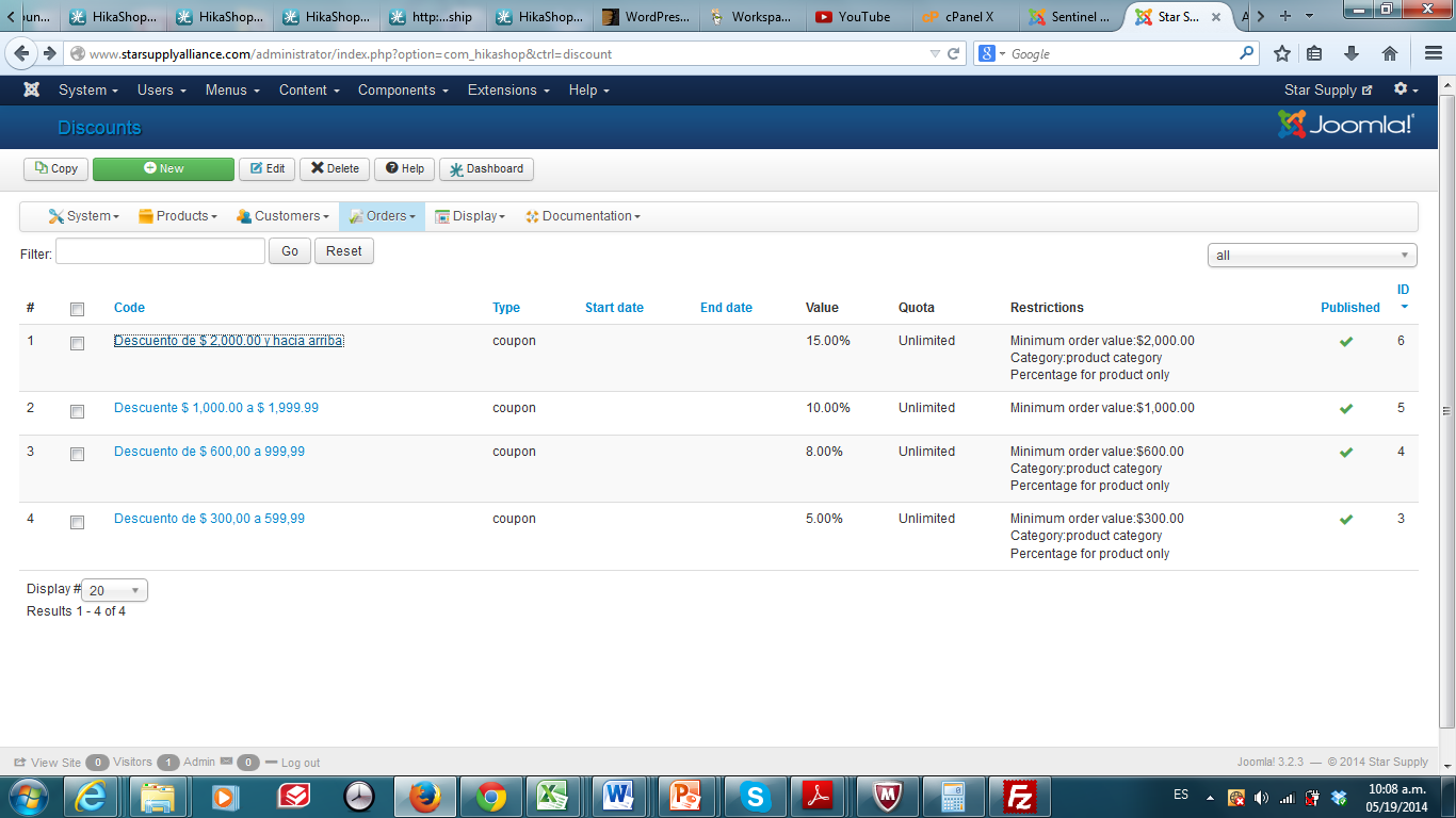

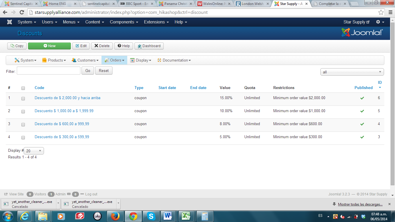

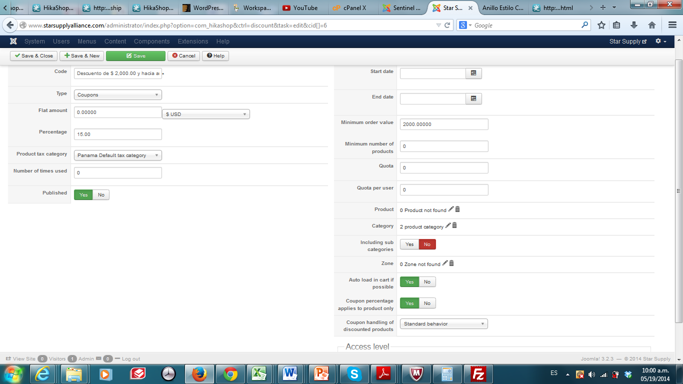

  • Posts: 122
12 years 4 months ago #156407
Hi guys,
I attach the screenshot of the coupon set up and the complete coupon list.
I have the Category set to 2 product category
Whether I set Coupon percentage applies to product only to Yes or No the discount applies 10% which is the $1000 bracket coupon rather than the 15%
How do I get the 15% discount on the total?
Thanks,
Mike
  • Posts: 86183
12 years 4 months ago #156449
I would recommend to remove the category selection and turn off the option " Coupon percentage applies to product only" so that it applies to the total purchased order. Make sure that you do that for all the coupons.
It should work fine then.

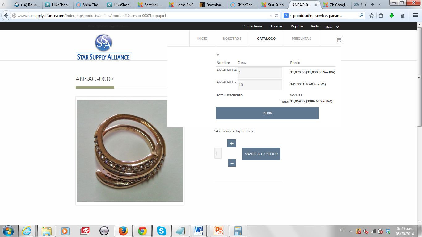

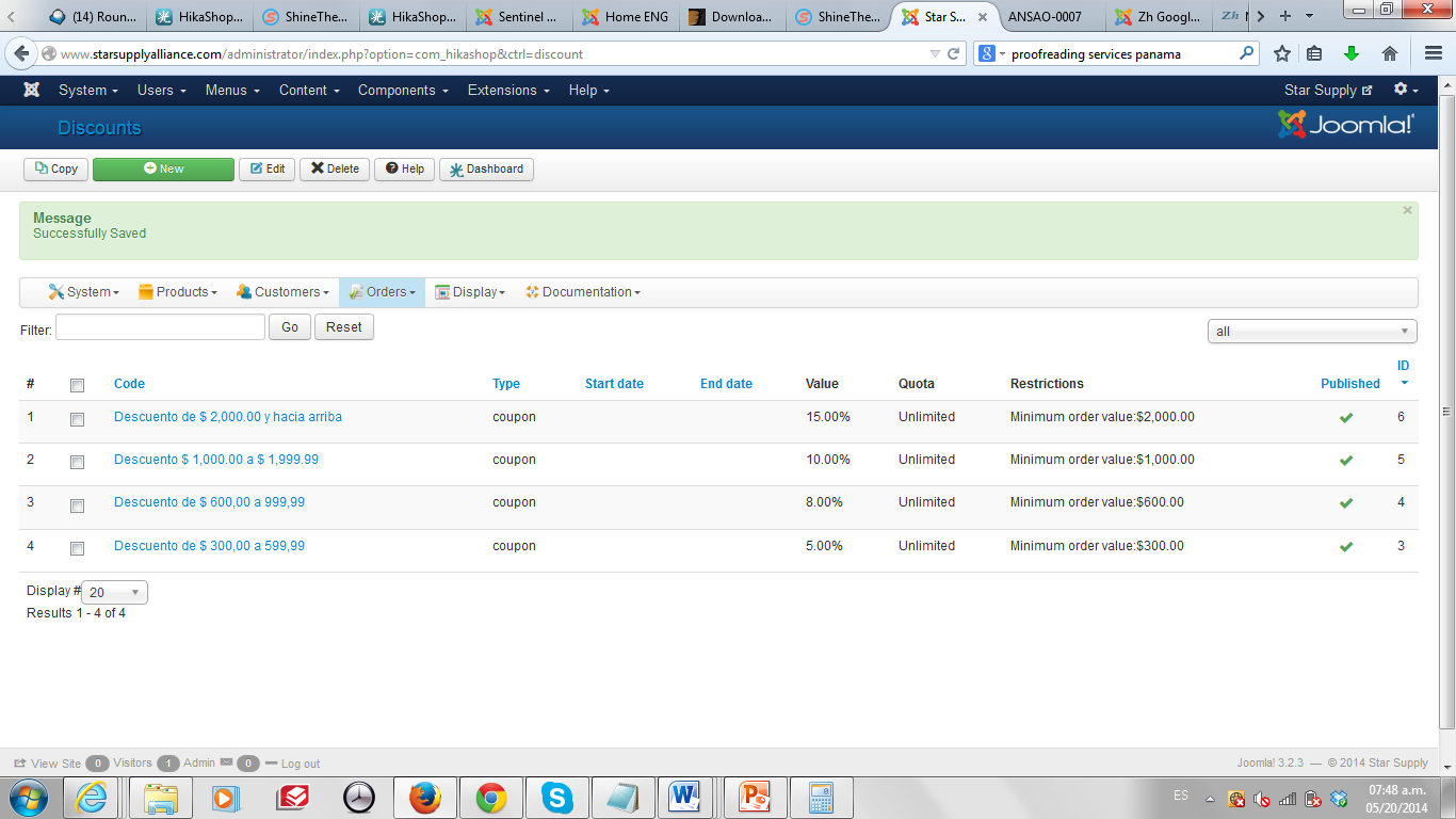

  • Posts: 122
12 years 4 months ago #156567
I followed your instructions and now the cart seems to me calculating the discount across the whole cart correctly but it seems to be only using the lowest rate of 5% to make the discount even when the order is above $1000 which should give a rate of 10% - see screenshots.
What could be causing this issue?
Thanks,
Mike
12 years 3 months ago #156573
Hello Mike,
I think that you should also set a "Maximum order value" for your coupons like 599.99 for your 5% coupon.

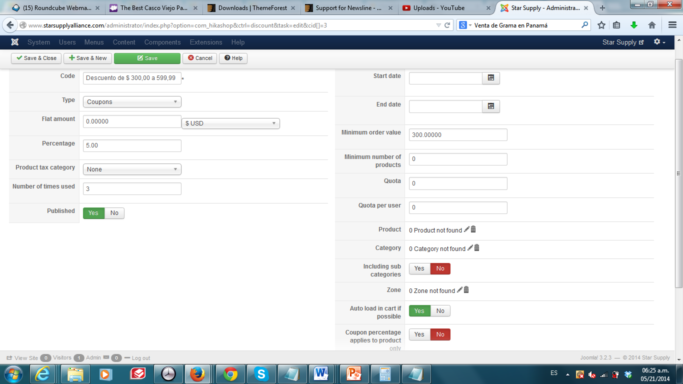

  • Posts: 122
12 years 3 months ago #156739
Hello Mohamed,
Your suggestion makes sense to me but I cannot see this option - see attached screenshot.
Please advise.
Thanks,
Mike
12 years 3 months ago #156877
There is indeed not this option for the coupons.
I have reproduced the issue on my local. I add in the todo list to debug that as soon as possible.
We will keep you informed. Thanks for the report.

12 years 3 months ago #158461
Hi Xavier,
Thanks very much for this.
However, I cannot find the string loadFullCart() to replace it in cart.php.
Please advise.
Mike
  • Posts: 86183
12 years 3 months ago #158898
Please do that modification and it should fix the problem:
www.hikashop.com/forum/product-category-...orrectly.html#158811
  • Posts: 122
12 years 3 months ago #158977
Hello Nicolas,
I installed the fix but the discounts re still not working properly at starsupplyalliance.com/ (see attached screenshot for coupon levels.
For example,
- there is no discount applied for sales between $300 and $600
- an incorrect discount of 10% is applied between sales of $600- $1000
Mohamed Thelji has staed in this thread that
'I think that you should also set a "Maximum order value" for your coupons like 599.99 for your 5% coupon. ' which is still not possible after the patch.
Please advise on how to make these calculations work.
Mike

  • Posts: 122
12 years 3 months ago #159833
Thanks for this - it is looking much better.
The only problem we have now is that the doscount is being applied to the post tax price rather than the pre-tax which is what we need - how do we use the pre-tax value?
Mike
  • Posts: 86183

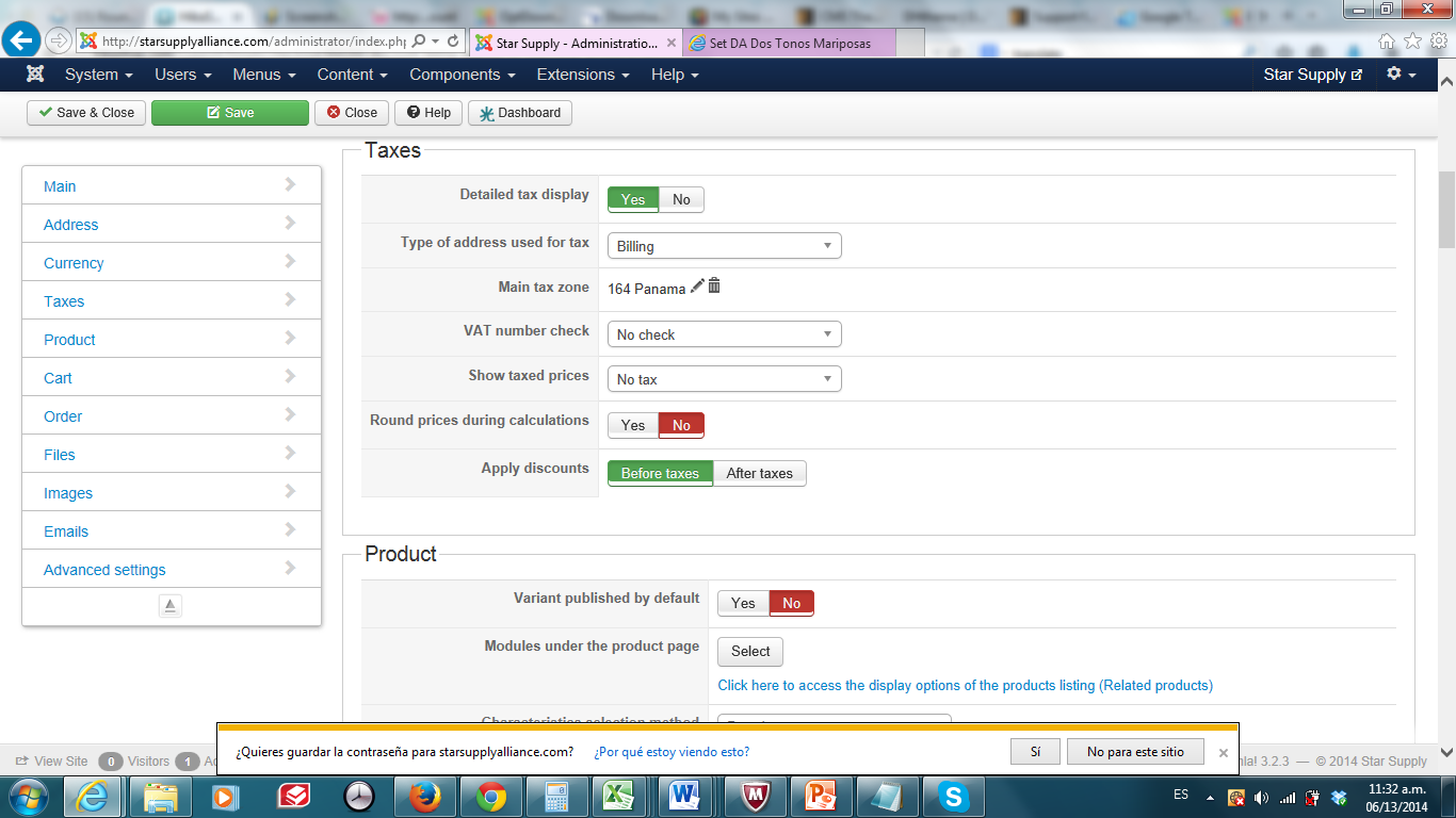

12 years 3 months ago #159881
You have the option "Apply discounts" of the configuration if you want to change that.
  • Posts: 122
12 years 3 months ago #159992
Your responses are normally very clear but I don't understand this one.
I want to change the calculation so that the discount is applied to the pre-tax amount.
Where in the configuration do I set this up?
Thanks,
Mike
  • Posts: 86183
12 years 3 months ago #159997
I don't see where my answer was not clear ?
Toggle the "Apply discounts" option of the configuration and that will do it:
take.ms/bwuZU
  • Posts: 122
12 years 3 months ago #160126
I was looking everywhere bar the obvious place!
As you can see from the first attachment, the tax/discount is set up as you recommended but as you can see from screenshot 2 the discount is being applied on the post tax amount.
Mike
