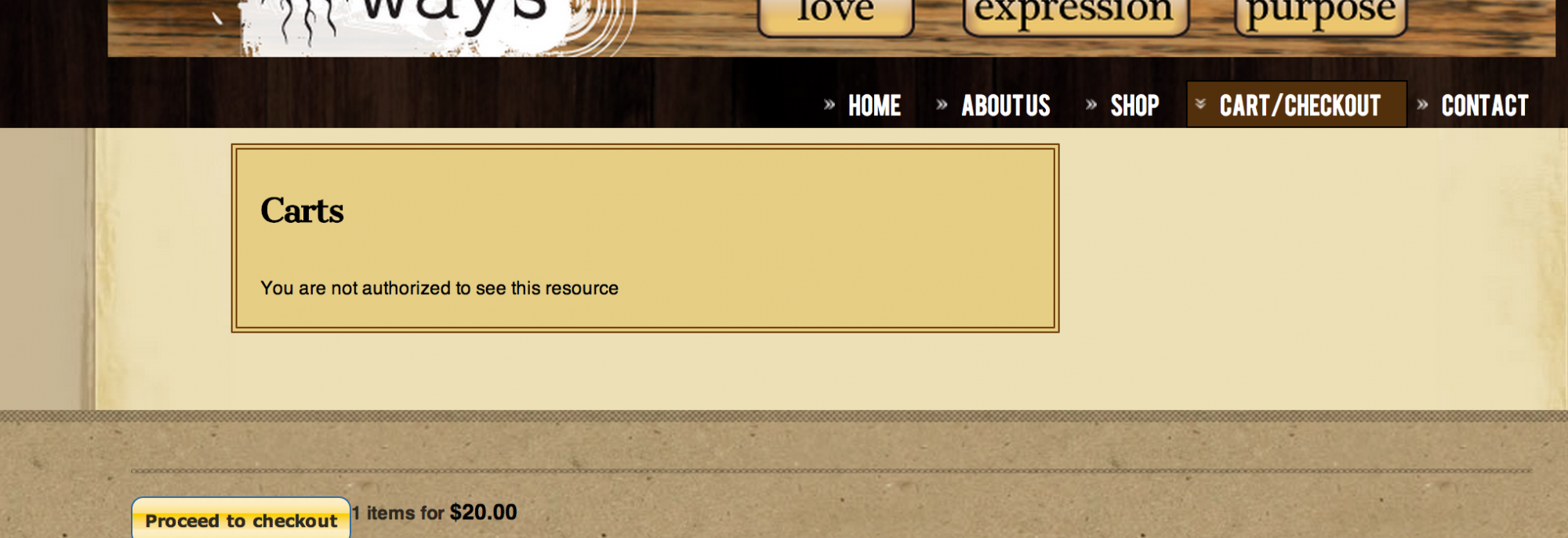

Hello- I am getting the "you are not authorized to see this resource" error when I try to click on my cart. I couldn't follow the post above about the hikashop user control panel link. I want to have guest checkout, but when the guest navigates away from the cart and tries to go back i get that message. I tried to set up a link to the cart from the main menu.

I just tested it and didn't had the "you are not authorized to see this resource" error message.
That's maybe coming from a cache issue so can you disable the Joomla cache, and clear it ? You'll also have to disable it in the joomla config, and unpublish the cache plugin. Also can you clear your browser's cache and try it again ?

Hi- I unpublished the plug in, cleared the Joomla and browser cache. I disabled the cache in Joomla setup. I still get the error when I add an item to the cart, then go to the checkout page, enter info, hit next, then try to navigate back to the cart.

Can you please download HikaShop 2.3.2 via the menu My account>My subscriptions on our website, install it on yours and test again.
That should hopefully avoid the problem.
If nevertheless it still doesn't work, please provide a backend access via our contact form with a link to this thread so that we can check your settings for clues on the problem.

Hello- I have installed 2.3.2 and I still get the message. It works fine up to the step where the customer email and address are entered (step 1?) and after that I get the error.
I have sent backend access via contact form. Thanks for your help.

I have fixed your issue.
The problem was coming from your old view.
You have override the view "cart | showcart" from HikaShop 2.2.2 and there was a session check in that release.
We fixed the problem in HikaShop 2.3.1
www.hikashop.com/support/support/documen...ashop-changelog.html
We improved the checks on the carts and wish lists management
But because you were still using code form HikaShop 2.2.2 for the view, you didn't use the fix that we put in the new views.
So I made some modifications in your showcart view, I fix the problem you got and it should be good now.
But I didn't import the other modification we made in the HikaShop 2.3.2 view ; so some other points we fix/improved might are not in your view.

No you're not missing updates. It is just that because you have a view override to change the look of the page, you are still using your views even if you update HikaShop.
So, if we modify the view code in HikaShop, you will still use your version and some patch we might put in the view, you won't use it.
We are trying to put less PHP code as possible in the views but in your case, it was a test to see if some parts of the cart should be displayed or not (or if some actions buttons are displayed or not).
