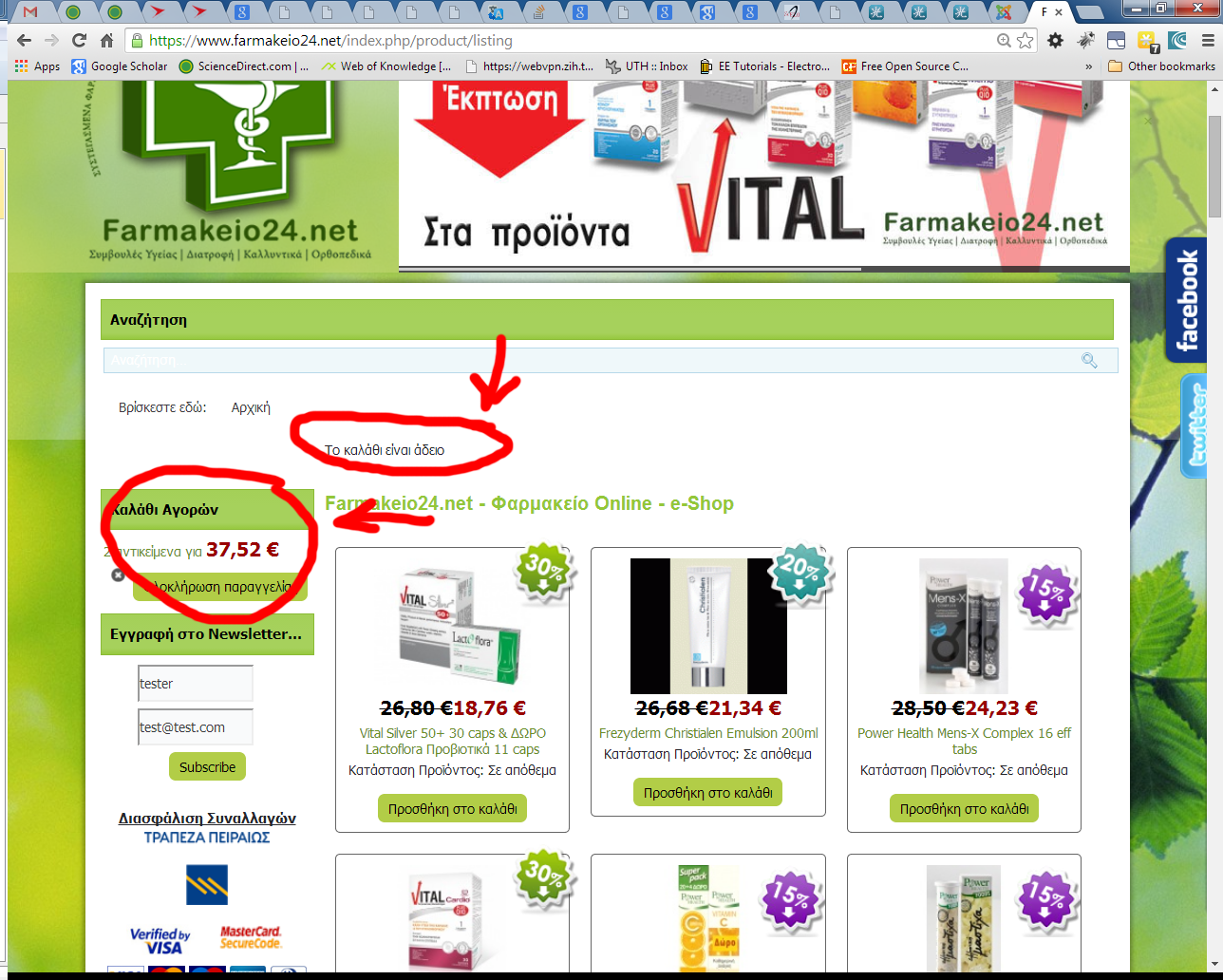

After the update I can't complete the checkout.
When I am at the last step and press complete order button system redirects me to the page: www.farmakeio24.net/index.php/product/listing
Showing the message: "The cart is empty" - although I can still see my products in the cart module on the left column of my site.
Is this a known issue? Do I have to change something in the settings?
I checked the template, and is not a template issue.
Please it is urgent. Customers cannot place orders.

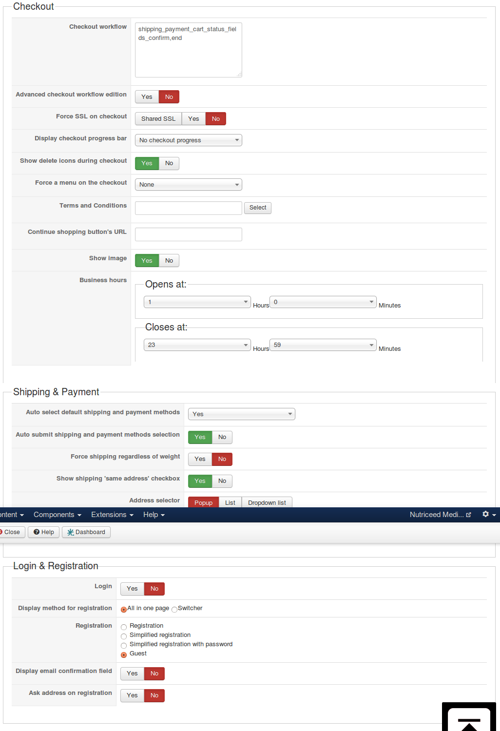

I am having the same problem, My site is also in development phase, I was using the free version and it was working fine, but once i have installed the Hika Shop Essential as i needed the Guest Checkout, it has started giving the problem.
Try adding a product, and the proceed to checkout, It stays on the same page and neither the Finish Button works, nor the Proceed to checkout.
I am attaching my checkout settings.
Please Correct me what i am doing wrong there.

Thanks Nicolas for the reply.
Nope it did'nt fix the issue, it keeps refreshing the page when clicked on Proceed to Checkout.

@miketelles
It's normal that the "proceed to checkout" button keeps you on the checkout since the goal of that button is to go to the checkout.
For the 'Finish' button, it looks like you messed up with the "checkout workflow" option of the configuration. Please restore it to its default configuration as explained in the configuration.

Have put Checkout Workflow to its default state, and things seem OK now. Was not aware I had changed the workflow.
