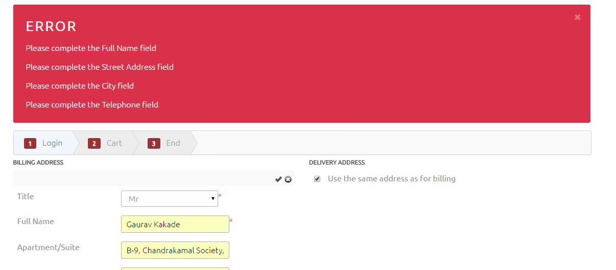

I tried including the checkbox. But when I check 'Use the same address as for billing", then I get the errors even the Billing Address fields are filled up properly. Please see the attached screenshot for the error.
Requesting you to Kindly look into this asap
