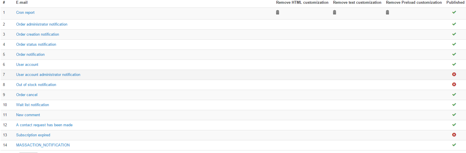

1/ To put some custom code in the "order_creation_notification" preload email ; thanks to that you can cancel the email when the payment method is paypal.
2/ To use the solution explained in the other thread gave by lousyfool ; unpublishing the "order_creation_notification" email and change the "offline" payment to send a confirmation email (and you can also use a different order status like "pending").

Simply disable the "order creation notification" and "order admin notification" emails and you'll receive only the emails after the order is confirmed.
For the cancellation, the customer we'll get an email if you activate the user notification when you change the status, so that should not be a problem.
