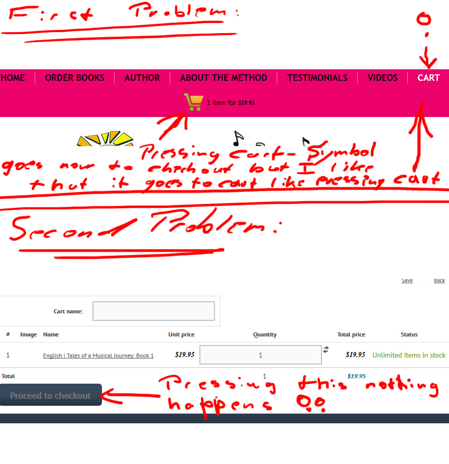

When I go in the cart the button "Proceed to Checkout" will not work.
But my checkout works well - it seemed the button provide the wrong URL!?
If I went to checkout directly it is the URL:
www.gorinpianotales.org/checkout/checkout
But the "Proceed to Chcheckout" button at the cart will link to:
www.gorinpianotales.org/checkout/cart

thanks for your answer, but it didnt help with my problem - I try to explain again:
- Go at the Website www.gorinpianotales.org/ in the TOP MENU to ORDER BOOKS and select any book and presse the Button ADD TO CART on the bottom of that page. To show you my problem you need to have something in the cart!
FIRST PROBLEM:
- Now go again in the TOP MENU and press the right button CART in the menu. At the bottom of the site that comes up you now see another button which was generated by HikaShop and which is called PROCEED TO CHECKOUT - and this button would not work. If you press it just nothing happens. The reason is that this button seemed to link to the wrong page. It goes to www.gorinpianotales.org/checkout/cart which call the website itself again. To work correctly it has to link to www.gorinpianotales.org/checkout/checkout . This seemed to by a bug in HikaShop - please help!
SECOND PROBLEM:
- When you still have something in the cart you also have a GREEN / YELLOW CART SYMBOL in the top of the page (header of the page) under the Top Menu. When you press this cart-symbol it goes directly to the checkout - but that makes not really sense because my opinion is that it has to go to the cart. Now it goes to www.gorinpianotales.org/checkout/checkout . But it would be more logical it would go to www.gorinpianotales.org/checkout because this show the cart and you have the optional button to PROCEED TO CHECKOUT (that actual wont work - see FIRST PROBLEM). Behind the cart-symbol simply works the cart-module of Hikah-Shop.
Where can I change this?
Thanks again for your time and help!
All the best, Frank

I changed the alias as you said - but the "Proceed to checkout" button is still without any function .
So that wasn't the solution!!! Any idea? I am sure it is a bug in Hikashop...

Also 2. wasnt the right solution: I changed "product / cart" as you said - but this was total nonsens: Now if you click on the yellow/green-cart-symbol you see the things in the cart (that is OK!) but there is no possibility to "proceed to checkout". There is now a button called "Convert to wishlist" - but I dont like to have functions like wishlists.
I just like to have a very simple normal shop: Just click on the Menu cart, go to the cart and have the possibility to "proceed to checkout" (that doesnt work!!). And if you click onto the cart-symbol just do the same... no wishlist, no cart-names and no other things - just a very simple standard-shop without any features.... but seemed to be more complicate as I thought...

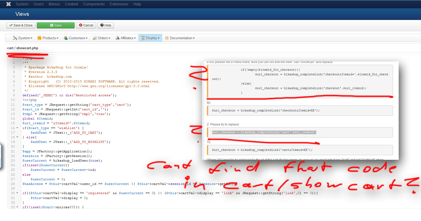

You said: If not, please set a menu there, else you can too edit the view "cart / showcart" and replace ...
Sorry - I simply cant find that code you wrote in the "cart / showcart.php"? (look at the screenshot). I searched the whole file with Notepadd++ !?!?!

11 years 7 months ago #190348
I have edited the view "cart / showcart" and "product / cart" now it is working as expected, but there is strange comportment with the urls on your website, for example when a product has the alias "cart" so the link become "/cart/cart", it double the alias.
This is maybe due to a third component you have installed.
The following user(s) said Thank You: bittrapper
