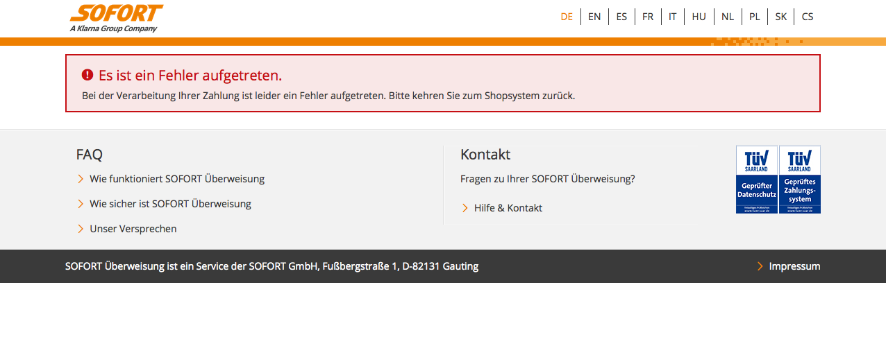

I updated Hika Shop and changed to Protostar and at least I got redirected to Sofort with an error now. ( screen )

Regarding the Sofort error message :
An error occurred
Unfortunately, an error occured when processing your payment. Please return to the shop system.
You should probably directly ask them about that issue to have more information about it.

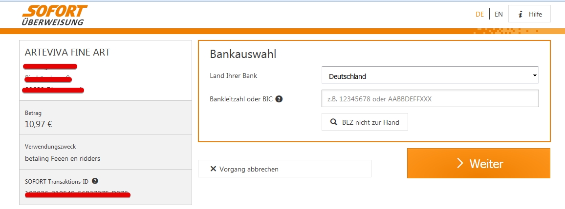

Great, Thanks. At least I am getting redirected and will spend further hours trying to clear that problem with sofort.de.

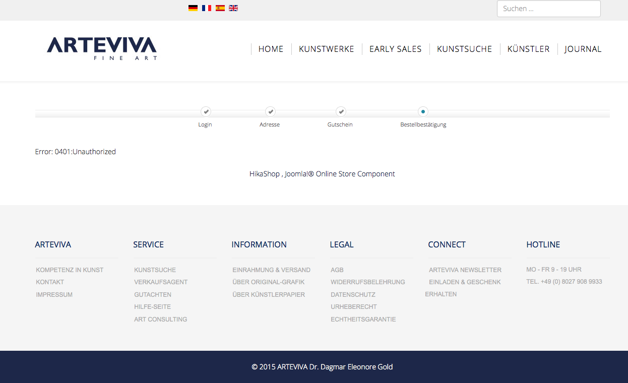

Ok, i am back after roughly 2 hours with sofort.de support. We tried adding new projects but all boiled down to a:
Error: 0401:Unauthorized
Can LG solutions help and where can I contact them?

Also, note that I tested it with your credentials on my end, and it worked fine, I was correctly redirected to the payment platform.

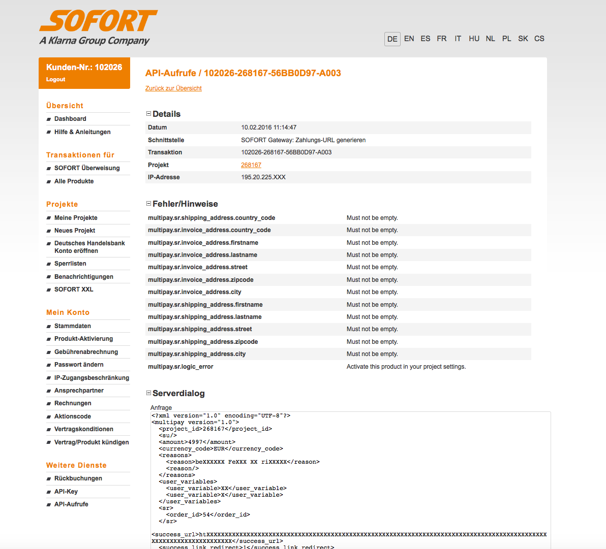

And to update again.
Another hour with sofort and the technician said I am their second customer that could not get sofort.de payment to run with Hika shop.
At least he found out that the plugin was giving theses errors shown in the screen and to ask Hika Shop why the Plugin is asking for this data.
Wolfram
and the error xml

10 years 7 months ago #229572
That Hikashop Sofort Payment plugin is only using their Library, so these error are launched either by their Library or by their API.
In your case the best solution will probably be to directly ask more advice from the person who created that plugin or from Sofort.

Regarding your "Must not be empty" errors, you should probably test it by adding through the "sofort.php" file, these lines :
if(isset($order->cart->billing_address))
			$Sofort->setSofortlastschriftAddress($order->cart->billing_address->address_firstname, $order->cart->billing_address->address_lastname, $order->cart->billing_address->address_street, '', $order->cart->billing_address->address_post_code, $order->cart->billing_address->address_city, $order->cart->billing_address->address_title, $order->cart->billing_address->address_country->zone_code_2);
just after this line :
$Sofort->setNotificationUrl($notify_url);
3.
Regarding the "Activate this product" error message, you should maybe ask it to Sofort.
