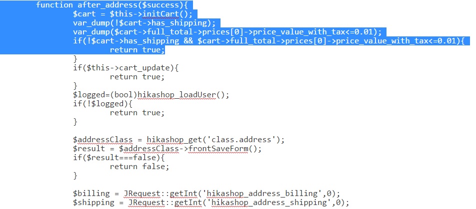

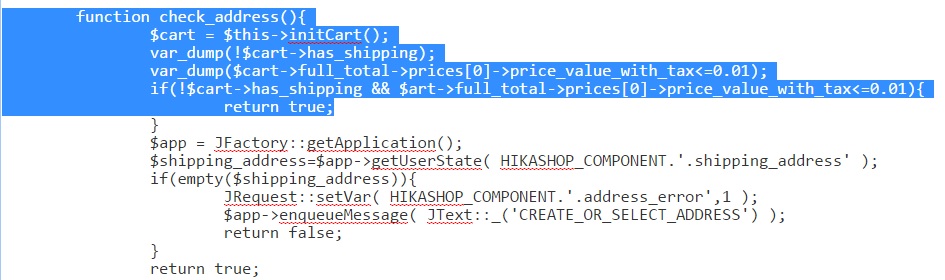

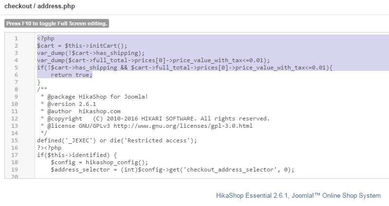

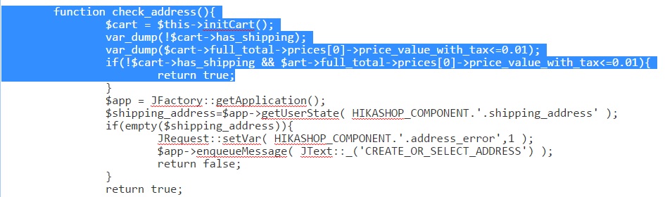

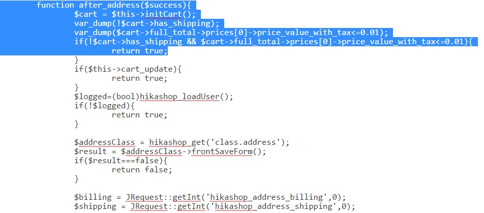

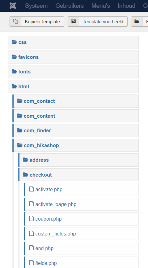

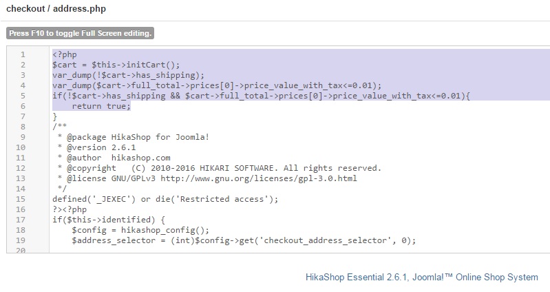

The code as you advised has been inserted as shown in Image001, Image002 and Image003.

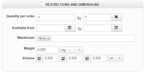

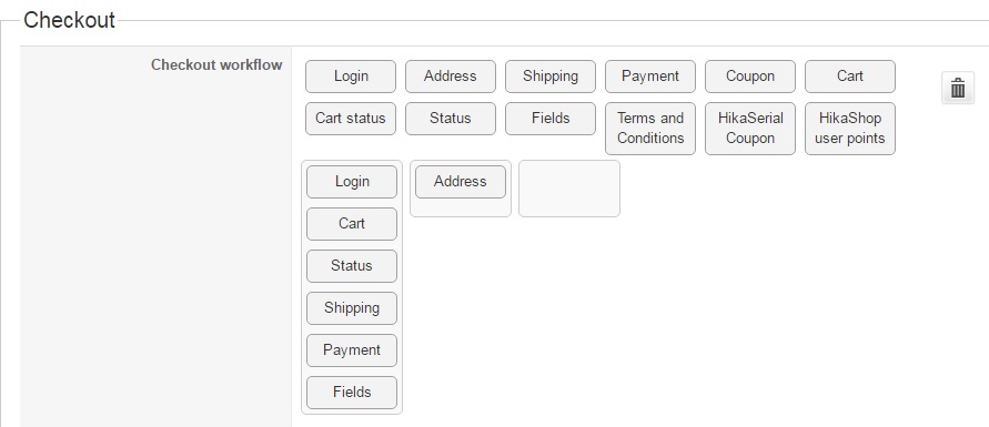

The configuration settings for product (to ensure no weight) as shown in Image004.

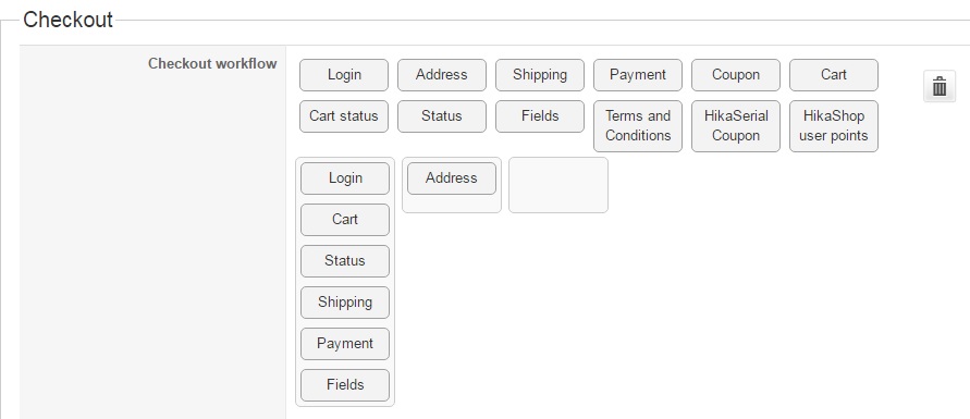

Checkout workflow as shown in Image005.

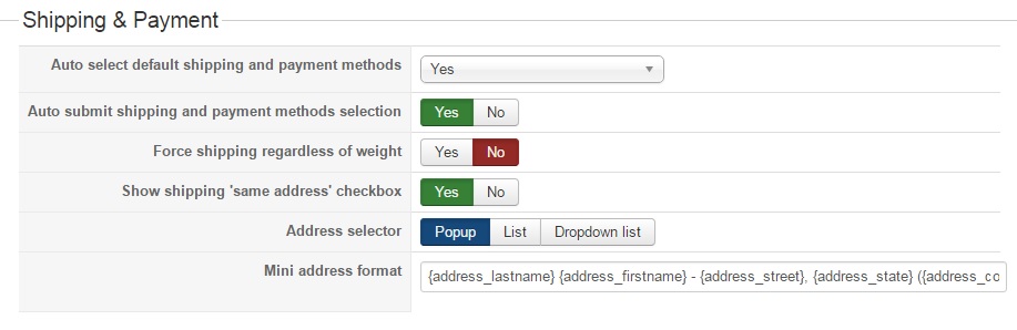

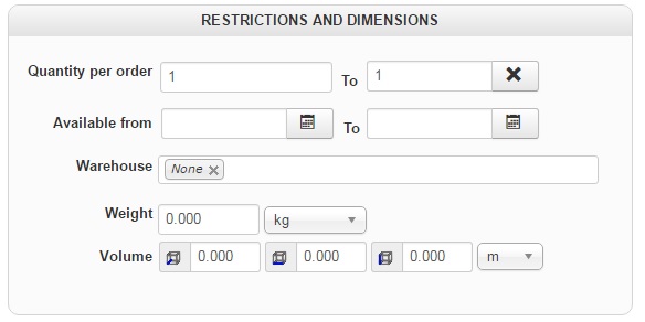

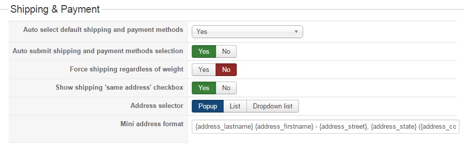

The configuration settings for cart (force shipping regardless of weight) set to false as shown in Image006.

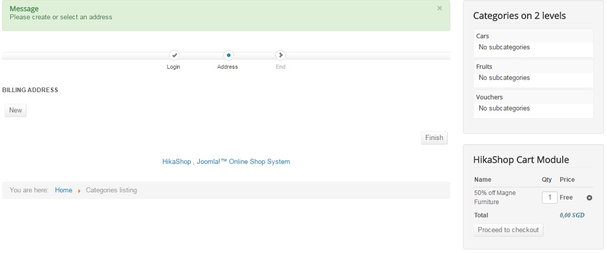

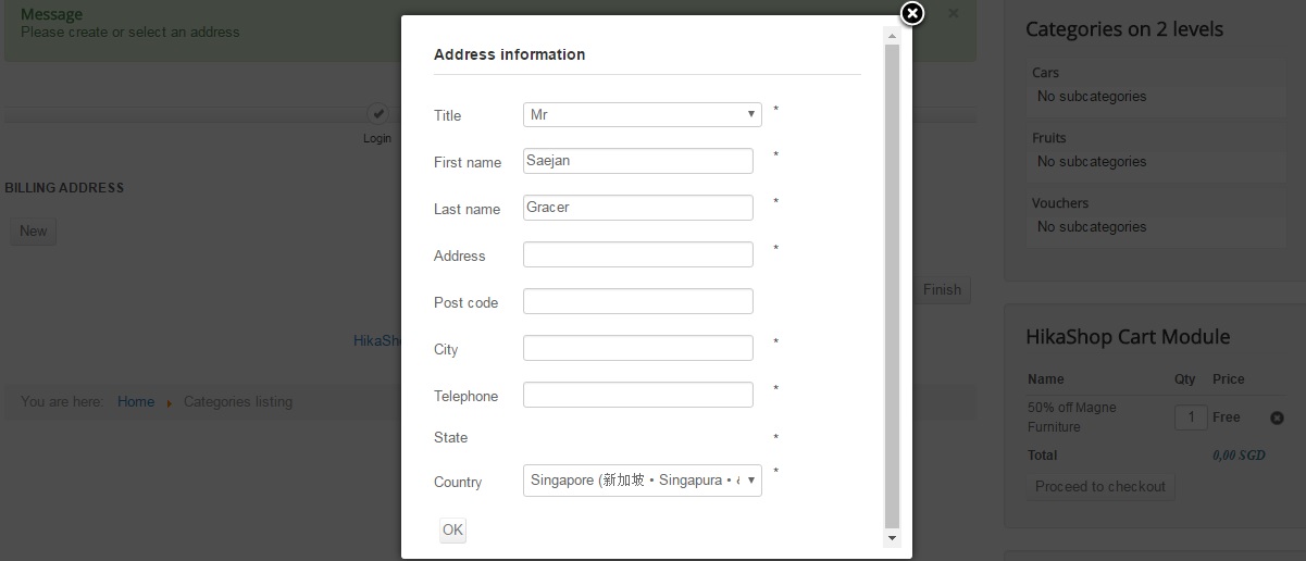

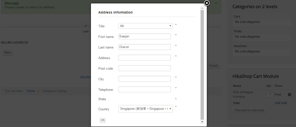

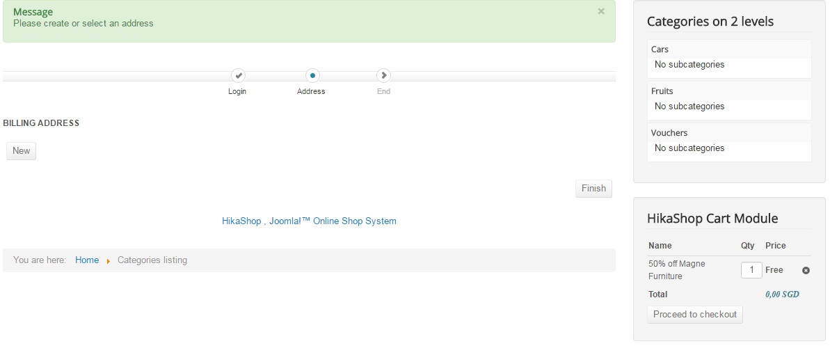

The address request still pops up for the item that is free (no price) and virtual (no weight) as shown in Image007.
But the address entry is not arbitrary because I can proceed to place my order by closing the address entry pop up as shown in Image008.
The thing is, as the voucher is free and virtual, and the only important thing for the customer to retain is the unique serial code, I don't want the address entry request to pop up at all, whether for billing (nothing to bill as it's free) or shipping (nowhere to ship as it's virtual) address. What do I have to do to achieve that effect? Billing and shipping address entry should STILL pop up for any product that is not free or not virtual.

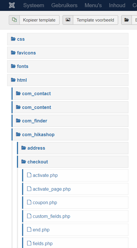

The var_dumps should display at least on the address view of the checkout.
Are you sure that you edited the address view file for your frontend template and not another template ?
Please also note that we're far from user support. As I said, there is no option to do that by default with HikaShop. We've given hints to do what you want with custom code but if you're not a developer, the best is to ask one to do that for you as it require proper debugging and testing and we can't spend ourselves several hours on custom coding each time someone needs something not possible by default. You can contact our partners if necessary:

10 years 2 months ago #240922
Hi nicolas,
Sorry for the confusion, yes you are right, the PHP code was added to the wrong template. Have rectified it!
Added output buffering to remove the bool(true) bool(true) output too:
$cart = $this->initCart();
ob_start();
var_dump(!$cart->has_shipping);
var_dump($cart->full_total->prices[0]->price_value_with_tax<=0.01);
ob_end_clean();
if(!$cart->has_shipping && $cart->full_total->prices[0]->price_value_with_tax<=0.01){
return true;
Thank you =)
