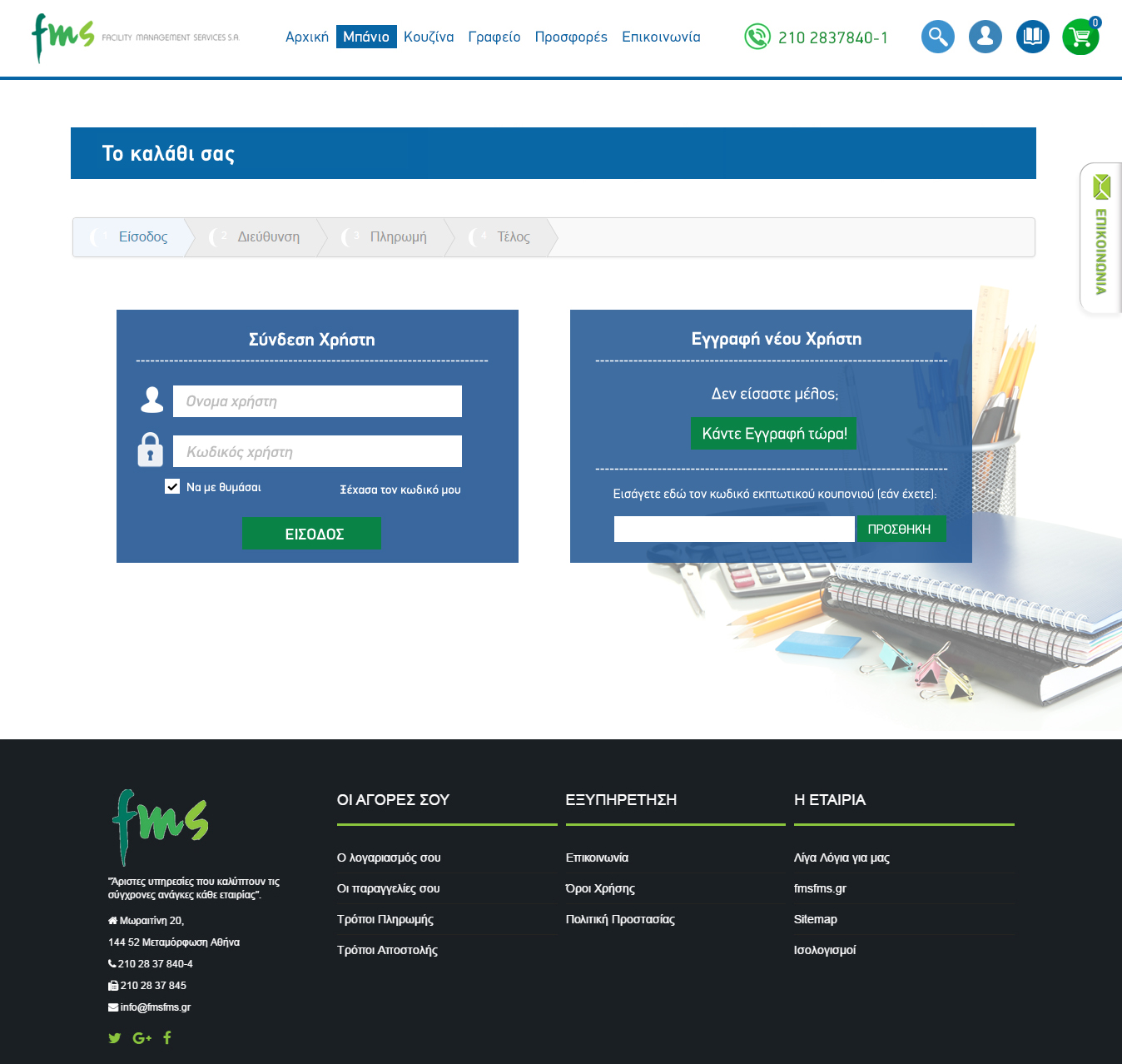

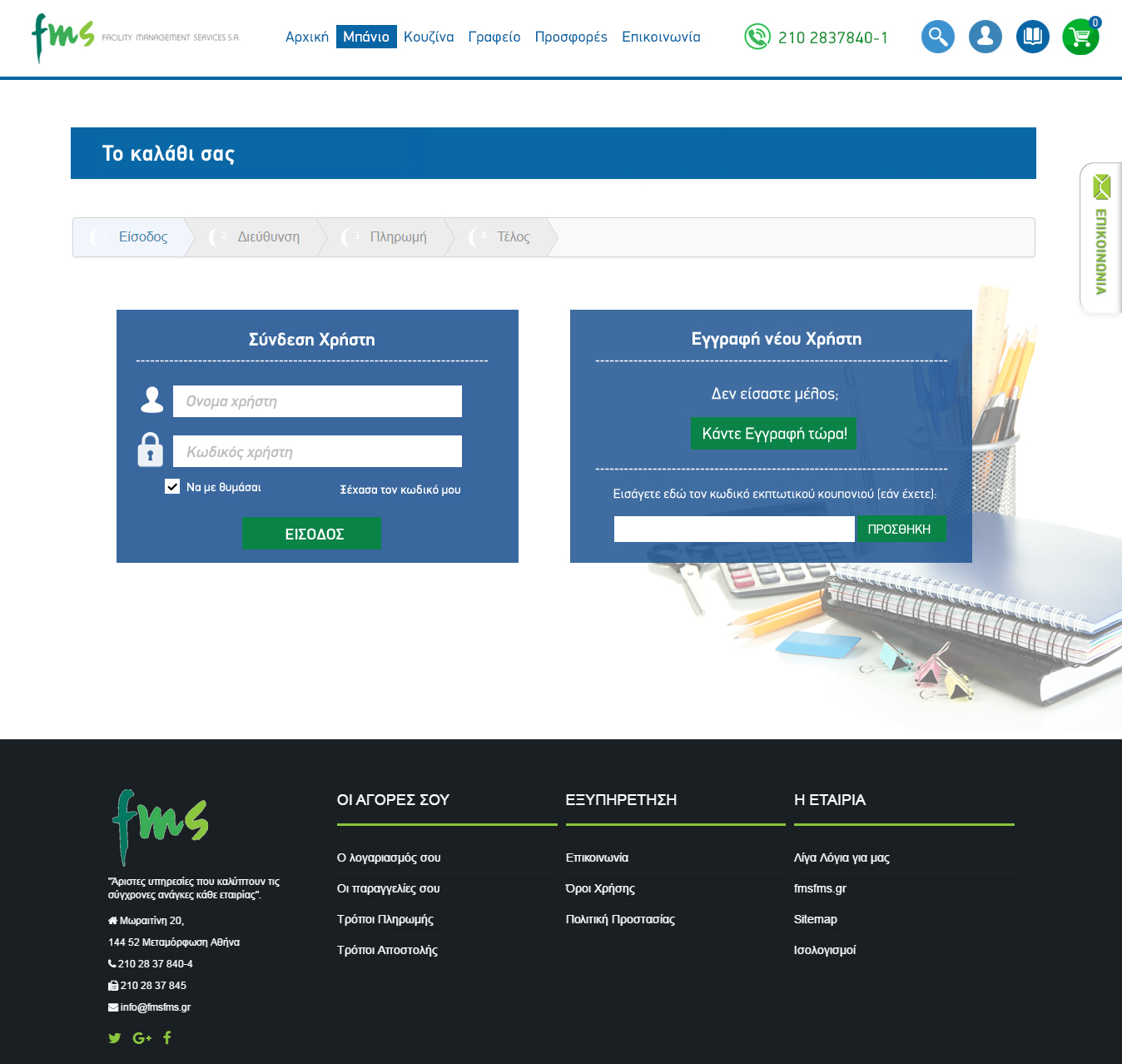

Hello!
May i ask, could i move the checkout wizardbar under the h1?
(see screenshot)
Thank you!

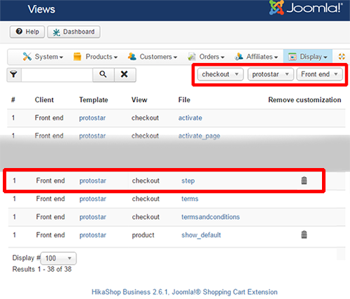

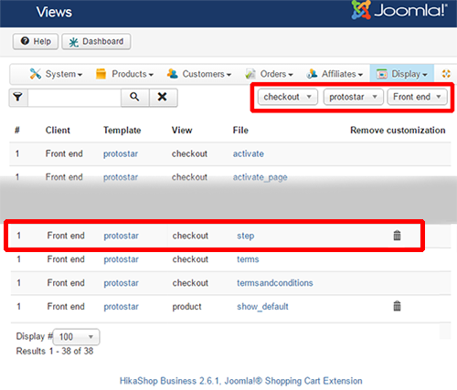

Are you sure you editing the right view ?
In Components => HikaShop => Configuration, and in Display dropdown listing Views you must use these three filters dropdown like on this screenshot on below :
Use these criteria, just adapt your template to your front end template.
Because if you edit, directly your view and have an view override, you won't find your <h1> (which I suspect come from an override)
Hope this will help you.
Regards.

The H1 is displayed by your template.
The checkout bar is displayed by the HikaShop view.
You can't swap them unless you perform big modification in your template and in HikaShop.
