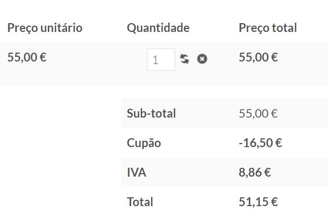

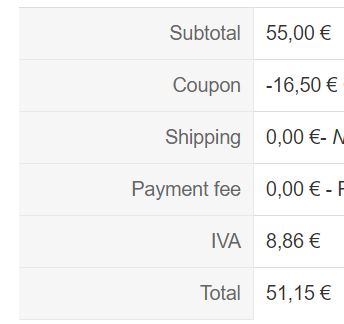

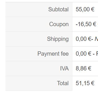

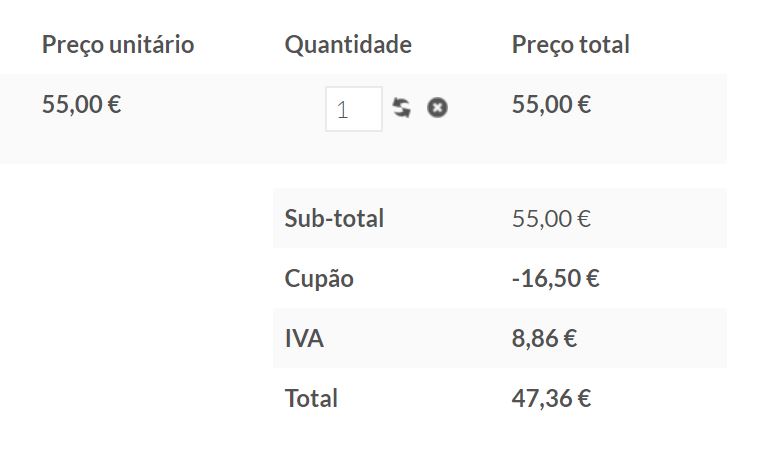

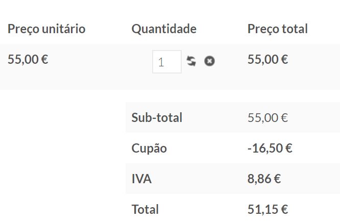

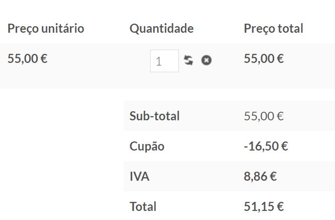

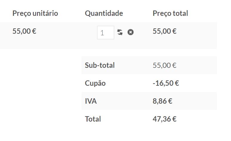

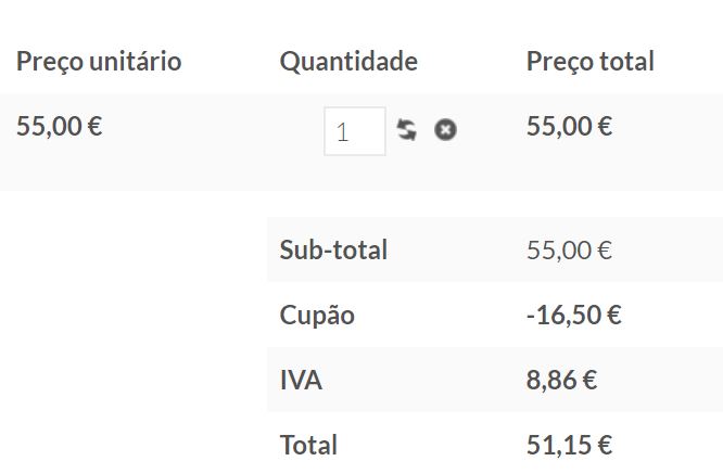

A customer gets a 30% discount coupon on a product that costs €55.
How can we calculate the right price?
Right price:
* Price: 55
* Coupon: 16,5
* Price before taxes: 38,5
* VAT (23%): 8.86
* Final price 47.36
And this is how HS is calculating the price (see attachment).

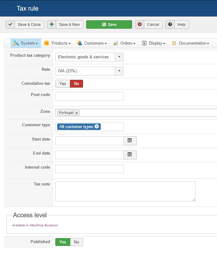

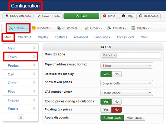

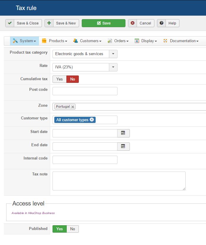

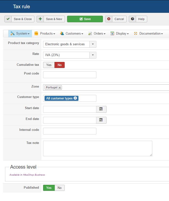

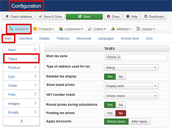

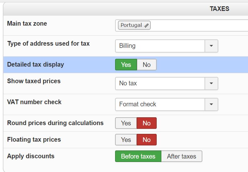

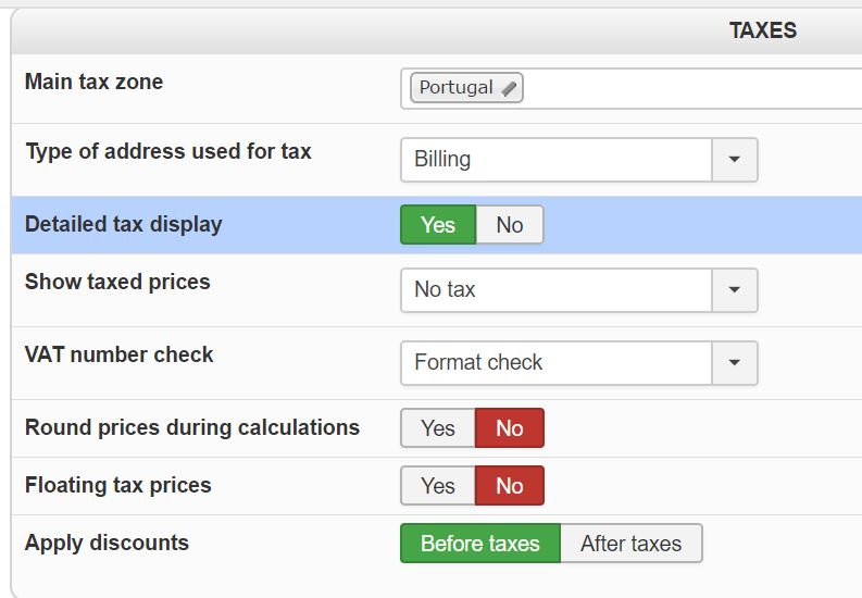

9 years 3 months ago #272285
Can you provide a screenshot of your taxes configuration please (in Component => Configuration => HikaShop, Main tab & Taxes part), AND other elements that can explain us better the situation.
Awaiting news from you.
Last edit: 9 years 3 months ago by Philip.
The topic has been locked.
  • Posts: 111
9 years 3 months ago #272290
Yes, have a look at the attachments.
Than
ks!

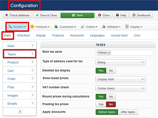

9 years 3 months ago #272318
Hello again,
Sorry but I need this :
Like I precised in my previous post :
"in Component => Configuration => HikaShop, Main tab & Taxes part"

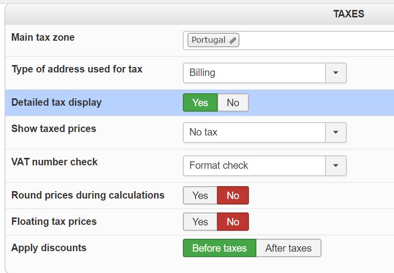

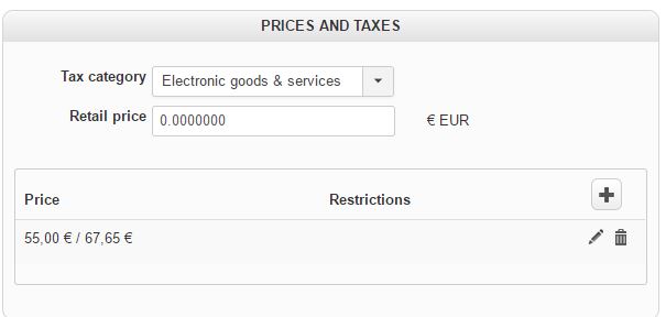

  • Posts: 111
9 years 3 months ago #272359
Here it is:

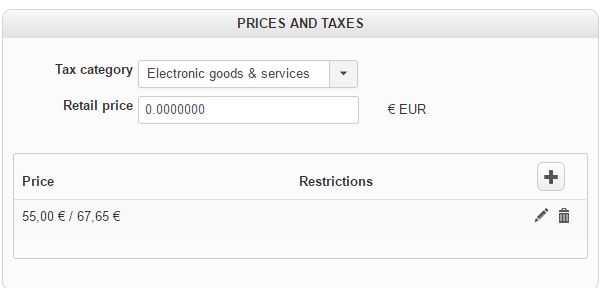

9 years 3 months ago #272381
I try to reproduce your result with a product price without taxe 55.00 Euro and 67.65 with taxe (23%) and a coupon of 30%, and impossible to get your results with your configuration, so we forget something...
Can you provide an Url link to your website AND a frontend/backend access in order to process some tests ?

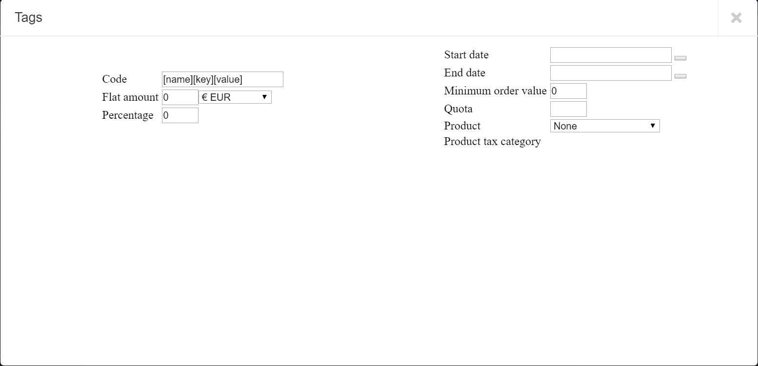

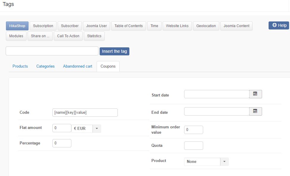

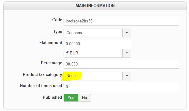

  • Posts: 111
9 years 3 months ago #272393

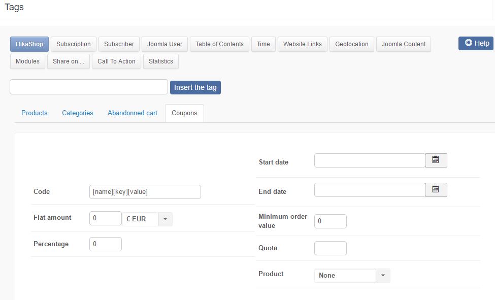

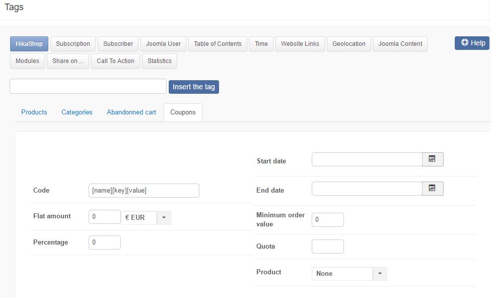

Yes, I know what the problem is:
The coupon is generated by a tag in Acymailing:
That results in a code like this:
{hikashop_coupon:30|1||2017-09-30 23:59|30|0|1|[name][key][value]|}
BUT, the coupon code has no Product Tax Category:
So you have to add that in the tag generator.

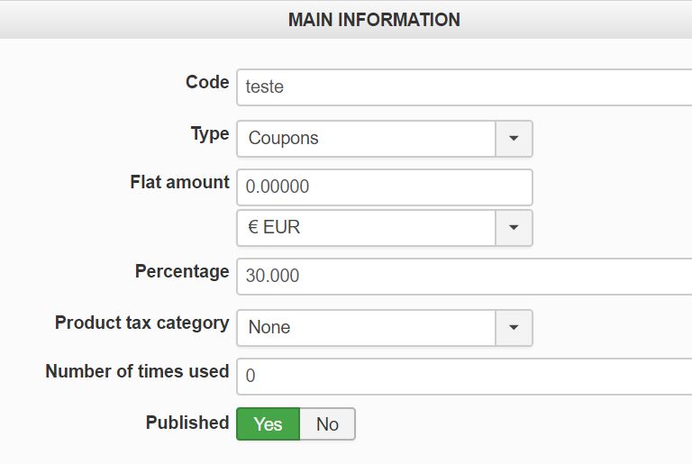

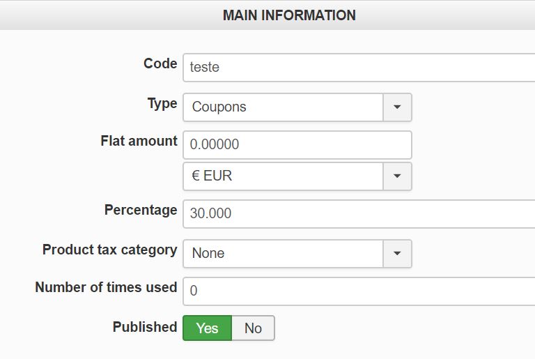

9 years 3 months ago #272403

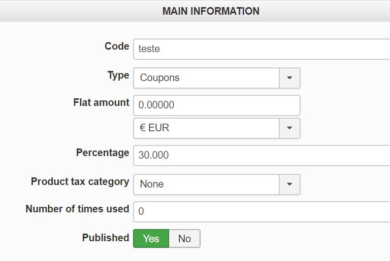

Can you try to create (via manual classic way) a coupon with same criteria in order to see if your coupon leads different results from the one created via Acymailing tag.
The point is to see if the issue (strange results in your checkout cart) come from Acymailing coupon creation OR something in your HikaShop configuration.

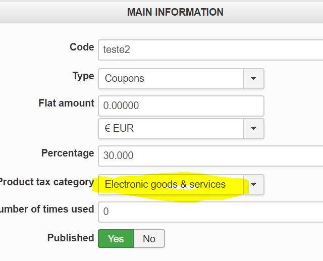

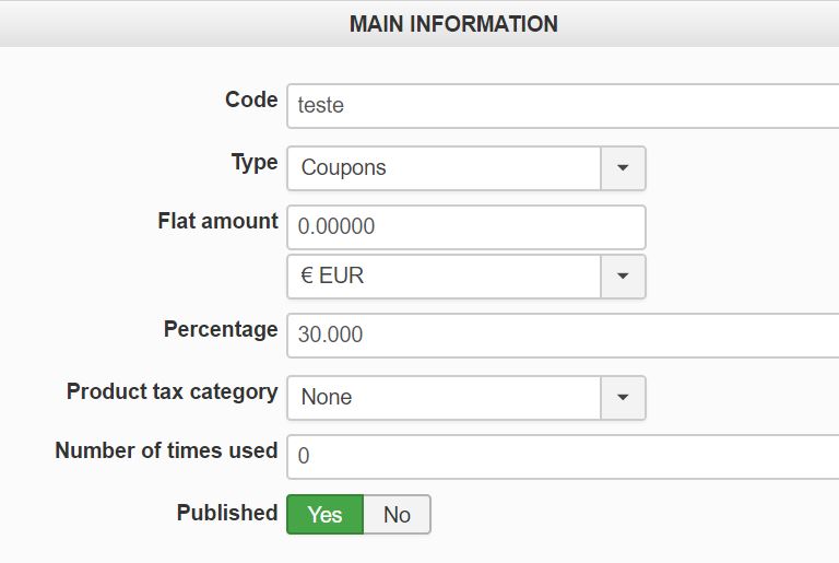

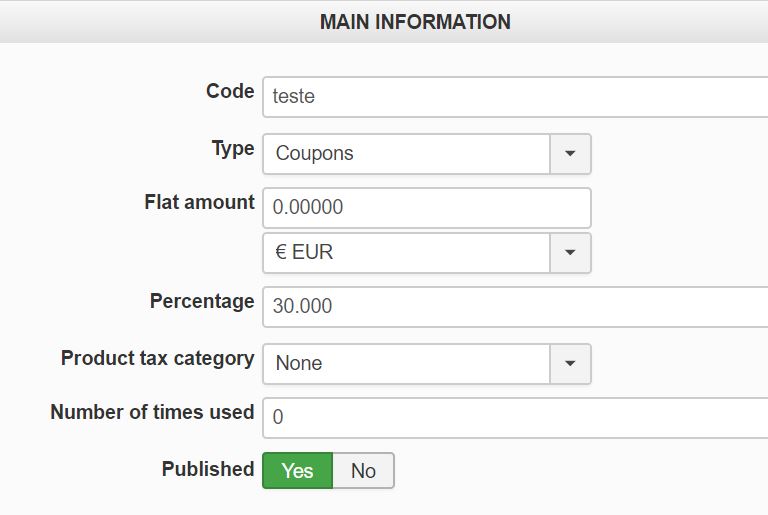

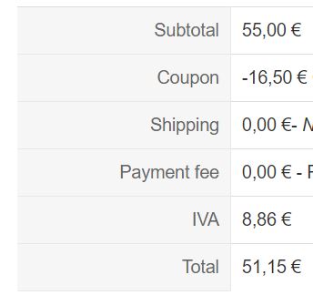

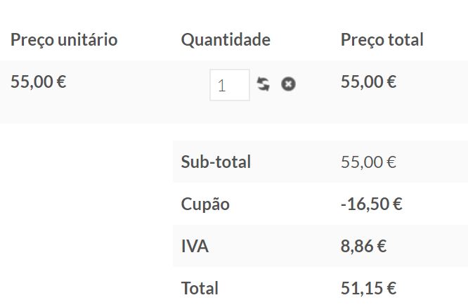

  • Posts: 111
9 years 3 months ago #272471
Yes, same configurations get the same results:

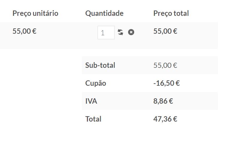

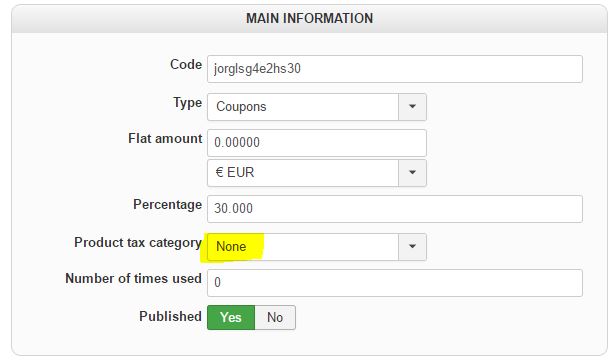

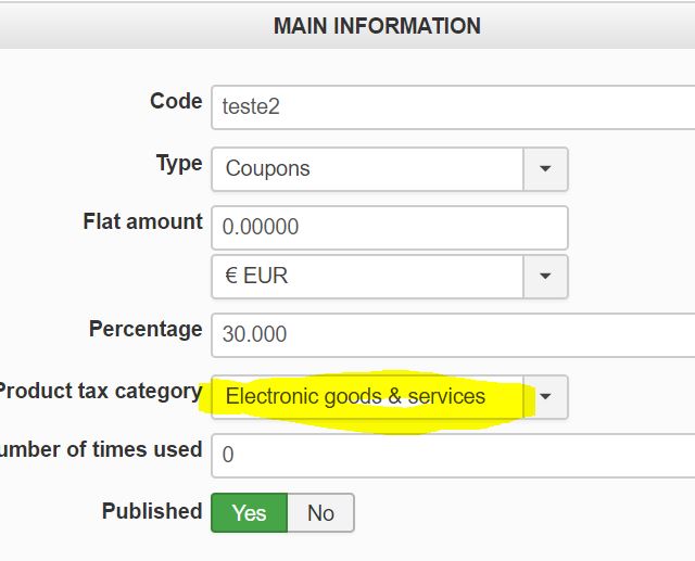

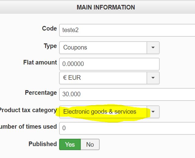

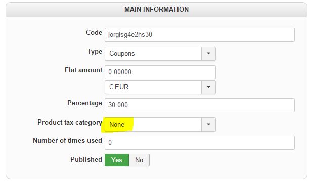

  • Posts: 111
9 years 3 months ago #272473
However, when the product tax category is defined, the price is correct:

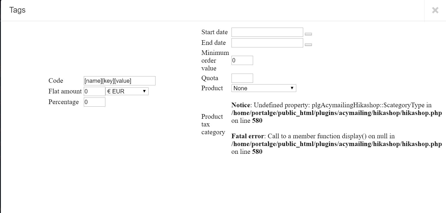

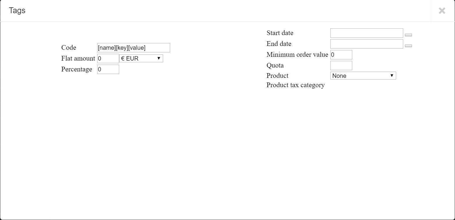

  • Posts: 111
9 years 3 months ago #272642

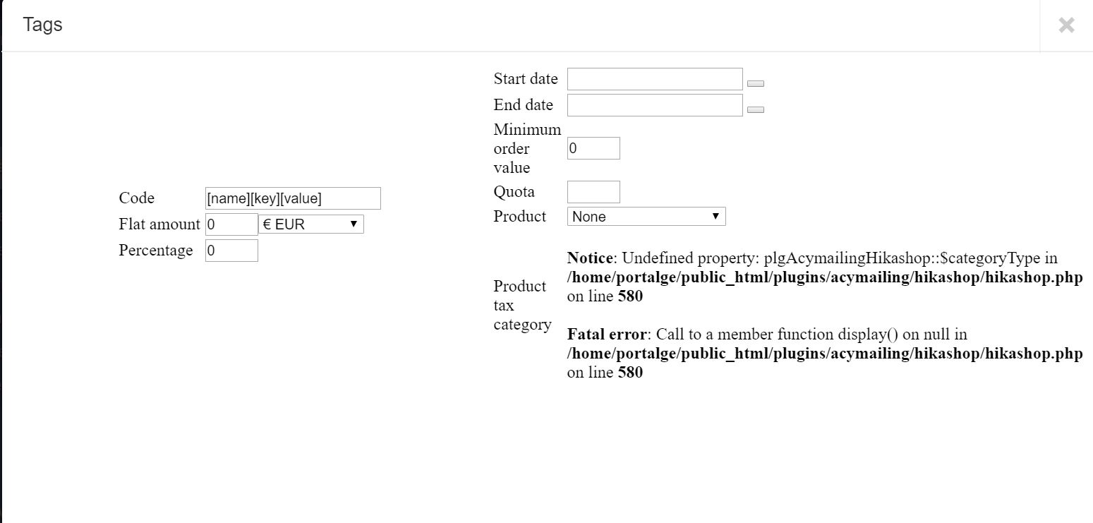

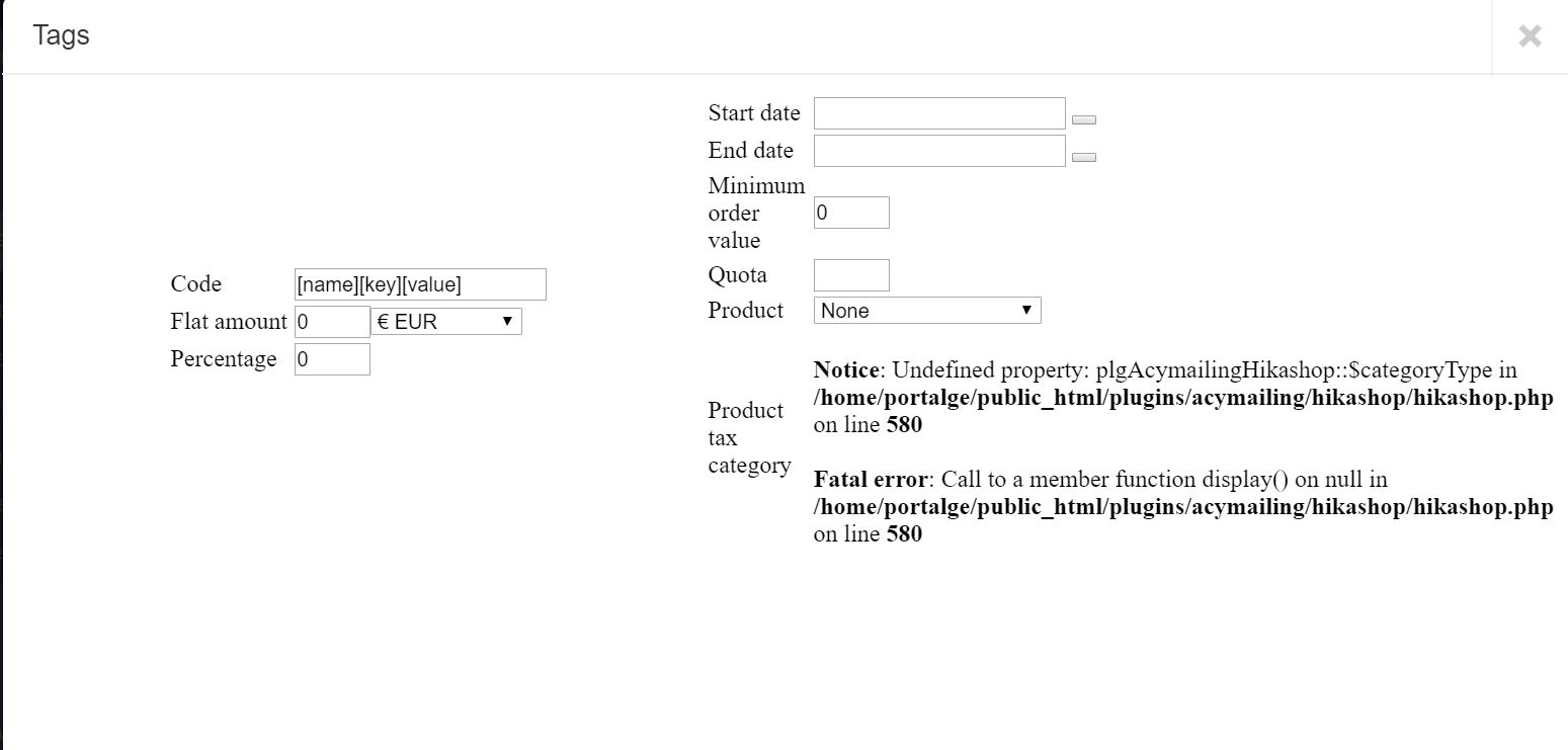

Proceeded accordingly, but the coupon tag in Acymailing interface seems to be broken...
  • Posts: 86216
  • Thank you received: 14222
9 years 3 months ago #272656
There seems to be an error with the modification Philippe added in the plugin.
Unfortunately, I don't have the modifications on my end as we're on the weekend.
Could you try again with the "error reporting" setting of the Joomla configuration activated ?
That will display an error message you can provide which will allow Philippe to easily fix the issue on monday.
  • Posts: 111
9 years 3 months ago #272667
Here it is:
9 years 2 months ago #272727
Sorry for the delay, I analyse the code and I think I get the root issue, can you go to your plugin code in YourWebsite\plugins\acymailing\hikashop, and replace this around line 580 :
echo $this->categoryType->display('', '', 'onchange="updateTag();"', true, 'tax_id');
For this :
echo $categoryType->display('', '', 'onchange="updateTag();"', true, 'tax_id');
Hope this will solve your issue, and awaiting news from you.
Last edit: 9 years 2 months ago by Philip.

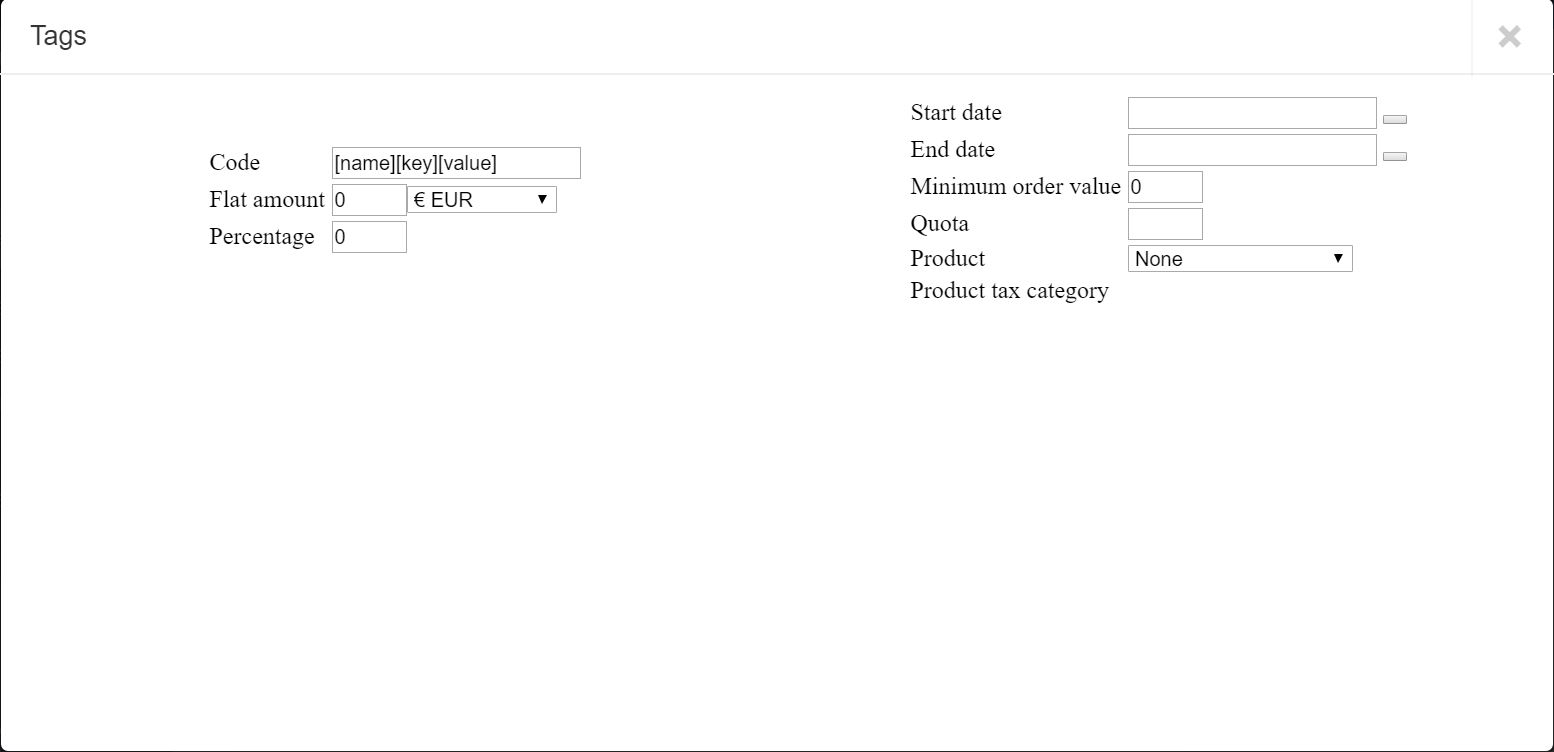

  • Posts: 111
9 years 2 months ago #272729
The product tax category is now displayed, but the coupon is invalid!
  • Posts: 86216
9 years 2 months ago #272746
I've checked on my end but the modifications of Philippe properly generate coupons with their tax category selected now.
Did you recreate your coupon tag in the newsletter ? There is an extra parameter that is necessary in order to select the tax category and you need to select it if you want it to be selected in the coupons that are generated.
