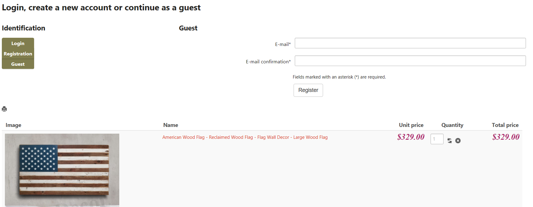

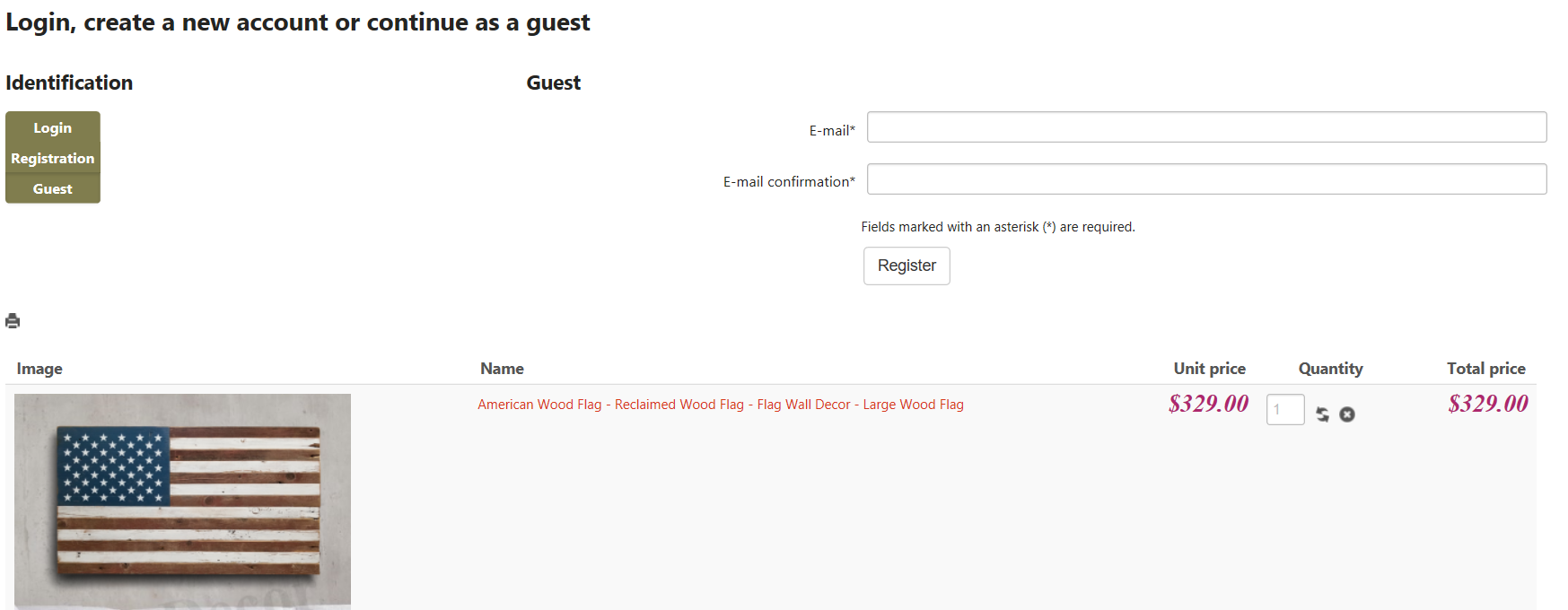

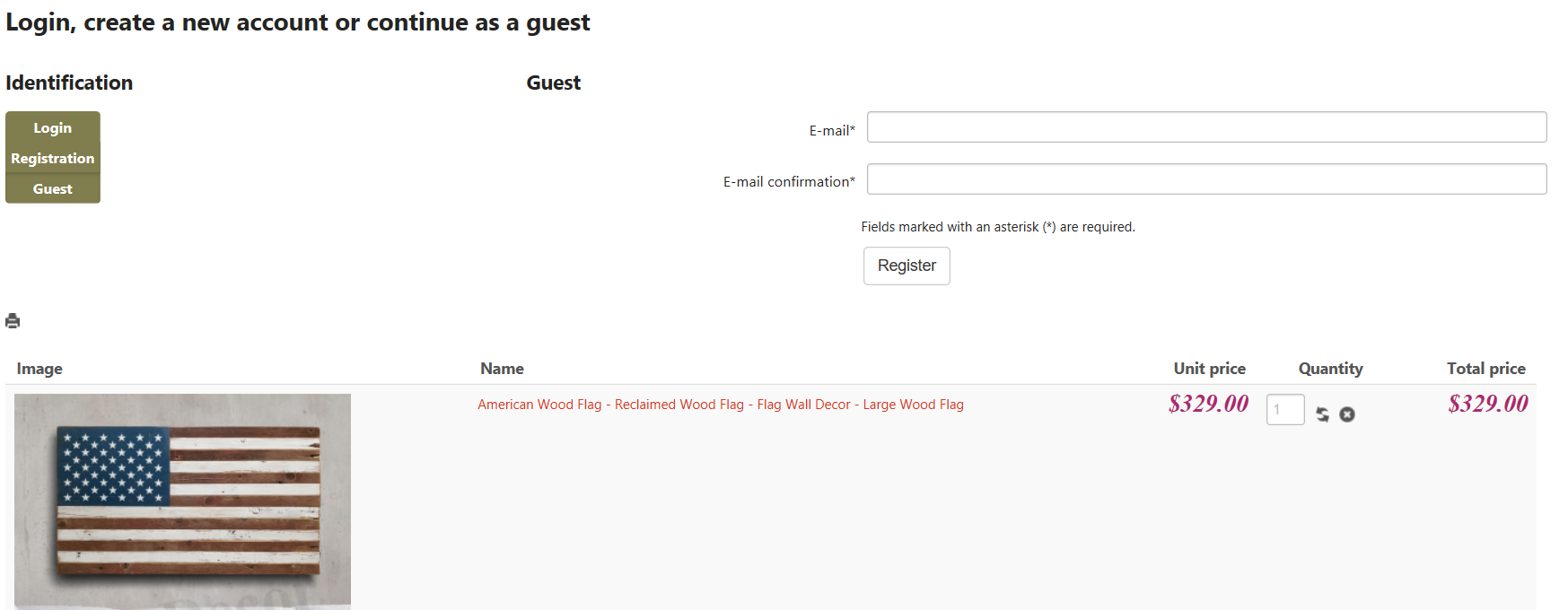

I am using Hikashop Business newest update.
If I turn Checkout Legacy to Yes Recaptcha does not show but the Item in cart at checkout does.
If I turn Checkout Legacy to No The on Checkout the Recaptcha I am not a robot shows but the product in the cart do not show.
I downloaded the hikashop recaptcha as well.
How can I get both recaptcha and the products to show under in list together?
Thank you,
Charles

7 years 8 months ago #302848
The only poroblem I am having is that when checkout legacy is turned off, the recapcha fails to show. Ohterwise it is looking nice.

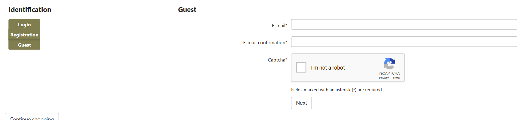

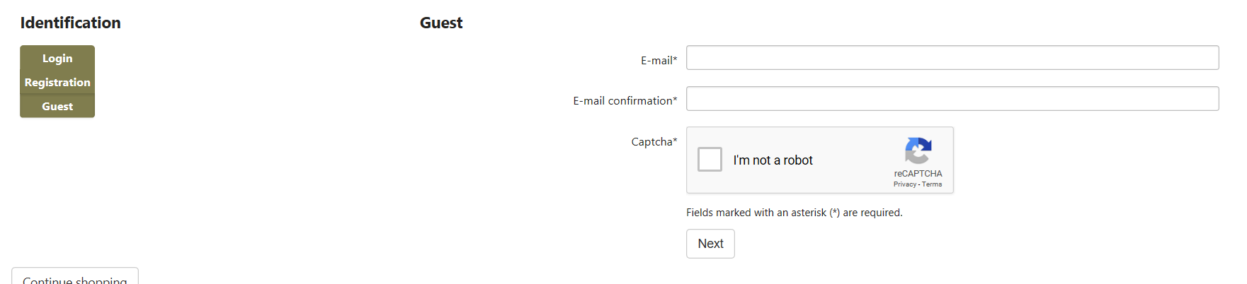

7 years 7 months ago #302977
I downloaded the same recaptcha just now from same link suggested above. However, it does not show under checkout legacy turned off. However, I just discovered that on checkout if you select 'Registration' it appears.
It does not show for guest or login. Maybe log in it shouldn't. However, I think it should for guest where it ask for name and email. It does show for guest when Legacy is on.
In Hikashop Recaptha V2 plug in, I tried access public and guest as well, but no show under guest checkout.
So I did figure something out. If I put for Captcha after Email then it shows for guest. So because guest did not have password, it must not think it needed it.
Last edit: 7 years 7 months ago by fan4chevy.
  • Posts: 86216
  • Thank you received: 14222
7 years 7 months ago #303010
That's indeed the case. If you configure your recaptcha plugin to display after the password, since guests don't have a password field, then it doesn't display it.
