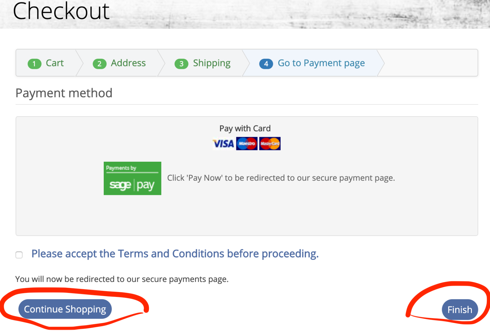

Hi I have two questions relating to the checkout process.
1, How can I change the final button "Finish" in the Checkout process to read "Pay Now"?
2, How do I remove the "Continue Shopping" button from the last page of the checkout process?

You'll just have to change the value of the "CHECKOUT_BUTTON_FINISH" translation key via "Hikashop->System->Configuation->Languages" as explained on our documentation :
www.hikashop.com/download/languages

1. You'll just have to unset the value of the "Continue shopping button's URL" option via "Hikashop->System->Configuration->Checkout".

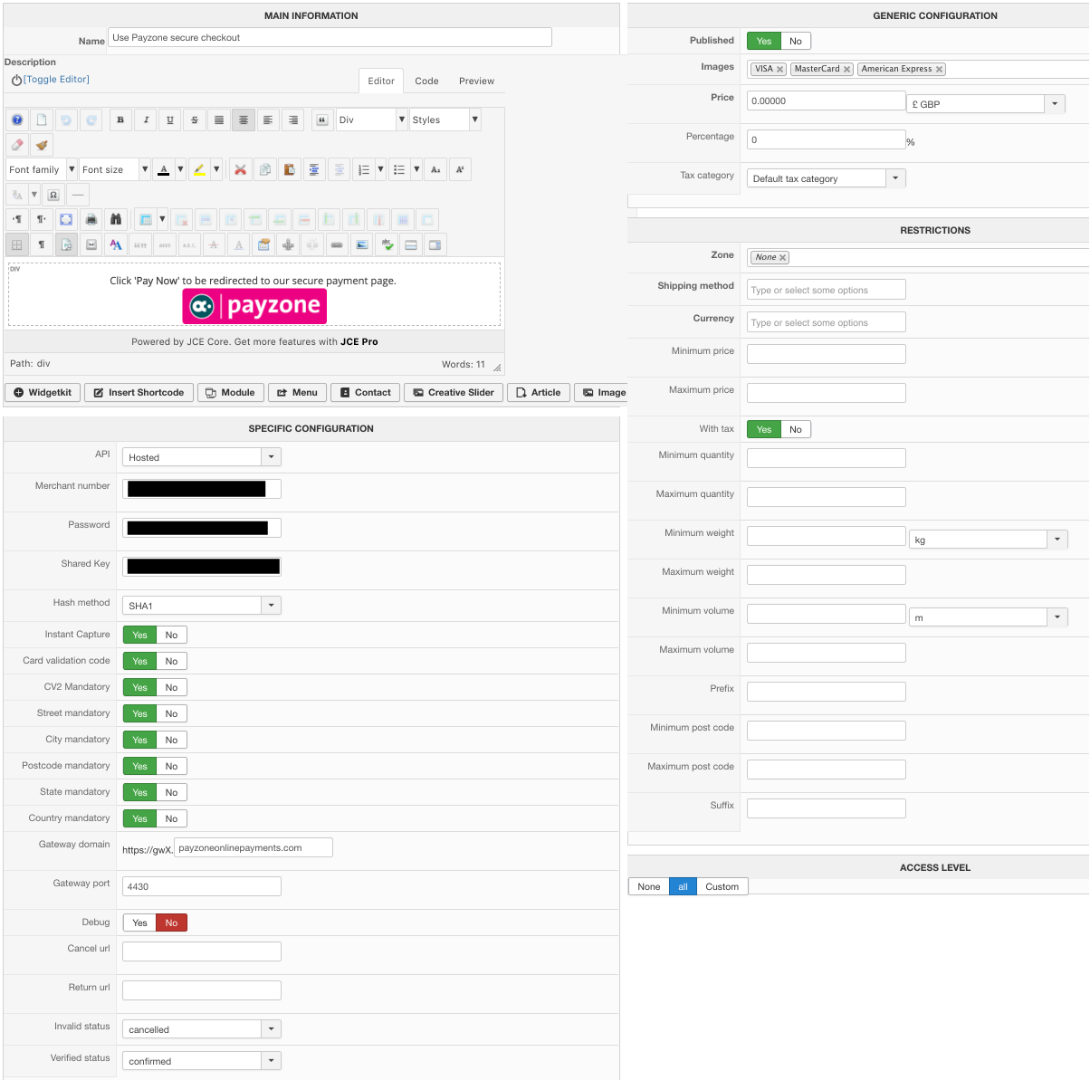

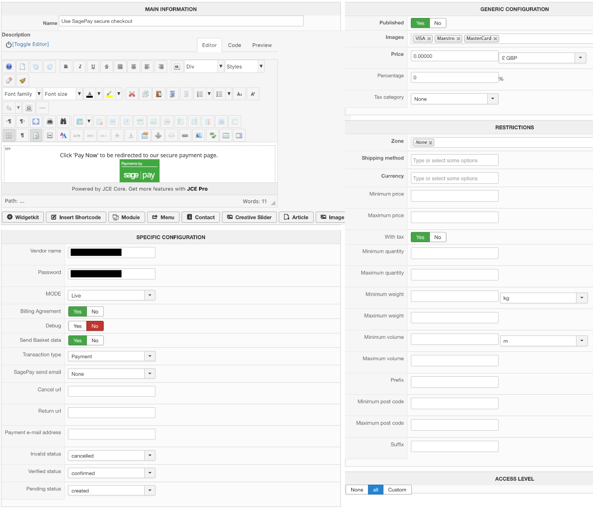

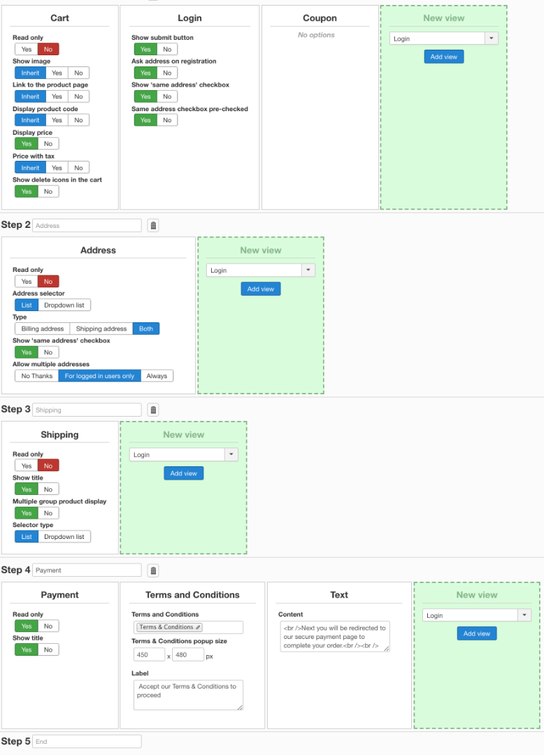

In that case, can you give us more information through some screenshots of your :
- Payment methods via "Hikashop->System->Payment Methods"
- Checkout workflow via "Hikashop->System->Configuration->Checkout"
So that we can directly test it on our end ? Thank you.

7 years 2 months ago #310784
by spotstv
Replied by spotstv on topic Change text of Finish button in checkout
7 years 2 months ago #310792
by nicolas
Replied by nicolas on topic Change text of Finish button in checkout
You have the "read only" setting of your payment view activated. So in that case, the view will only display the currently selected payment method and won't allow you to change it.
That's why you only see one of them and if you disable it, it automatically selects the second one.
