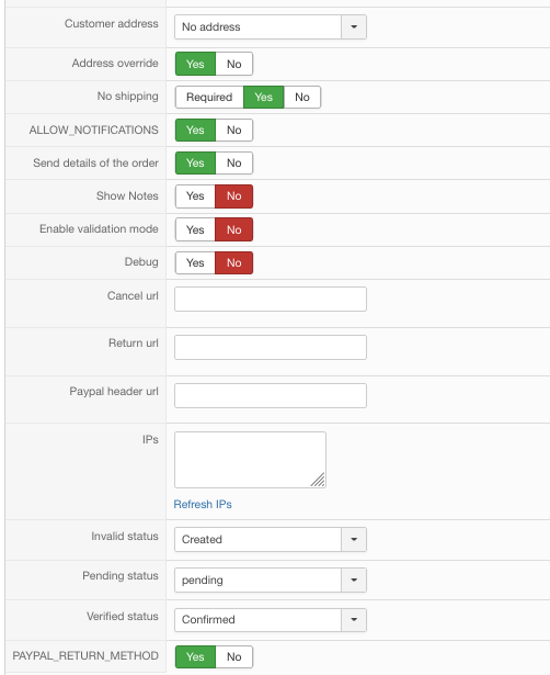

6 years 3 months ago - 6 years 3 months ago #320406 by Philip
Replied by Philip on topic Easy checkout process
We will answer you step by step.
"2) I want an easy download after Paypal Payment - Does this mean I need the Paypal Express Payment? -
I see 2 Options :
HikaShop Paypal Advanced payment plugin
HikaShop Paypal Express Checkout payment plugin
Both payment plugin allow you to build a guest checkout but the Express checkout will offer to your customer to process his payment directly on Paypal process, without run all the HikaShop checkout step.
And so, you have the choice on this point.
"3) What else needs to be configured to just have a simple no registration, Pay and Download Shop?"
Best is to reproduce my screenshot configuration of my Checkout, in Checkout tab => Login & Registration part :
"4) With this option - does it mean I won't ever get a tribe of buyers that I can send marketing emails to for future sales?"
Even in guest mode, HikaShop have to collect some information and so email is save in customer listing and associated with each order.
"5) I have the Paypal Payment method enabled at the moment and I set it to "Get Notifications" but I still don't see a way for users to be able to go directly to a Download page where they can Download the product..? Unless the Paypal Sandbox does not give this option?"
In order to explain you, the product download isn't directly managed by Paypal or any other payment methods, payment method will only leads order to be mute as "confirmed", and that this confirmed status that will allow your customer to download there elements.
When the order is mute to confirmed then your customer must received the order status notification email, and with it a direct download link.
Hope this will be more clear on your side.
Last edit: 6 years 3 months ago by Philip.

6 years 3 months ago #320452 by nicolas
Replied by nicolas on topic Easy checkout process
So you means that the order status is not changed to "confirmed" automatically after the payment ?
In that case, it's a payment notification issue. It can come from many things.
We've actually written a documentation you can follow here on that issue:
www.hikashop.com/support/documentation/i...or.html#notification
However, the most common issue is that you've activated the "enable validation mode" setting of the PayPal payment method, and in that case, you need to manually validate the payments in your PayPal merchant account so that the order gets confirmed and then the download link is sent to the customer.
If you want it all automatic, you should turn off that setting.
More

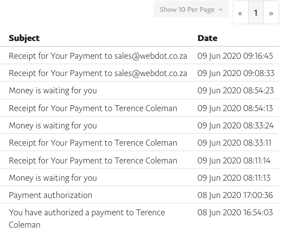

6 years 3 months ago #320476 by Uriel
Replied by Uriel on topic Easy checkout process
"So you means that the order status is not changed to "confirmed" automatically after the payment ?" - Yes that's exactly what I mean.
I have now changed the .htaccess to a standard Joomla one and I also changed the Paypal Payment as you suggested. - Please see attached screenshot with settings.
I have read through the Paypal documents and I am not finding anything else I need to change.
I have furthermore disabled Redirect Plugins, Sitemaps plugins and all other things that I think could cause issues and I am still not getting a CONFIRMED states on orders, after Paying with Paypal Sandbox.
When I return to the site I see :
Message
Thank you for your purchase.
You can now access your order here.
I receive the emails a Buyer and Seller would receive, but the Order Stays Pending.
I am also attaching the Notifications from Paypal Sandbox
More
6 years 3 months ago #320486 by nicolas
The payment method is properly configured.
Check that the payment is not pending validation in the PayPal sandbox merchant account.
You might need to manually validate it there to send the payment notification to your website.
Also, check the IPN history of the merchant account:
developer.paypal.com/docs/api-basics/not...0the%20IPN%20message .
This logs the payment notifications sent by PayPal to your website after payments are done.
It might contain information on why the payment notifications are not being received.
Finally, I would also recommend to activate the "debug" setting of the payment method. Then, do a test payment and check the "payment log file" in the HikaShop configuration. If the plugin receives the notification but can't handle it for some reason, it will be logged in there.

6 years 3 months ago - 6 years 3 months ago #320558 by Philip
Moderator : I remove your post because the attachement can be dangerous for your own safety, and here your message :
________________________________________________________________________________________________________
nicolas wrote: Hi,
Hi Nicolas, thank you for the reply...
I am not sure where to check if the Paypal Sandbox Payments need to be validated but I do see this on the Receipts :
Payment sent from info-@mytestaccount.co.za.
There is currently nothing on the Paypal IPN History...
I got to a page that specifies that I need to enter a URL to receive IPN Messages:
Edit Instant Payment Notification (IPN) settings
PayPal sends IPN messages to the URL that you specify below.
To start receiving IPN messages, enter the notification URL and select Receive IPN messages below. To temporarily stop receiving IPN messages, select Do not receive IPN messages below. PayPal continues to generate and store IPN messages until you select Receive IPN messages again (or turn off IPN).
Notification URL - ??
I am not sure which URL to enter...?
I am attaching the Payment Plugin Log File that you suggested

6 years 3 months ago #320574 by nicolas
If you check the log file you sent, you can see this line:
Code:
[payment_status] => Pending
This indicates that the payment is pending on your merchant account.
So it's normal that the order is not confirmed.
If you log to the merchant account on the sandbox, you'll see that the payment is pending and you need to validate it.
This should not happen with the "enable validation mode" setting turned off in the payment method.
However, as you're using the sandbox, this might be something inherent to the sandbox account.
I would recommend to check with the PayPal merchant support.
www.paypal-community.com/t5/Sandbox-Envi...ing-why/td-p/1417716
Note that when you use the PayPal sandbox, you need to use a paypal sandbox account and in the "email" setting of the payment method, you need to enter the email address of the PayPal sandbox merchant account.
Reading that thread, if you don't do that, then the payments will be pending.
So I assume that the problem comes from that.
More
6 years 3 months ago - 6 years 3 months ago #320651 by Uriel
Thank you Nicolas,
For anyone else struggling with this please note :
Use the Paypal Snadbox DEFAULT email accounts in your Payment Method in Hikashop.
That's ALL I changed and it's working!
So by Default PayPal Sandbox will give you something like :
info-buyer@yourdomain.com and info-facilitator@yourdomain.com
Use the facilitator account in the Hikashop Paypal Payment Method and PAY with the "Buyer" email account when you test a transaction with Paypal Sandbox
An entire weeks battling could have been avoided by simply doing this :(
