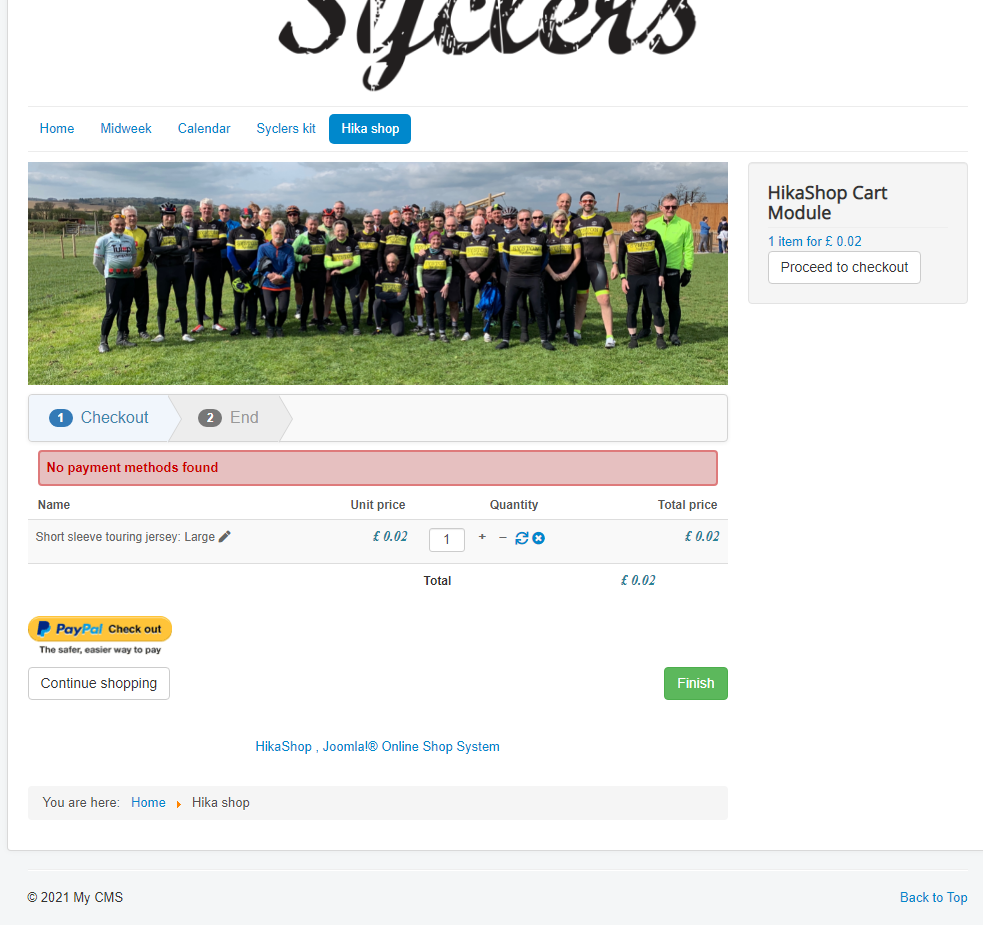

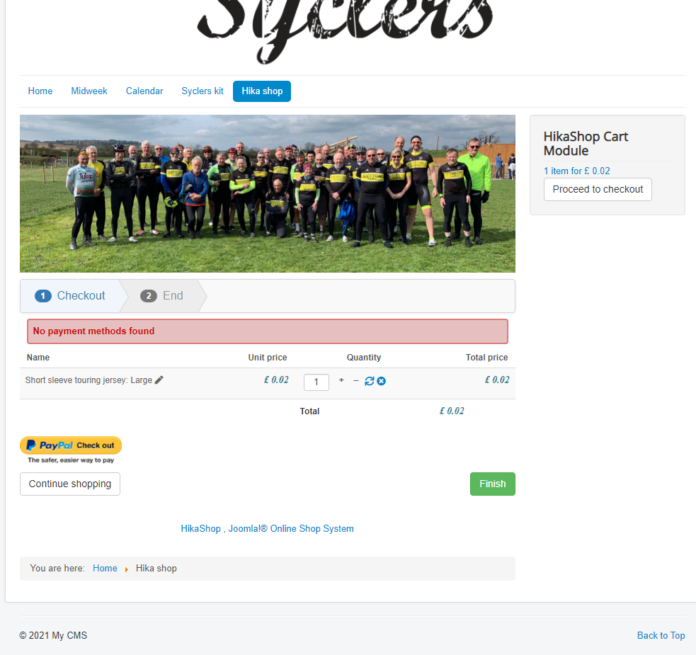

Hi, I have a simple shop in testing phase using Paypal express, no registration required, collection only and it seems to be working using the paypal button. My problem is that there is wording on the checkout which is not required and I would like to remove it, is that possible in any of the setups or do I have to go into PHP somehow?
This is what comes up: -
Registration not allowed
No payment methods found
Enter your coupon

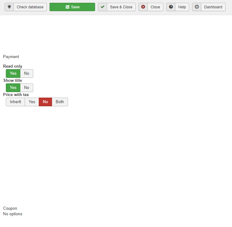

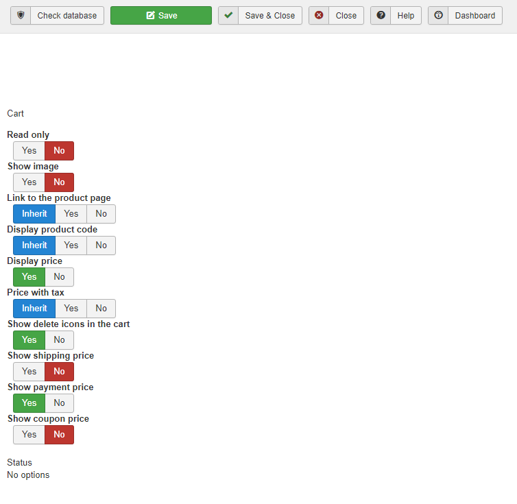

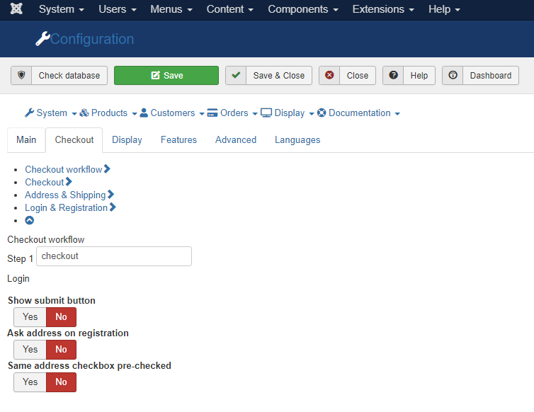

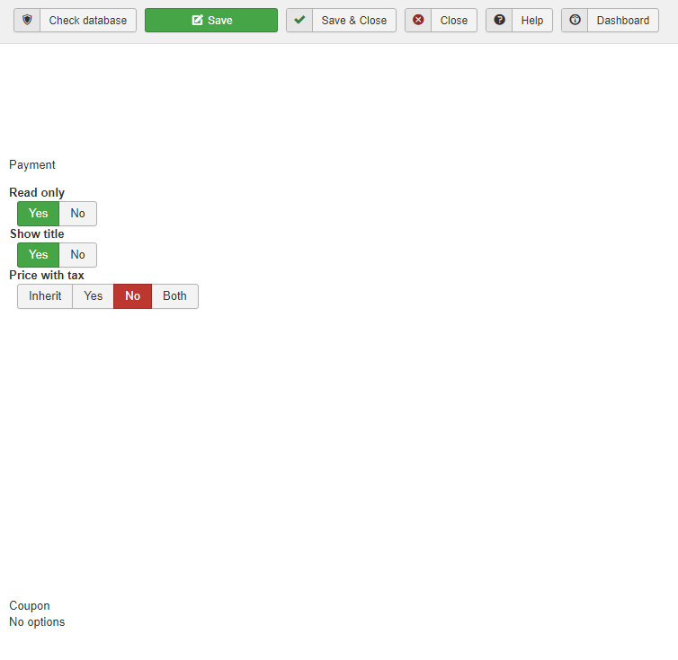

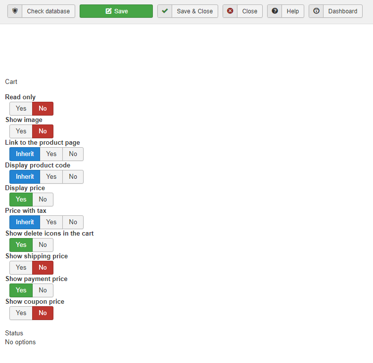

  • Posts: 11
5 years 4 months ago #332362
Thank you so much for trying to sort this out for me. My workflow doesn't display in boxes for some reason but I have taken screenshots of the checkout workflow as displayed on my screen. You will see that Coupon is set to "no option"
  • Posts: 86214
  • Thank you received: 14221
5 years 4 months ago #332364
You seem to have a CSS issue. Go under the Display tab of the HikaShop configuration and make sure that the "backend CSS" is set to "default" and save.
It should then hopefully display properly.

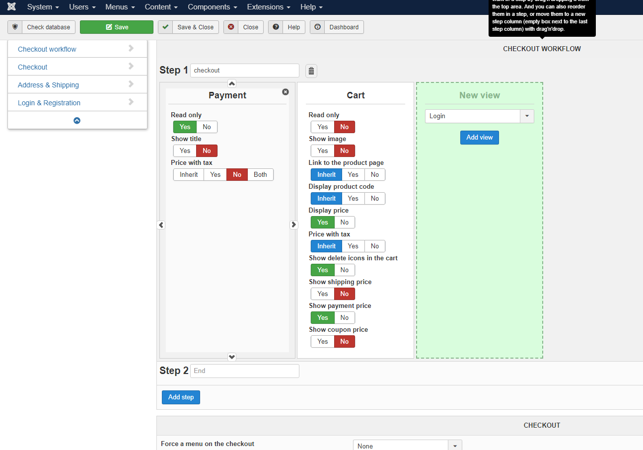

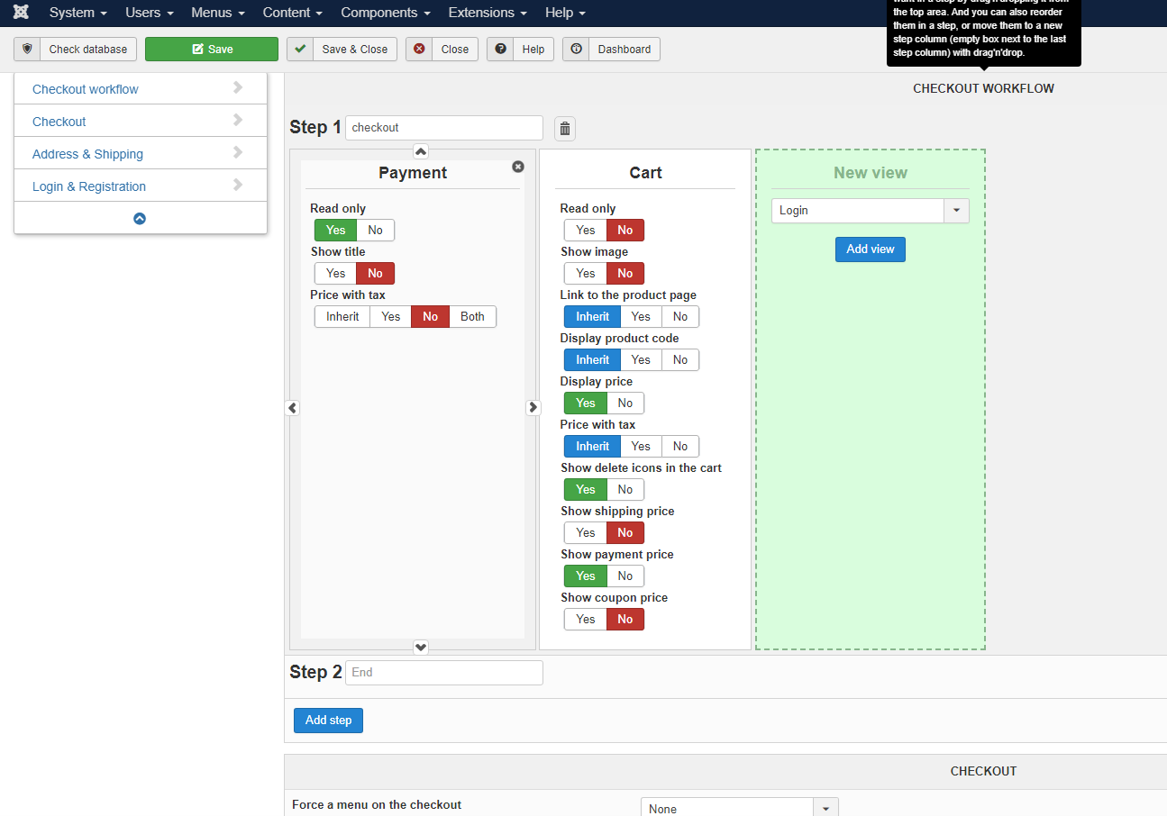

  • Posts: 11
5 years 4 months ago #332375
Thanks again for your help, I corrected that problem and have deleted the coupon and login boxes, those two messages no longer appear. Sadly I still get the "no payment methods found" message so I still have something wrong.
  • Posts: 11
5 years 4 months ago #332377
Hi, I found that I just need to delete the payment box as well so only the cart is left, now everything is fine.
