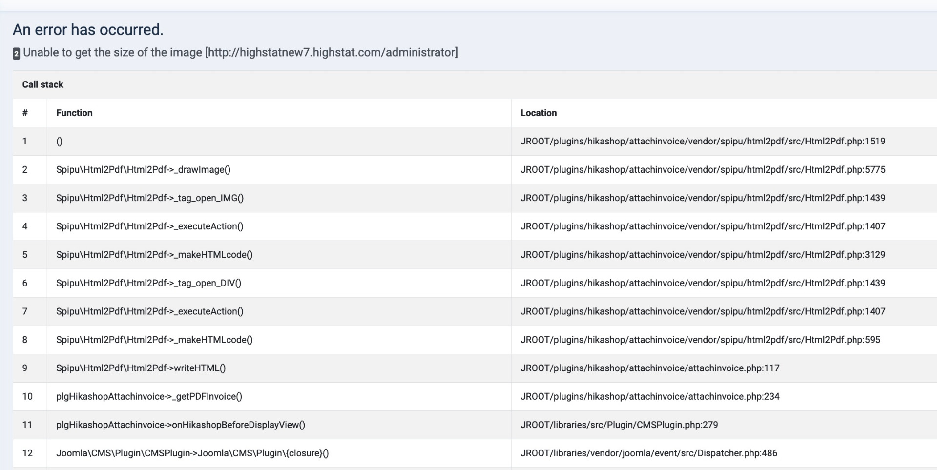

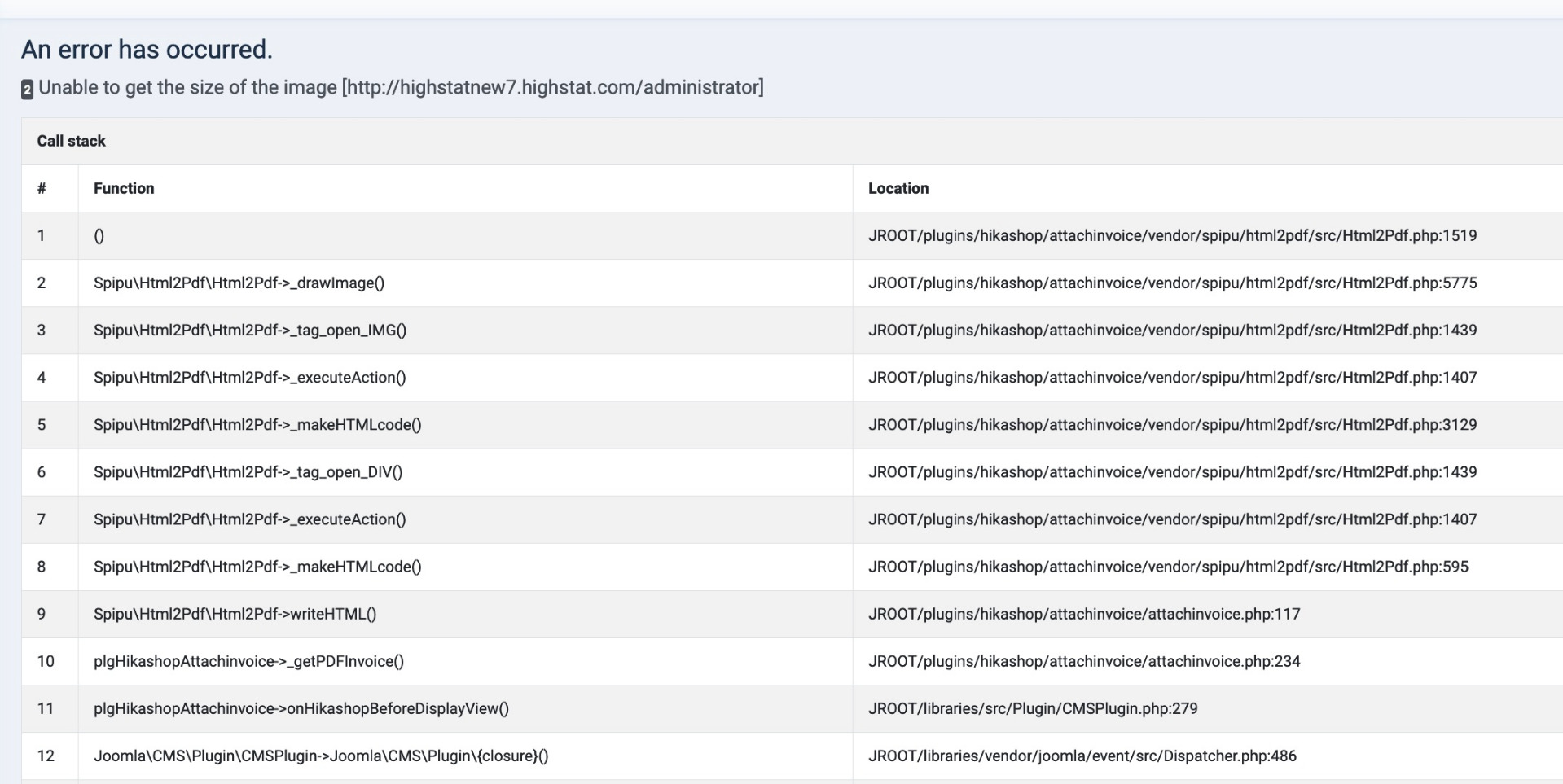

  • Posts: 28
3 years 9 months ago #347351
Indeed...no pdf. Neither for the "customer's" email nor the email in the plugin.
Clicking on the Orders-Invoice button...ahh...that gives me something. See snapshot.
Unable to get the size of the image
What does that mean?
Alain
  • Posts: 86212
  • Thank you received: 14220
3 years 9 months ago #347352
That's a bug we've fixed 2 days ago:
www.hikashop.com/forum/install-update/90...-payment/347256.html
Download again the install package of the PDF invoice plugin on our website and install it again on your website and you should not have the problem anymore.

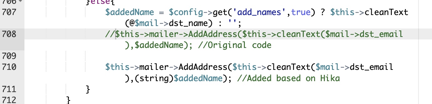

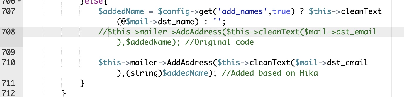

Thanks. Changing the line:
$this->mailer->AddAddress($this->cleanText($mail->dst_email),$addedName);
to:
$this->mailer->AddAddress($this->cleanText($mail->dst_email),(string)$addedName);
in the file administrator/components/com_hikashop/classes/mail.php should also remove the deprecated message.
Please try it and confirm whether it removes it or not. That way, we can add the change on our end for the next release of HikaShop.
  • Posts: 28
3 years 9 months ago #347410
I made the suggested changes in administrator/components/com_hikashop/classes/mail.php
but that gives the same warning message:
Deprecated: preg_replace(): Passing null to parameter #3 ($subject) of type array|string is deprecated .... etc. Same line of code.
I assume that your earlier suggestion, namely changing $name = trim(preg_replace('/[\r\n]+/', '', $name));
to: $name = trim(preg_replace('/[\r\n]+/', '', (string)$name));
in the file libraries/vendor/phpmailer/phpmailer/src/PHPMailer.php
means that when I upgrade Joomla, I have to make this change again?
Alain

3 years 9 months ago #347412
1. That's strange. The callstack debug you provided does point to that line of code and that $addedName variable being null instead of being a string. And the (string) addition there will force this variable to be sent as a string to the AddAddress method.
You're saying "Same line of code". If you add the debug_backtrace code again and look at the result, can you confirm that it now points to the new line number of the AddAddress call and not the old one ? On some hostings, it's possible that even if you modify a line of code, it is taken into account only a while after the change due to caching.
2. The code change in PHPMailer might be needed in a future update of Joomla, but not after each update. It depends whether the update provides a new version of the file or not. But note that if you have the "debug" and "error reporting" turned off in the Joomla configuration (and you should on a live website, for security reasons), you won't see the deprecated message anyways. It will only be a problem when you migrate to PHP 9 or PHP 10 when that deprecated message turns into a fatal error message. At that point, the change will be mandatory. But by that point, PHPMailer will probably have changed their code and Joomla updated it to better take into accounr these issues.
