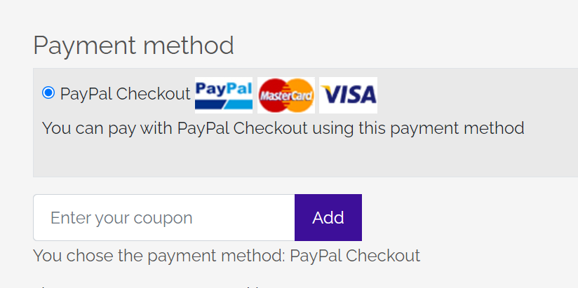

2. I want to remove the Coupon field from the Checkout page (as shown in the attached screen capture) but when I go to the page that Nicholas pointed me to I cannot find any option for suppressing it. How do I do this?

2. If you hover on the coupon view in your checkout workflow, you'll have a delete cross appearing on the top right corner of the coupon view. Press on it and then save the checkout workflow and that's it.

2. OK I now understand how this works and have suppressed the coupon.

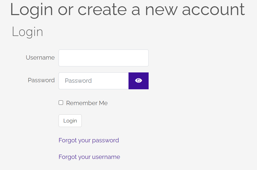

4. OK I have put the Login back and it now puts up the Login screen but I removed this option originally because I only want customers to go through as "Guests" but this screen does not give an option for doing this. Is it possible to do this? Also there is no option on this screen for creating a new account - see enclosed screen shot.

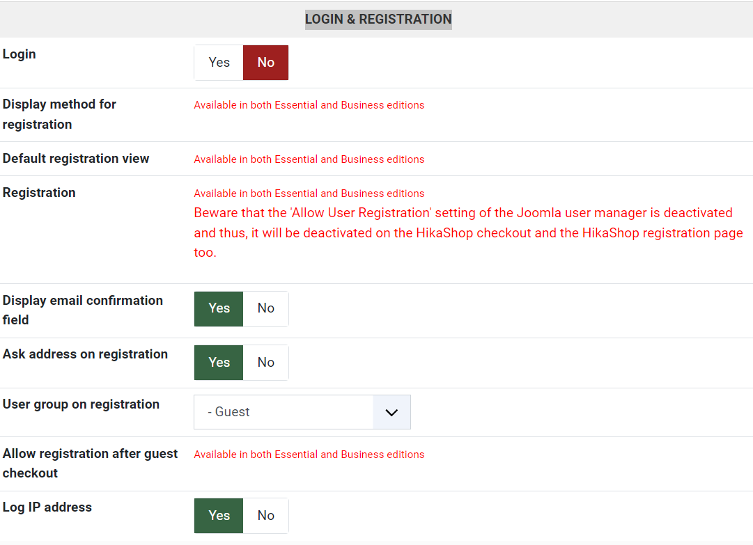

Go in the Checkout tab of the HikaShop configuration. There, in the "Login" view you have apparently activated the "Override registration" setting. Please turn this option off.
Then, in the "LOGIN & REGISTRATION" section, you want to turn off the "Login" setting and set the "Registration" setting to "guest".
You'll then have a guest checkout.
  • Posts: 26

4. OK in the Checkout tab I have now set "Override registration" setting to off. However in "LOGIN & REGISTRATION" section, you want me to turn off the "Login" setting and set the "Registration" setting to "guest". I've turned off the "Login" setting and set "User Group" to "Guest" because I can't see any other option to set to "Guest" (see enclosed screen capture). However this just results in completely missing out the login and address screens, going straight to Payment Method with the message "Registration not allowed" and "Access Forbidden". I am more confused now!!
Gary

Thank you you were correct I have done this and now get the User Registration screen. However I still do not get the option to checkout as a Guest without having to enter all of the user registration date.

When I try to login, I get this error message:
i.imgur.com/KN7resz.png
This seems to indicate that there is a problem with the user account's user group.
And if I check the screenshot you previously provided you set the "user group on registration" setting to "guest".
This means that the user accounts created from the HikaShop registration form won't be allowed to login on the frontend.
So please revert that setting. And please edit the user account and add it to the registered user group.
Also, please turn back on the "login" setting of the HikaShop configuration. Otherwise, it's not possible for a user to login with their user account on your checkout since the login form is removed.
