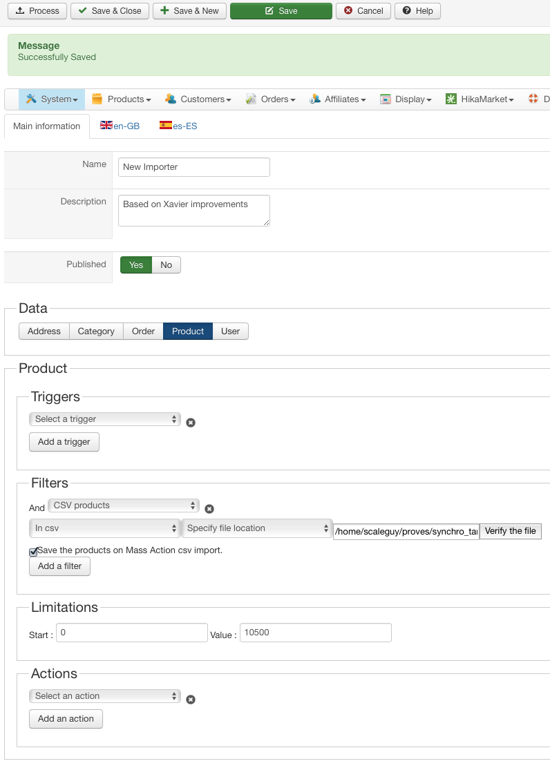

I'm not able to see this checkbox in the CSV products filter and also not in the Action Export CSV file (I understand it has to be in the filter).
I checked both in the existing Mass actions and creating new ones from scratch.

10 years 7 months ago #229012
No once again it's my bad, I forgot to give you another edited plugin:
Last edit: 10 years 7 months ago by Xavier.

Ok. Sorry that I didn't come back to you until now. Strangely I never got an email reporting for this update :( so I found it now through my desperation process to find a solution.
I checked the new plugin. I can confirm now the checkbox to add new products is there. But sadly I can confirm it STILL NOT creates new products. Maybe something else be missing in the process. Should I configure some special rights somewhere or something maybe you at HikaShop take for granted but not me as a user?
