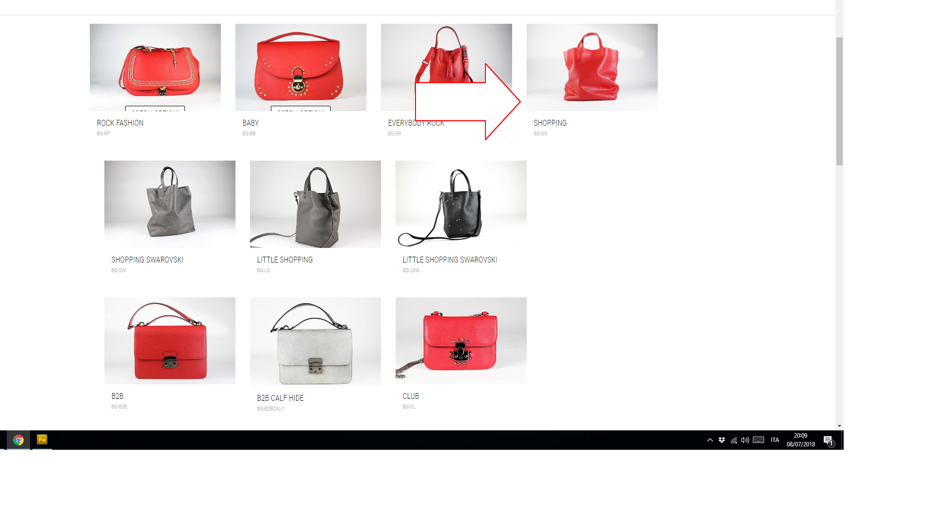

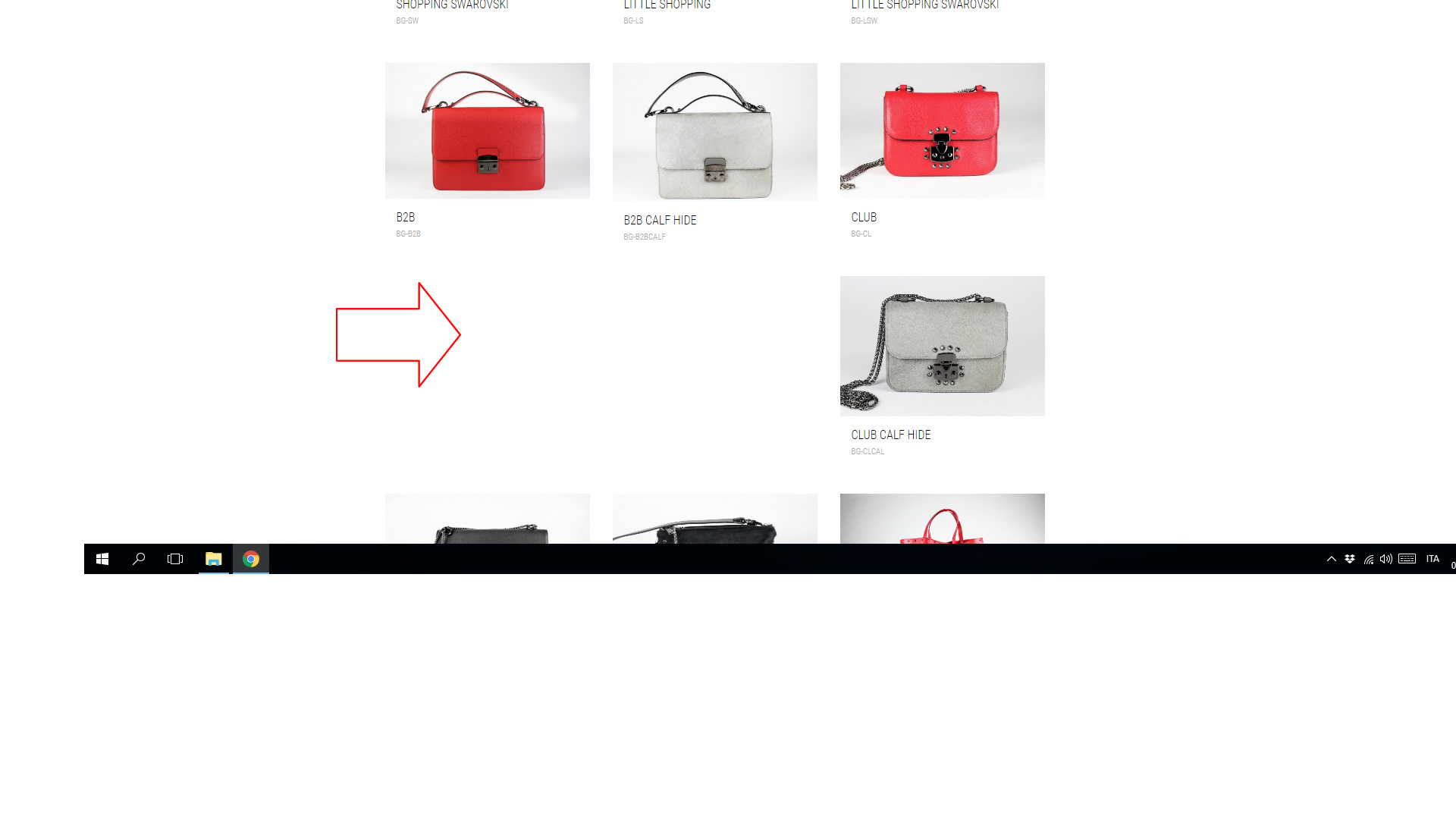

hello
after having upgraded to the latest version,
the list of products which was a regular grid has become unbalanced as in the images attached.
as you can see there are voids and some items are alone on the right
help please

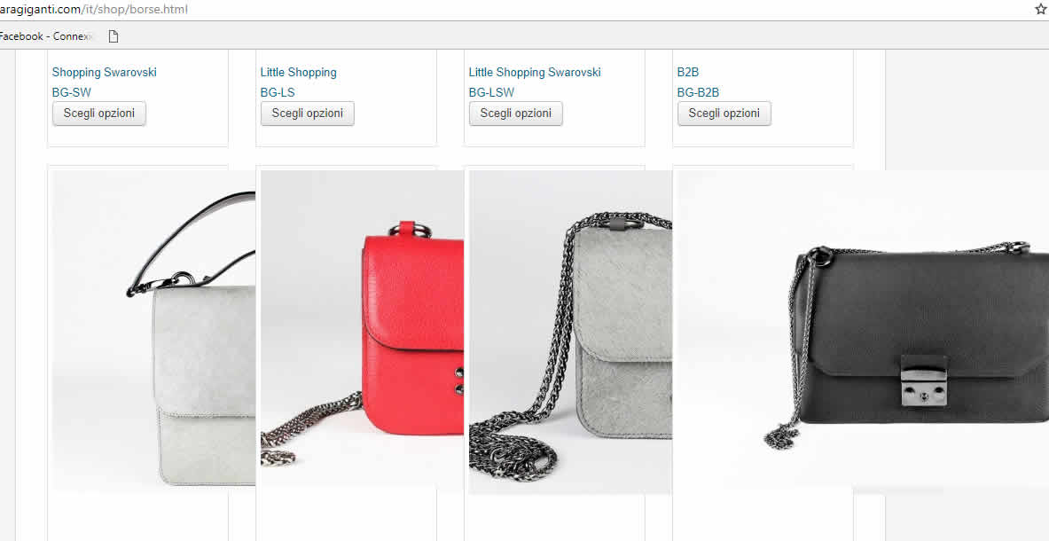

8 years 1 month ago #295116
I've tested with one of the default template and this is the result.
Can I ask you to connect to the site and check personally?
