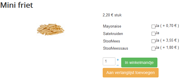

-- Joomla version -- : 3.9.22
-- PHP version -- : 7.3.12
How can I create this kind of multiple choices that also increases the end-user price?
Thanks in advance.
Guy
PS the part 'PORTIE' is not important. I'm looking for a way to create the parts 'Kruiden' en 'Sausen' in HikaShop
  • Posts: 86101
  • Thank you received: 14203
5 years 9 months ago #325916
You need to use the "options" system:
www.hikashop.com/support/documentation/i...ct-form.html#options
That will allow you to have a page like this with options that can increase the price of the product:
demo.hikashop.com/index.php/en/hikashop/...ct-page/with-options
In the HikaShop configuration, you'll find the setting "Product selection method" where you can choose if you want the options to display as a single dropdown, a radio selector, or a checkbox selector like what you have in the Kruiden and Sausen parts of your link.
Finally, if you need a different select method for different options, you can set that setting to "on a per product basis" and you'll then have a similar option in your option products setting page so that you can set that per option.

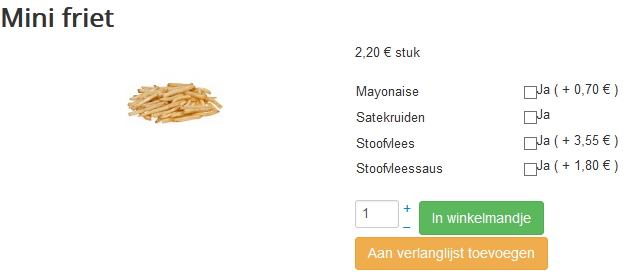

  • Posts: 19
5 years 9 months ago #325947
Thank you.
another 3 questions:
1)do you like to have a separate ticket per question?
2)the total price of the article is not updated when I select my option-article. Suggestion how to show this total?
3)the space available for the quantity is to small, where / how can I enlarge that? And 2) to show somehow the total price applies also here.
Thanks in advance
Guy
  • Posts: 86101
5 years 9 months ago #325949
1. It's indeed better
2. This works fine on our end. Please provide a link to the product page with the issue so that we can look at the situation.
3. That's probably a CSS issue linked to the CSS of your Joomla template. Again, we'll need a link to that page to check on the situation.
3.2 " show somehow the total price applies also here" I'm sorry but I don't understand what you mean by that.

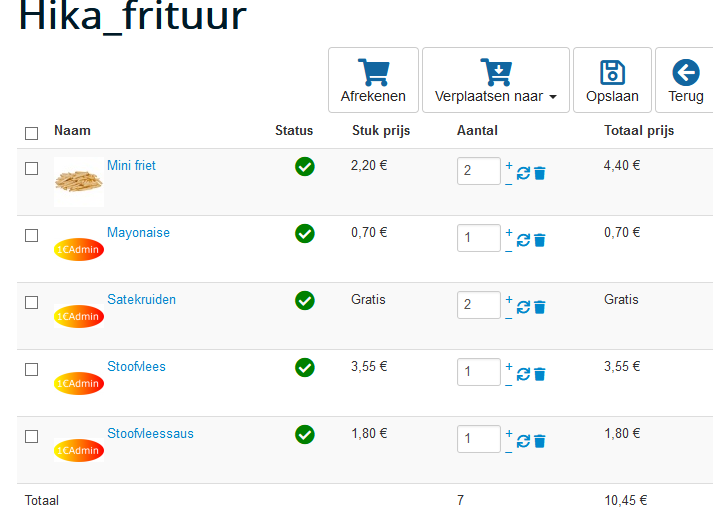

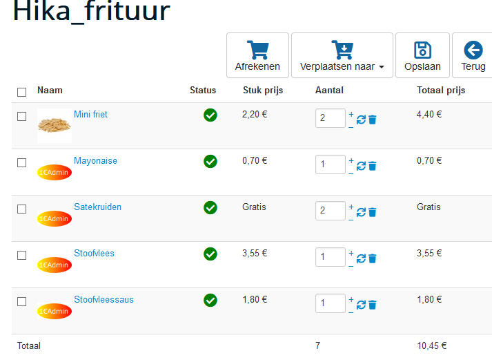

  • Posts: 19
5 years 9 months ago #326238
I have orded some food for 2 persons:
1 mini friet + mayonaise + satekruiden + stoofvlees
1 mini friet + satekruiden + stoofvleessaus
How can the person who must prepare this food know what to do? Any suggestion?
Thanks in advance
  • Posts: 86101
5 years 9 months ago #326277
Turn on the "group options with product" setting in the HikaShop configuration and it will work like you want.
The following user(s) said Thank You: guyb
