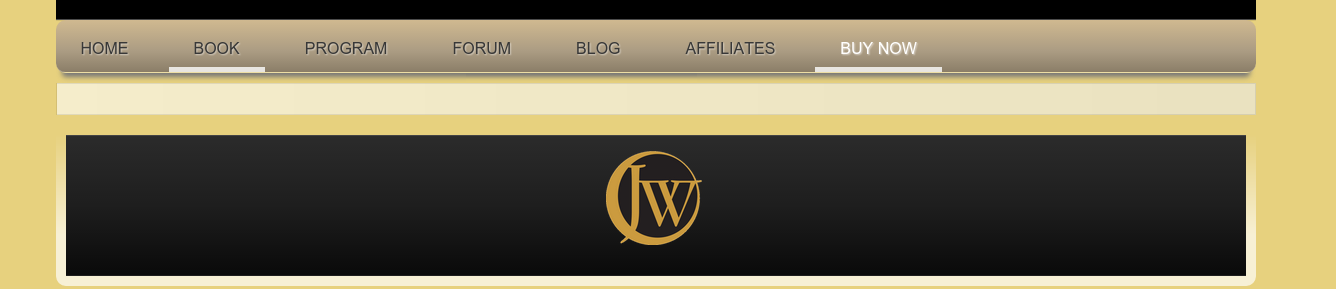

Step one on my flow screen is login. I require them to register, and require the address on registration. This works fine and I get the email with a link back to the site to confirm registration. However, after submitting the registration on the site, It will take me to a "blank" screen. My number one priority was "did I get the email", and the answer is yes. However, I do not want to have to count on the possible user having the inclination to check their email. I would think there should be some message here telling them that the email has been sent and they need to check for it. I have attached a screen shot of what I get after the register button is pressed.

You didn't look at the right thread.
That is issue is quite common actually. You don't see the message after the registration because your template is not displaying messages. Please follow these instructions: www.hikashop.com/support/support/documen...tibility-issues.html

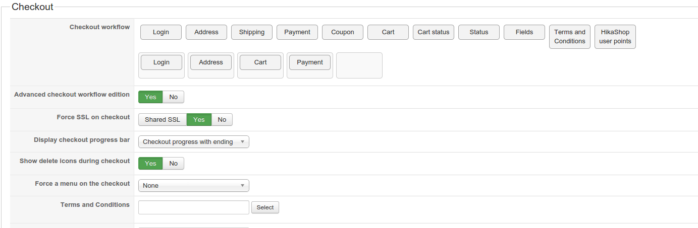

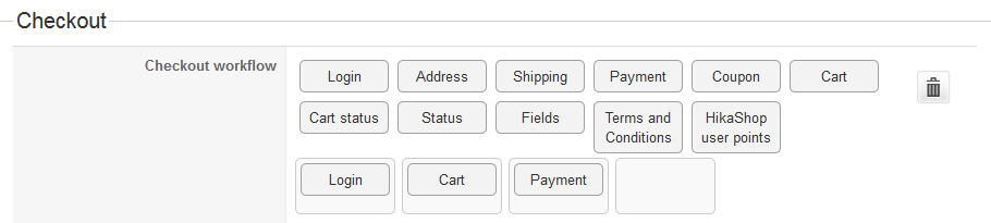

I am hoping that I can solve this with a change to the flow screen, but I don't know if that is possible. Current setup:

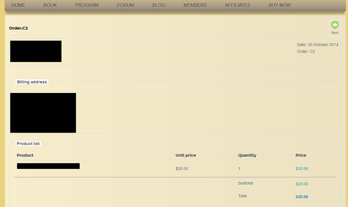

After the user does a login, which is also a register, they get the email. After clicking on the email link, they return to the check out process. They are also logged in to the site. At that point, they are an enabled user and part of the group that the purchase will assign them to. If they want, they can click out of the checkout and have full access to whatever they would have based on the purchase. Here is a shot from a "botched" purchase where I clicked out of the checkout after registering. As you can see the "fake" user is active:
I removed this user and decided to move forward with the process. I got to the last step of the purchase where I would normally enter the credit card number. I then exited the purchase. My fake user received a order invoice via email. Then I checked the order process on both the front and back sides of Joomla!.
User can access their order information on the site. It looks like they have a successful purchase.
The soon to be administrator can see the order on the Hikashop dashboard. Is the Order status the tool they need to use to see that this checkout process did not complete? Or will they be filling an order that was never completed, and sending away their product?
