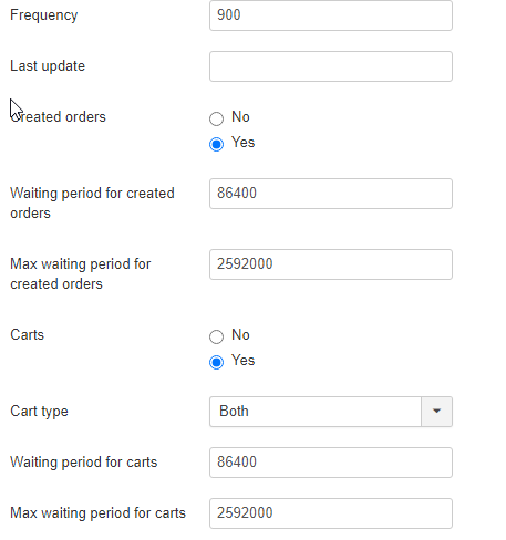

5 years 11 months ago - 5 years 11 months ago #327575 by Philip
Can you provide your Reminder plugin settings screenshot ? Did you have a lot of returns about this issue ?...

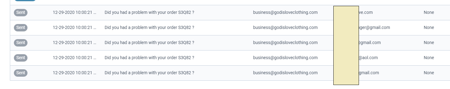

5 years 10 months ago - 5 years 10 months ago #327848 by dklbwf
No the email is being sent separately. and email or name is never in subject line. In the screenshot below you can see one order reminder went to correct person today at 10AM but then also got sent to 4 others at the same time with same exact order/billing info. The cron job runs each day at 10am

5 years 10 months ago #327852 by nicolas
Ok.
So can you check the email history for that email ? do you see the email once there or several times (one for each email address) ?
If you see it several times, it would mean that the issue is when the email is being generated. So either in the plugin, or in some customization or plugin processing the email.
If you see it only once, with the correct email address, it means that the plugin and the email generation as working properly and that the issue is later, when the email is being sent, and thus, no matter what I would change in the plugin, it wouldn't solve the problem as the problem is not in the plugin.
