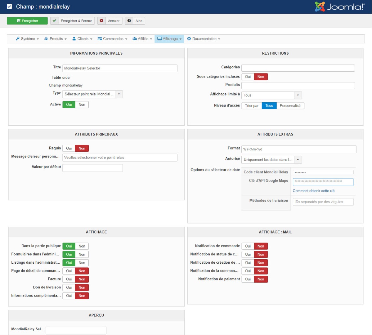

4. Mondial Relay Extrafield
I install the Mondial Relay Extrafield, and it was working very great until the last update of Hikashop 4.4.1 i did the 5 of march.
Before, i was able to display the widget when i choose the mondial relais shipping mode, and to hide it when i choose another shipping mode, and to show it again if i choose the mondial relais shipping mode again.
Now if i choose another shipping mode, and after i choose mondial Relais again, the mondialrelay_zone_widget stay empty, and just the input of point relais selected is shown.

4. We would need a screenshot of the settings of the custom field and precise instructions to reproduce the issue on your website to be able to understand what's going on.

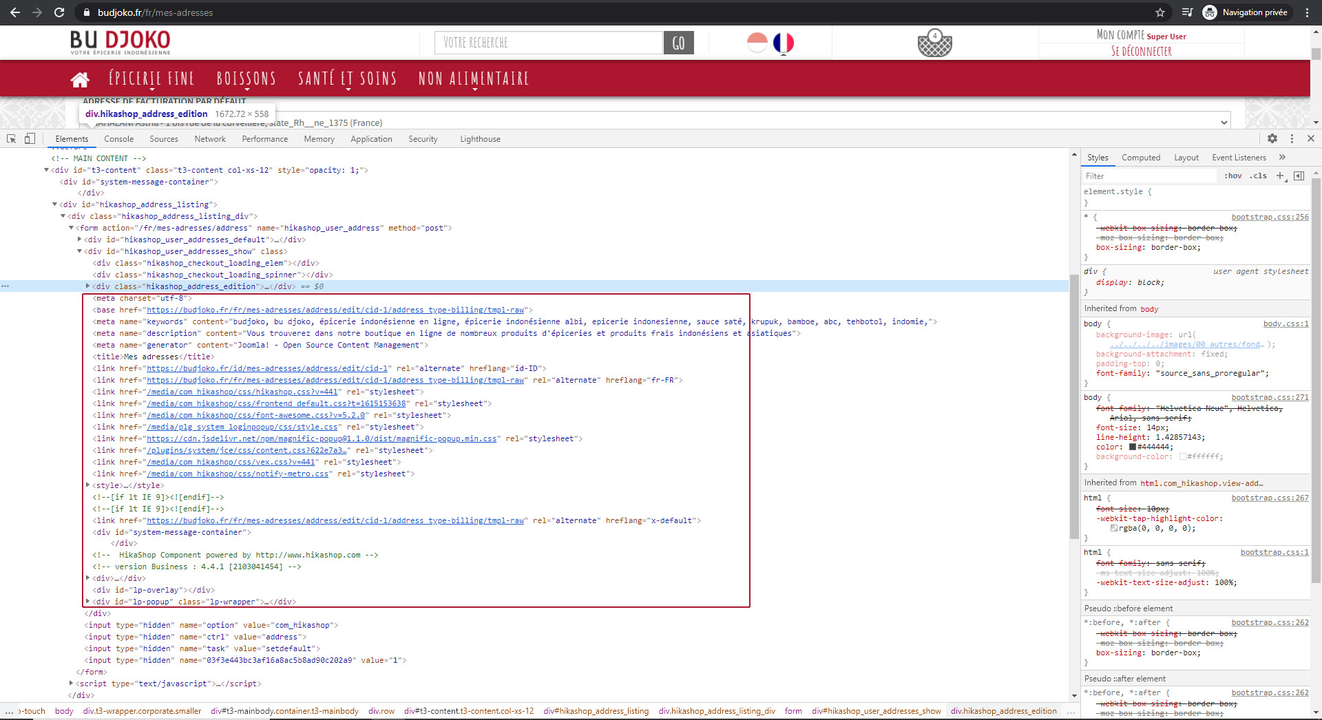

1. It seems to come from a customization. If you check the HTML of the address edition form, you can see that there is a logout button inside the HTML of the address edition and this has nothing to do there:
i.imgur.com/tMVlaby.png
Because of that, when you click on the "ok" button there, the input data from the logout button is sent by the address edit form:
i.imgur.com/ITMbENy.png
This leads to Joomla logging you out instead of saving the address form data.

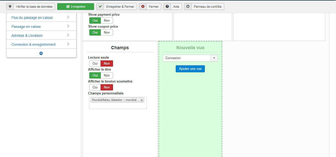

2. I see what is the issue about. It's because we now refresh the custom fields view on the checkout when the shipping method is changed to accomodate with new options we've added.
However, the mondial relay plugin uses external javascript and these can't be loaded dynamically when the view is refreshed and thus you end up with the area being refreshed but the javascript not reinitializing the mondial relay interface.
To change that, edit the file show_block_fields.php via the menu Display>Views and change the line:
to:
and it should then work like before.
Code:
window.Oby.registerAjax(['checkout.fields.updated','cart.updated','checkout.shipping.changed','checkout.payment.changed'], function(params){
Code:
window.Oby.registerAjax(['checkout.fields.updated','cart.updated'], function(params){
