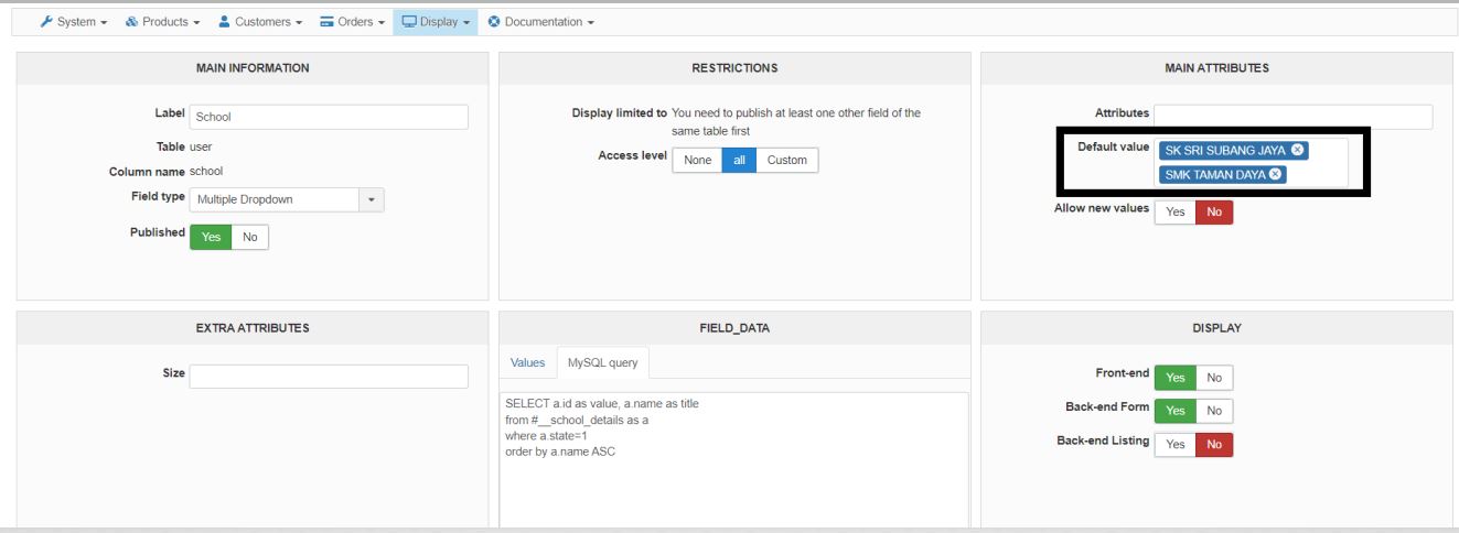

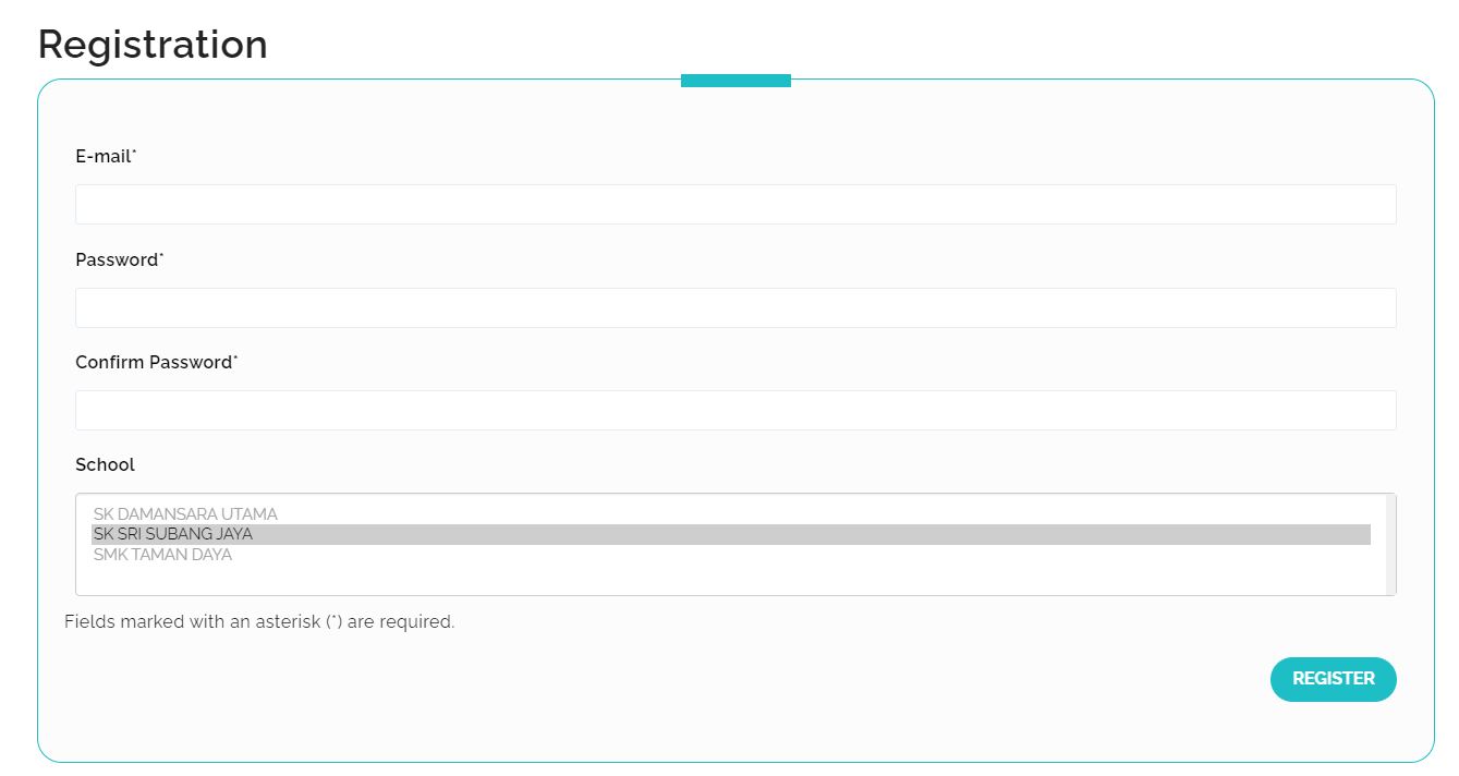

I want to add a custom field with type Multiple dropdown for the user to select during registration. The field in the back end is fine, but it displays different in the front end, is there any way to make the field to display as the same with the backend field?

3 years 10 months ago #345194
For ergonomics. It is about the display pattern. I have used the multiple dropdown custom field. What I expect from the front end view for the custom field is as same for the backend view. The back end display of the custom field is what I want, and what I want to ask is if it is possible to make the display in the front end the same as the back end.

3 years 10 months ago #345203
In the backend, it's Joomla's chosen library dynamically changing the look of the custom field.
To do the same on the frontend, you can try activating the "use Chosen library" setting in the HikaShop configuration.

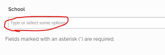

Thank you for the steps. I have set it successfully. One more question, if I can change the default wording 'Type or select some options'?
  • Posts: 86042
  • Thank you received: 14174
3 years 10 months ago #345236
That's a text from Joomla:
JGLOBAL_TYPE_OR_SELECT_SOME_OPTIONS="Type or select some options"
You can use a translation override to change it:
