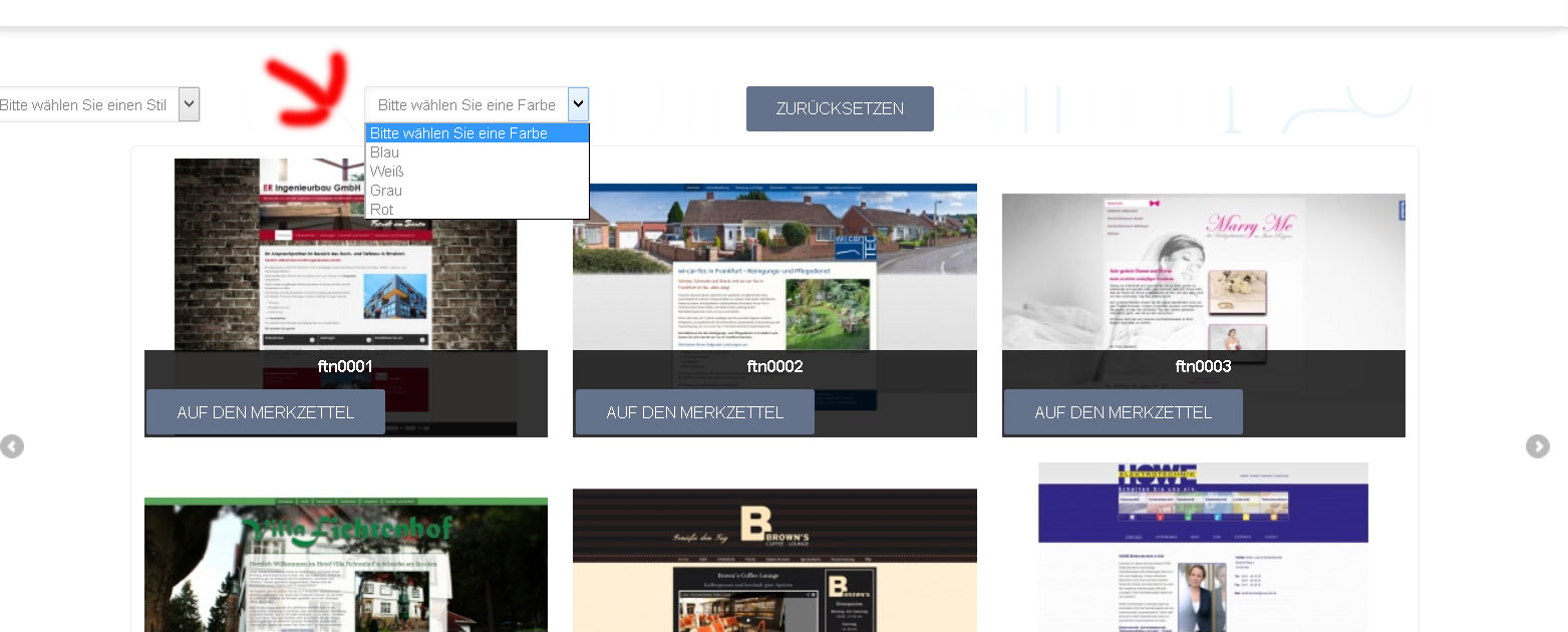

  • Posts: 17
11 years 7 months ago #181140
I have a few filters connected to the carousel, all is working fine...
Only I would like the colors in one of the filter fields appear as colors, not as text. (see screenshot)
After reading your post I tried to enter the html code (which one exactly? simple #fff tags and the like?),
but I couldn't get it working...
A push in the right direction would be appreciated.
  • Posts: 85916
  • Thank you received: 14130
11 years 7 months ago #181223
Dropdowns cannot have images. So you need instead to create a radio type filter.
It's what is explained in the tutorial filter section:
www.hikashop.com/support/support/documen...by-color.html#filter

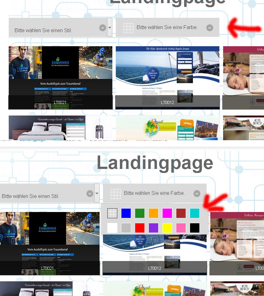

See the example screenshot of our old website, which was realised with VM: The colour palette is hidden until clicked.
Basically this should be very similar to the simple date picker.
Any ideas?
  • Posts: 17
11 years 7 months ago #181281
Nicolas,
I have eventually found the color-picker that was used in the old website shop:
github.com/tkrotoff/jquery-simplecolorpicker
Can you give me any advice on how to integrate that into the Hikashop system?
  • Posts: 85916
11 years 7 months ago #181289
In that case, it will require that a developer customize for you the display of the dropdown to transform it into a color picker.
If you're a developer and you use that simplecolorpicker javascript library it should not be much:
First, you'll want to change the custom product field to have the color color in the value field of each choice and the name of the color in the title of each choice.
Then, resave your products with the new values.
Then, add the javascript files of the color picker library and the javascript initialisation of the filter dropdown (with the correct id as explained on your link) to your joomla template main file and it should transform it into a color picker.
If you're not a developer, you'll have to hire one to have him do it for you.

  • Posts: 17
11 years 7 months ago #181893
Thanks Nicolas,
I eventually got the thingy to work.
I took a slightly different approach, though. Instead of inserting code in the view, I went with the aforementioned plugin.
Where the code was something like this:
<select id="filter_Bitte_wahlen_Sie_eine_Farbe_br_hikashop_category_information_module_698" name="[b]filter_Bitte_wahlen_Sie_eine_Farbe_br[/b]" size="1" onchange="document.forms['hikashop_filter_form_hikashop_category_information_module_698'].submit();">
I took the name part and addressed it with the colorpicker,
$(document).ready(function(){
$('select[name="filter_Bitte_wahlen_Sie_eine_Farbe_br"]').simplecolorpicker({
  picker: true
and that was that.
I wouldn't have gotten that far so quickly without your help.
Thanks again.
Frank
