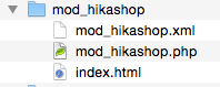

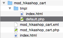

  • Posts: 2693
  • Thank you received: 73
10 years 11 months ago #212381
a tmpl folder for each mod_
in my template
if(!empty($html)){echo $html;  }
same here (tmpl missing)
Last edit: 10 years 11 months ago by erickb.
  • Posts: 86077
  • Thank you received: 14185
10 years 11 months ago #212402
Ah I understand. That makes sense.
We'll do that.
Thank you for your feedback.
