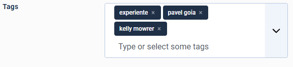

What I want to say by old style of custom field dropdown, is about how the field works in administrator.
Now, in hikashop 5.0.0, we have a list where we must hold CTRL and click to select multiple options, and the field it doesent have the option to search values of that field.
In hikashop 4.x a custom field by type Multiple dropdown was working like how tags are working in hikashop 4 and in hikashop 5, where you have the option to search an entry, easy add, easy remove.
Can we have that back?
Thank you!

It's not really that we removed anything. It was actually the same with previous versions of HikaShop.
It's actually Joomla 4 which removed the Chosen library as it is outdated.
Instead, they've introduced the choicesjs library, and it's this library you can see on your screenshot.
So we'll work at supporting that new library.
Thanks for your feedback.
