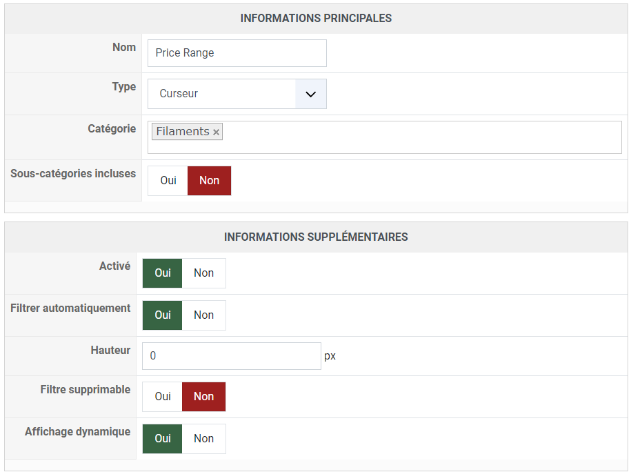

At this moment (and when I can access to my page), I try using 3 dynamic filters but when 1 filter is selected others are resetted.
And I dont understand why.
Do you have any solutions ? Thanks.
EDIT : Attachments (with the 3 filter settings) added
Last edit: 4 years 9 months ago by FDBI. Reason: EDIT : Attachments (with the 3 filter settings) added

I have for example changed 1 option for my 'price Range' filter :
My 3 dynamic filters work together except if I change the minimum price range (maximum is ok).

I would need screenshots of of the settings of your filters and the URL to the products listing with the filters on the frontend to check on the situation. Could you provide that ?

4 years 9 months ago #337750
  • Posts: 148
  • Thank you received: 21
4 years 9 months ago #337758
