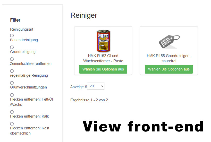

Hi there,

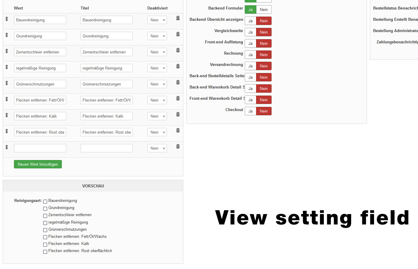

I have created a filter and unfortunately have to realize that the filter buttons are not in line with the text. There is always a line break between button and text (front-end)
. However, this is correctly displayed in the field settings. What else needs to be set for this?

Hi there,
thanks for the information. As you described, I changed "display: block;" to "display: inline-block;", unfortunately without any change. The adjustment was made by me as you described in the Hika css area, as well as in the custom.css of the template.
I have captured in the respective css files:
.hikashop_filter_container {display: inline-block;}
But this brought no change. However, I was able to test that I was correct with the css setting filter_values_container, since the input boxes were gone when I entered .filter_values_container {display: none;}.
I also tested it with .hikashop_filter_checkbox {display: inline-block;} in both css, also no change.
Also the css width: 92%; helps not.
I also noticed that the display (filter front-end) in your screenshot differs from the browser view I posted. With me, there is a line break after the check box in different browsers, with you it is in one line.
