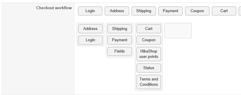

3. However i still cant pass first step in checkout. My checkout config is like this:
1. address,login
2.shipping,payment,field,
3.cart.....
4.end
Pressing next does nothing. It just reloads page and add this line to url: "/task-show/cid-1"

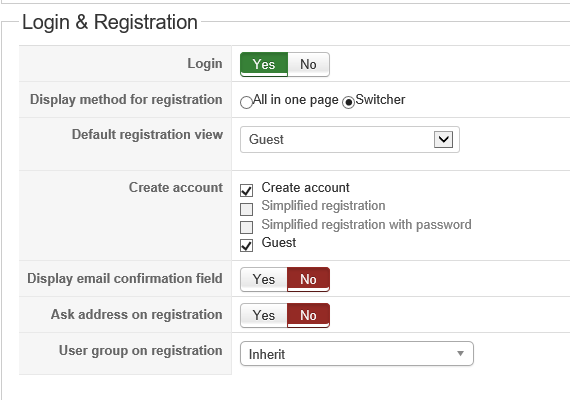

3. Some strange behaviour when entering details in fields. Example: first field is name, you enter details then for second one you have to click that field twice to be able to enter and so for other next field...
4.After I register joomla user module doesn't show user it still shows me login....

2. What are your settings for registration (in Joomla and HikaShop) ?
If I try to create an account, I get the email but I am not logged in the Joomla part.
And even if the "login" block is refreshing, the "address" block is not ; which means that the event that the user changed is not triggered.
Afterwards, if I try to login with the just created account, I got an error.
So I am not sure that the test account is activated in your backend.

2. I see test_hikashop is fully activated and enabled in joomla user interface. I have tried to login with this details via joomla and hikashop checkout login forms and joomla gives error that username or password is not correct, hikashop login gives error message LOGIN_NOT_VALID.
My registration is simple. You enter details like name, username, email, password and confirm password. User is created and email sent. No activation required. Couldn't be that the problem comes from the fact that I installed started packed up on business? in my business I had login/register settings as per image attached and now I only see login YES or NO...
I have set it to NO and login block not showing , I tried to registered then login and same issue as above...

It will be interesting to know what is your complete checkout workflow ; but I think it could be the reason why you cannot go in the step 3 while you're submitting the shipping/payment data in step 2.

4. I have attached screenshot of my checkout workflow, I hope it helps.
