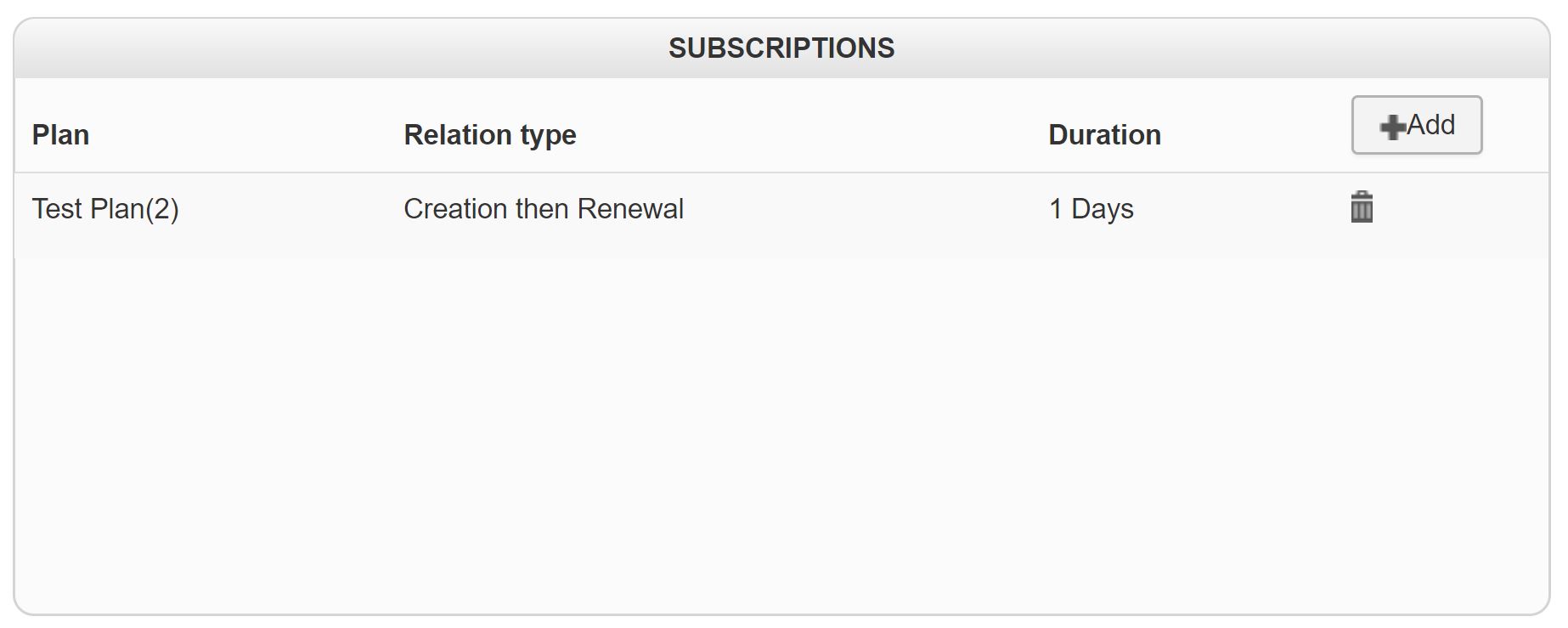

I have attempted to follow the HikaSubscription documentation and I have only been able to create a daily subscription that expires in 1 day. I have used the "Creation then Renewal" plan relation, but what happens is the subscription expires in one day without a recurring renewal.

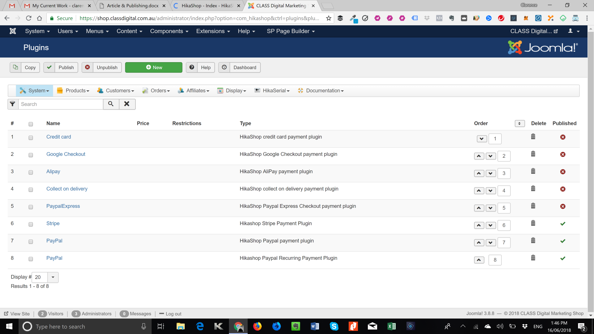

I have found and activated the PayPal recurring plugin via Payment Methods as instructed. However, the same problem remains.
Can you please investigate my website? See attached for reference. None of my plans are recurring.
Thank you.

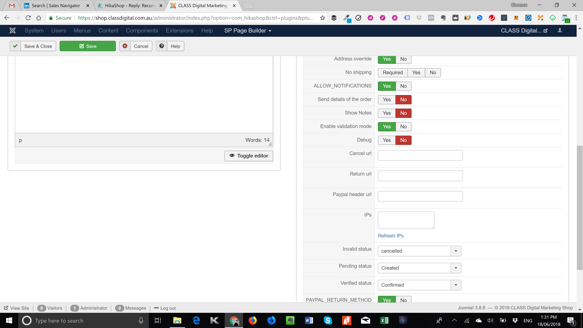

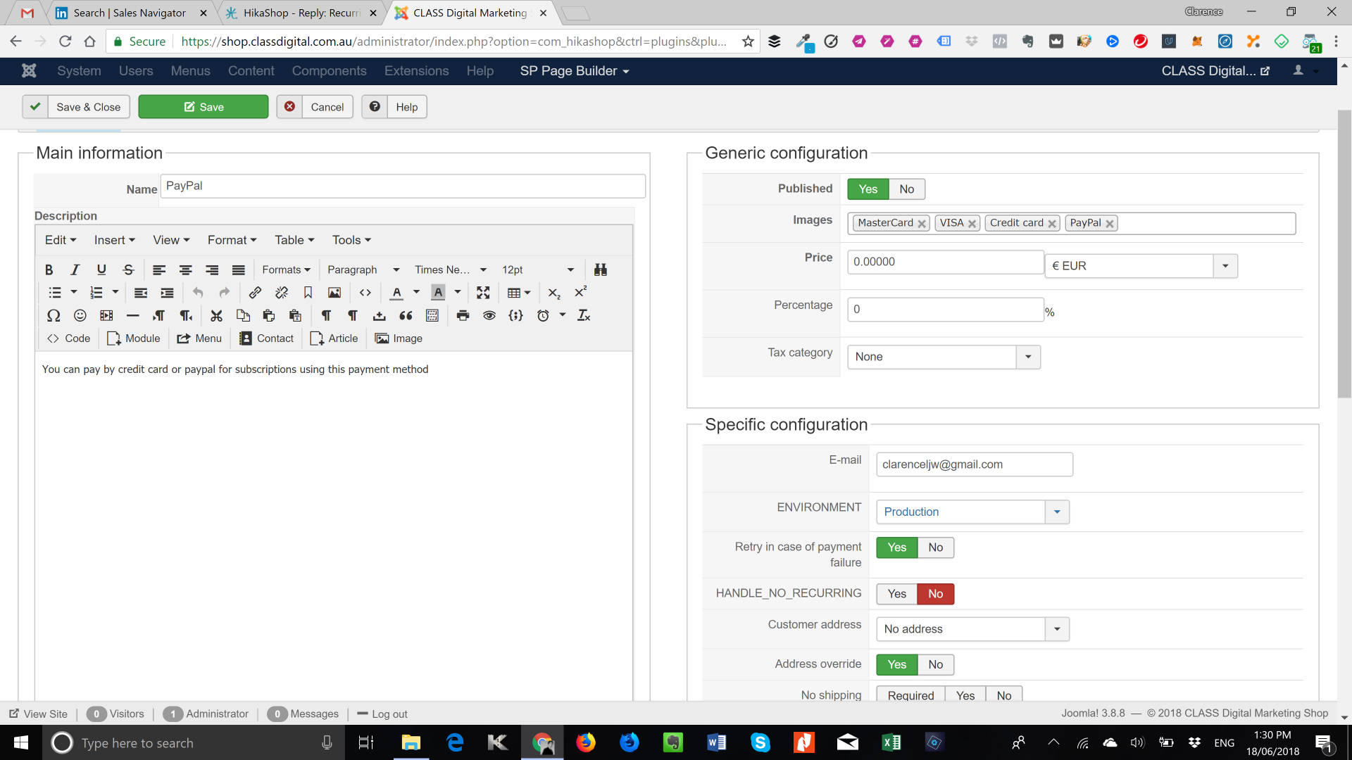

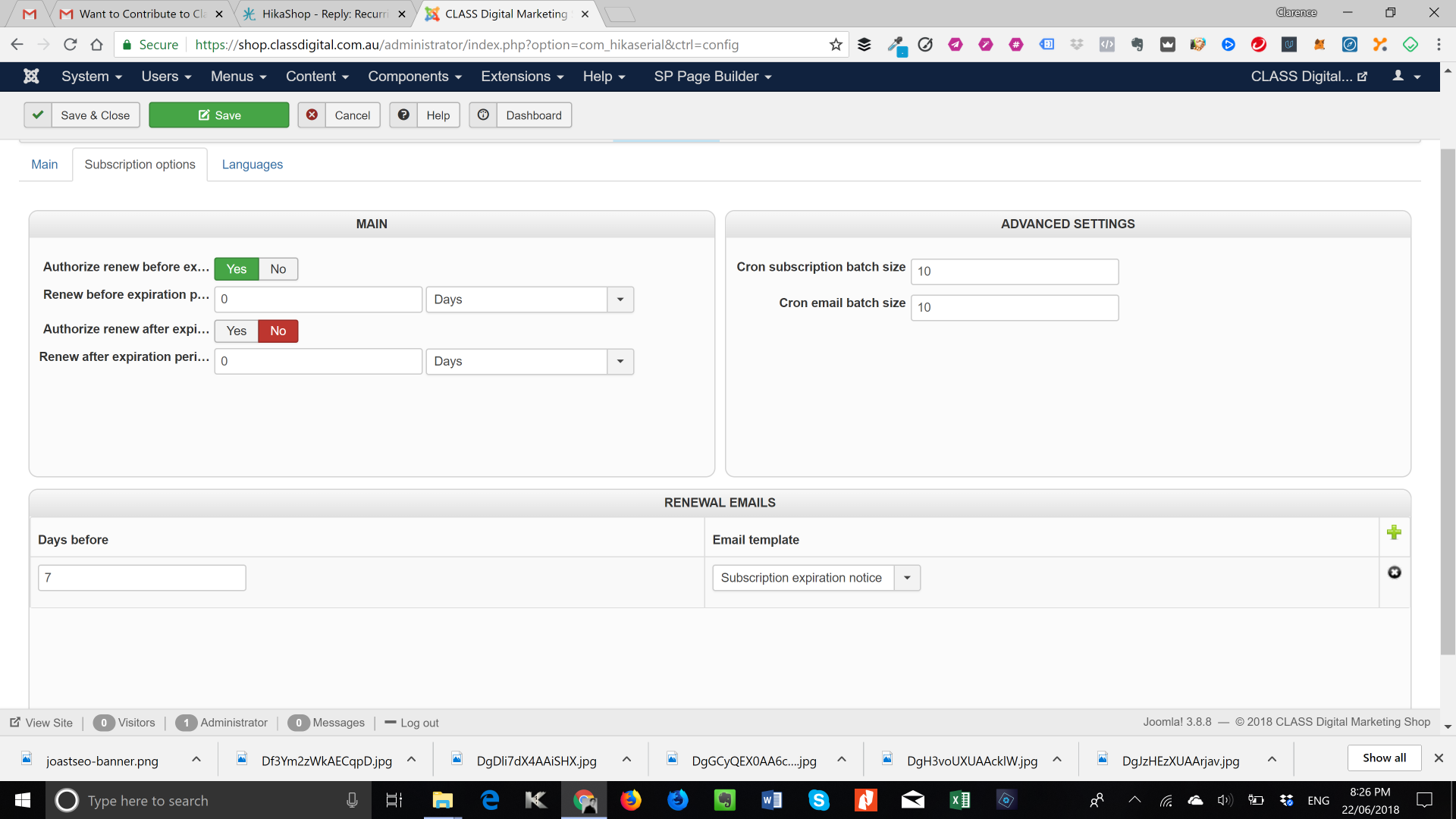

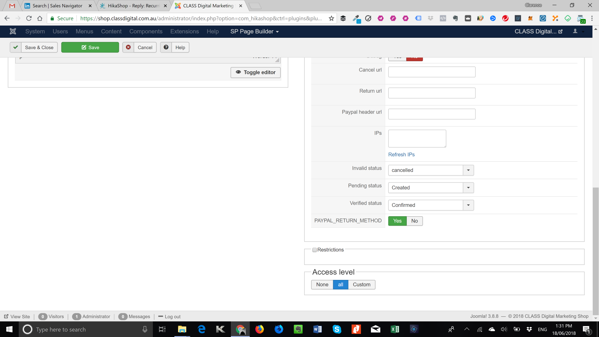

I am sorry I am taking so much time, and I want you to know I appreciate your help. I want to cooperate with you to fix these issues. Attached are photos with the settings for my PayPal recurring plugin, which I have activated with your help.
Please let me know if I am doing anything incorrectly. What are the optimal settings for the PayPal recurring plugin?
I look forward to your assistance. Thank you.

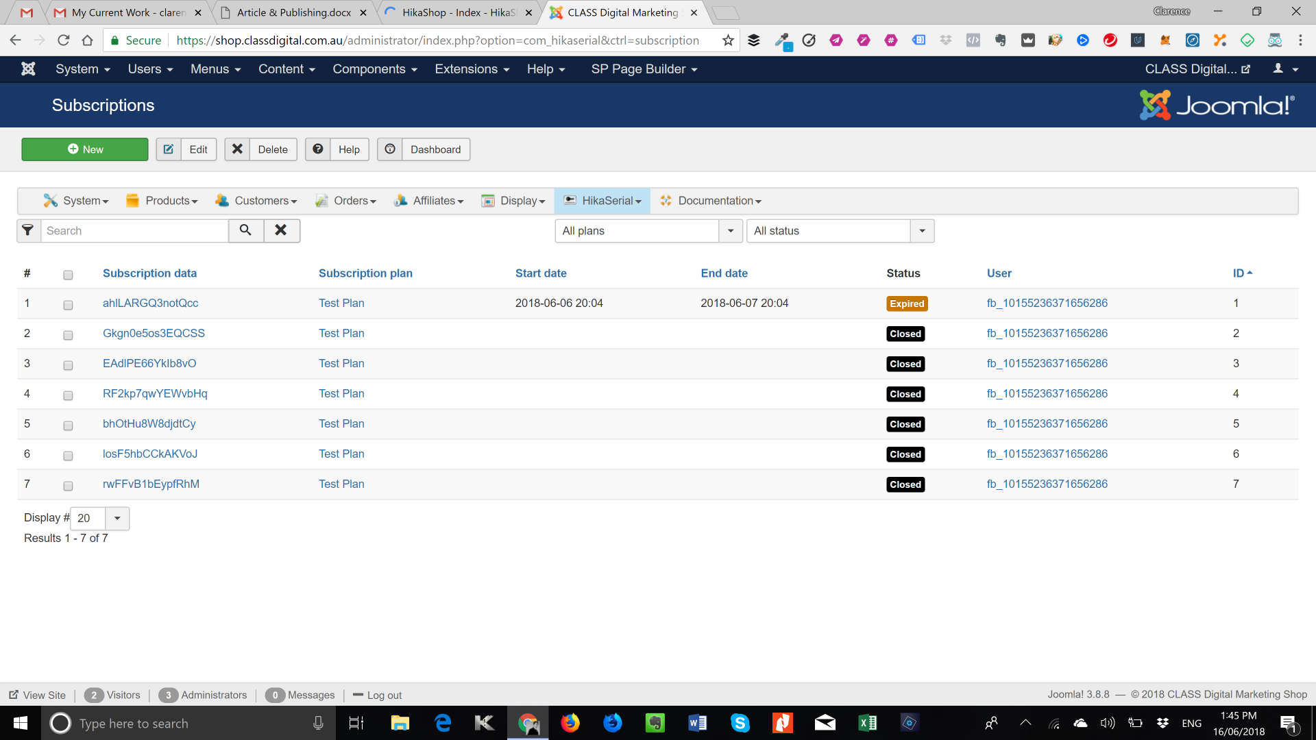

I'm sorry but it's still not possible to understand if you are right using "paypal recurring" during the checkout.
Please read carefully my previous message.
More than that, if you take a look at your subscription listing screenshot, you can see that only one subscription was really created (on 06/06), all other are just pending subscription where the order never been confirmed (otherwise you would have a start and an end date).
Since you just have one old subscription which haven't been renewed but you weren't using Paypal recurring that time (you activated the plugin several days afterwards) ; I don't have the impression that your issue is really the recurring.
Anyway, I do understand that you want to help and provide details but the paypal recurring screenshots are unfortunately not relevant with what I was asking you in my previous message.

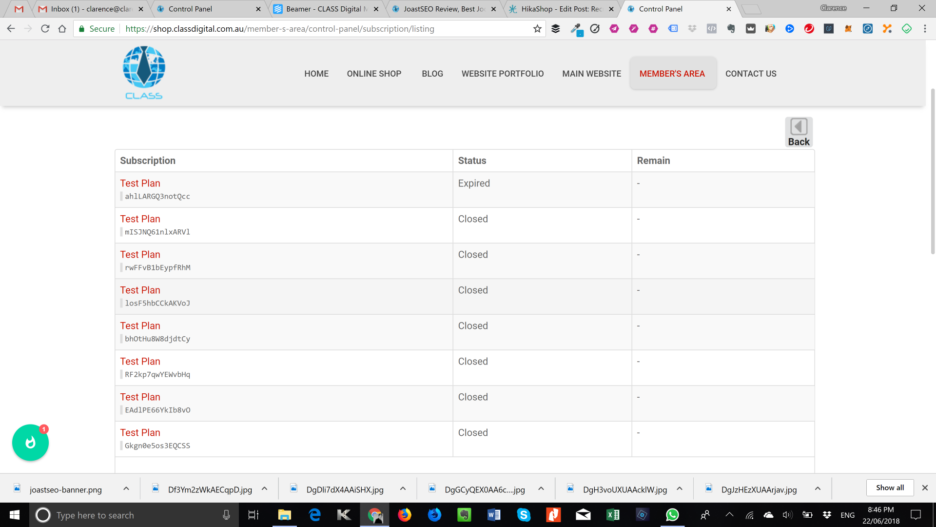

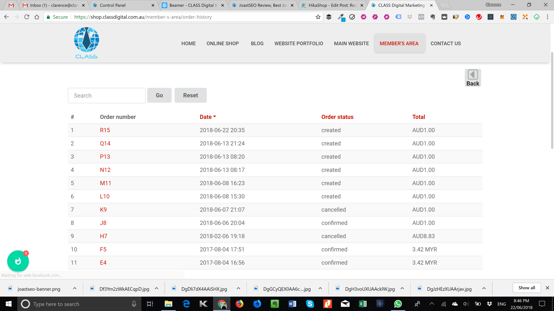

Details of the problem:
Despite creating a subscription plan, one 1 day and another 1 month using "create then renewal", with the PayPal recurring plugin activated, all my subscriptions expire after the term, e.g. 1 day. There is no recurring.
I also notice that subscriptions are not confirmed despite being created. I made these purchases via PayPal, see attached.
I hope this will help you assist me, please let me know if you require any more information. Thank you.

Your order never been confirmed, never been paid.
So your subscription never been active.
That's sure that they won't be renew since they are not paid.
