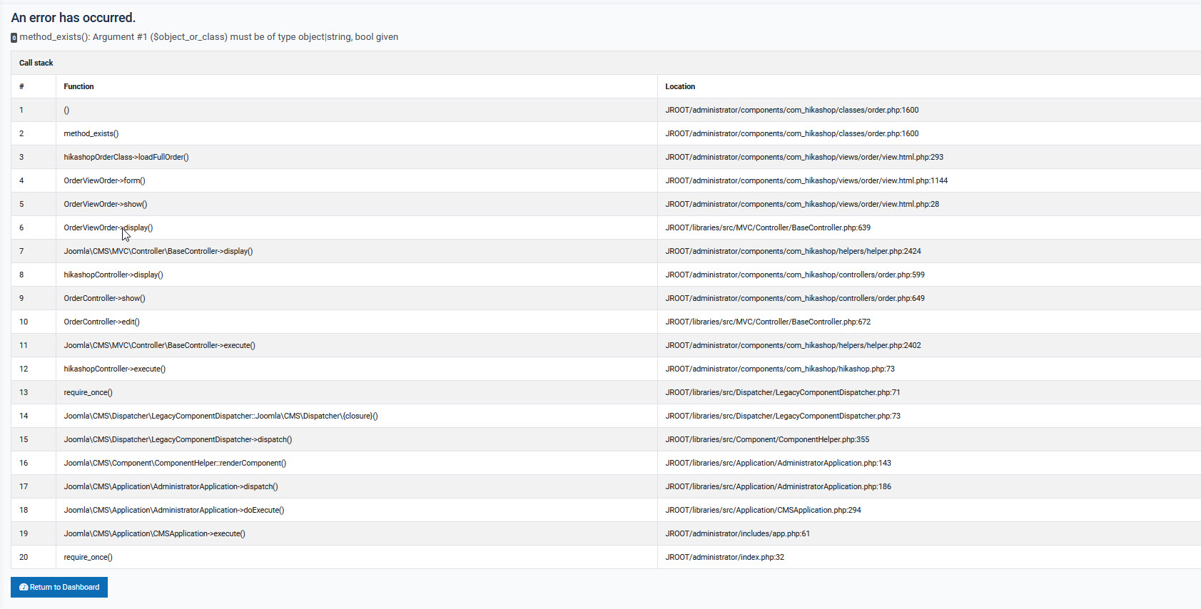

I have migrated my website from VM to Hikashop and the orders go wrong.
When i open a migrated VM order in Hikashop i see this error.
Attachment not found

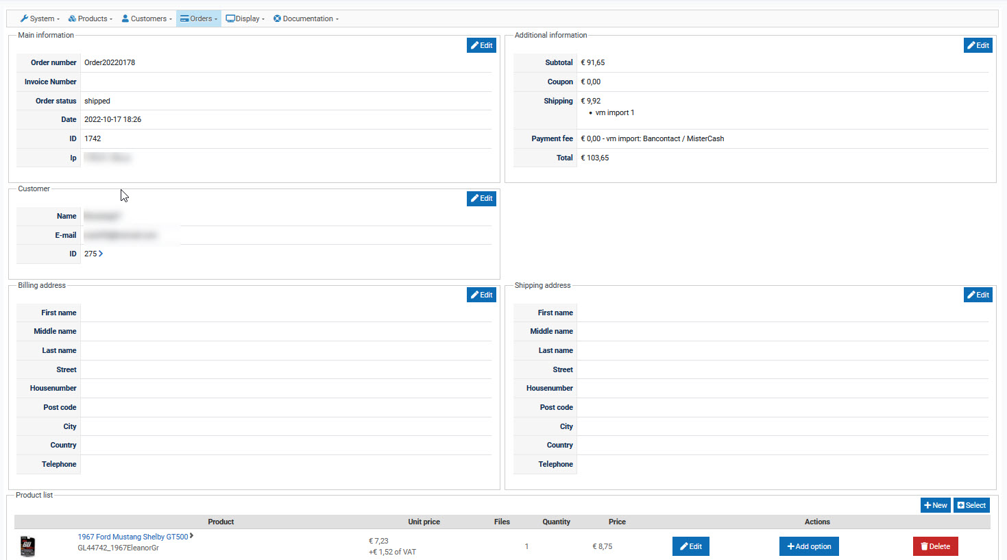

When i switch my hosting back to PHP7.4 i see the order, but all address-fields are empty.
All address-fields are empty in all orders (with registered users and guest users)
But the address-fields in the users-view are filled correctly.
Can you see what's wrong?

Regarding the error, it happens because the shipping method of the orders is not available in HikaShop and PHP8 is strictier than previous versions with checks. I've made some patches on our end to avoid the error. Download again the install package of HikaShop on our website and install it on your website and you'll get the patch.
Regarding the addresses missing, we had two person report a similar problem 6 years ago which lead to us adding some patches in the import, fixing the problem:
www.hikashop.com/forum/import-export-csv...ddresses/230518.html
So first, it will require diving in the database to check the situation with the import of the addresses, the import of the users.
If you could check what is written on that other thread and report back, it will allow us to better understand the situation.

I changed the code:
"INNER JOIN `".$this->vmprefix."virtuemart_states` vms ON vmui.virtuemart_state_id = vms.virtuemart_state_id ".
"INNER JOIN `".$this->vmprefix."virtuemart_countries` vmc ON vmui.virtuemart_country_id = vmc.virtuemart_country_id ".
to:
"LEFT JOIN `".$this->vmprefix."virtuemart_states` vms ON vmui.virtuemart_state_id = vms.virtuemart_state_id ".
"LEFT JOIN `".$this->vmprefix."virtuemart_countries` vmc ON vmui.virtuemart_country_id = vmc.virtuemart_country_id ".
And everything is fixed.
Thank You!
