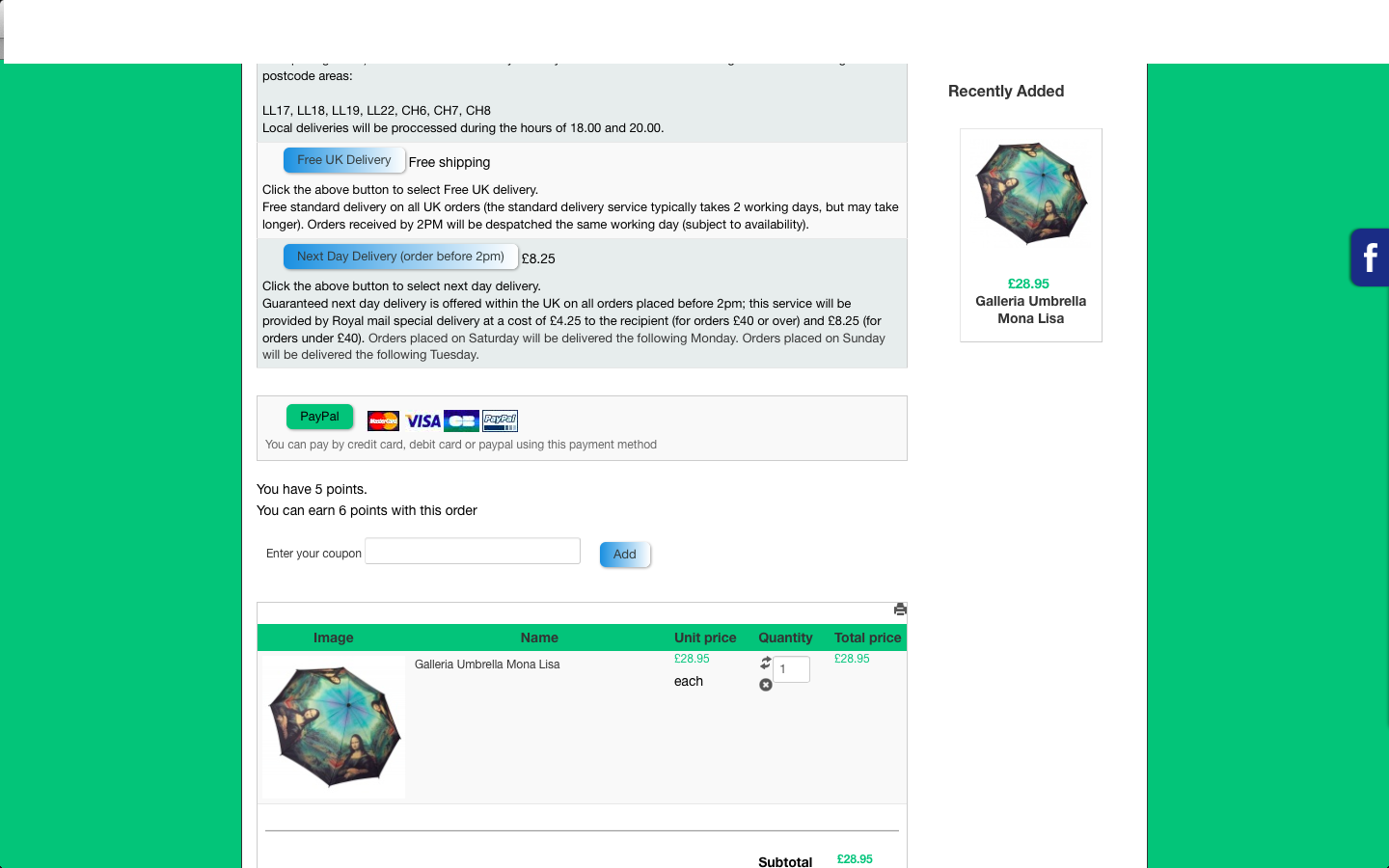

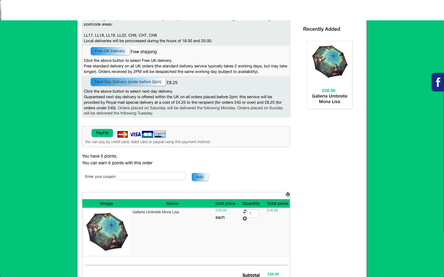

Im looking at using Alpha User Points as a loyalty points scheme on my website. I've come across some problems setting it up.
1) I've set it up as a payment method and selected the option to "Give Points on Status's: 'Confirmed'", but it applies a discount on the current order instead.
2) I believe that I have set it up to give 1 point for every £5 spent, but I dummy purchased an item for £28.95 and it gave 6 points. Does it round up?
3) Can I make it optional to sign up to the Loyalty Scheme as part of the registration process?

As an update:
1) Sorted :blush: sorry about that!
2) I still want to find out about the rounding up
3) Is there any way that during the purchase there can be a message 'You will earn 5 points on this purchase, 1 Point = £1 off your next purchase''

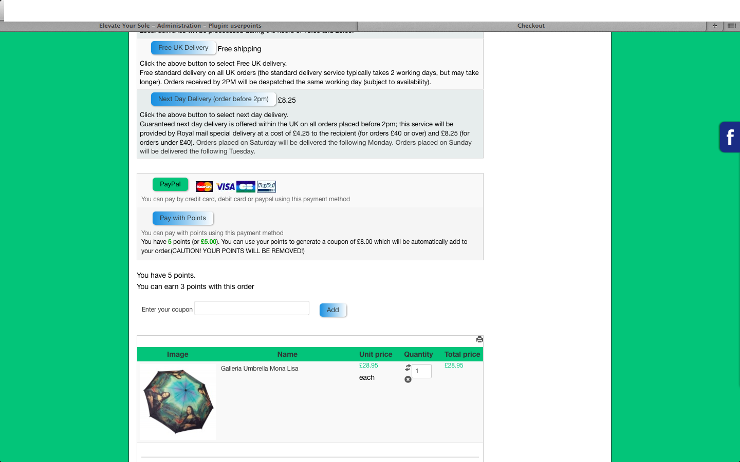

  • Posts: 265
11 years 11 months ago #171940
Thanks for your reply.

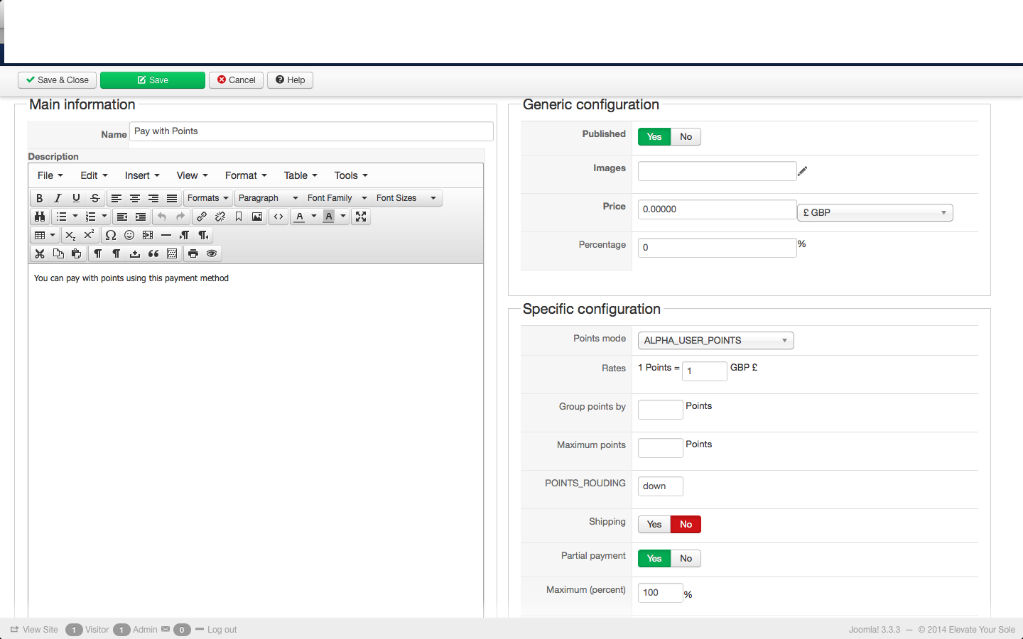

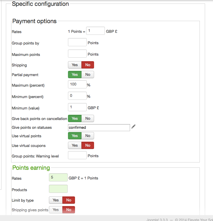

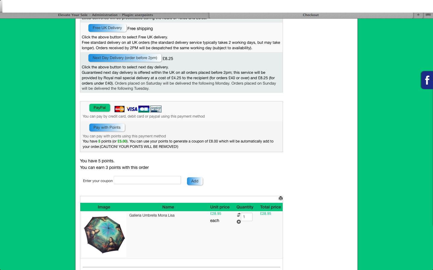

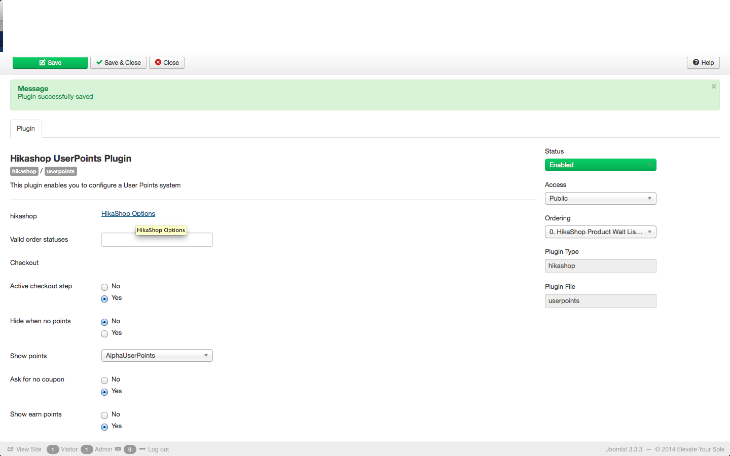

I think I am missing something though, I can't find a way for it to be accepted as a payment method, theres no option in the checkout to use the points i.e. no payment method as in the old plugin. The points are still not rounding down as well...
I've attached some screenshots to show the backend setting and frontend.

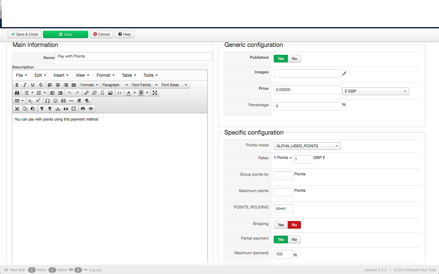

11 years 11 months ago #171948
You're using the option : "Use virtual coupon".
This option is to use a virtual coupon mode, to not have a payment method in the payment listing.
  • Posts: 265
11 years 11 months ago #171997
Thanks for the reply,
I have changed that, but its still not available as a payment option.

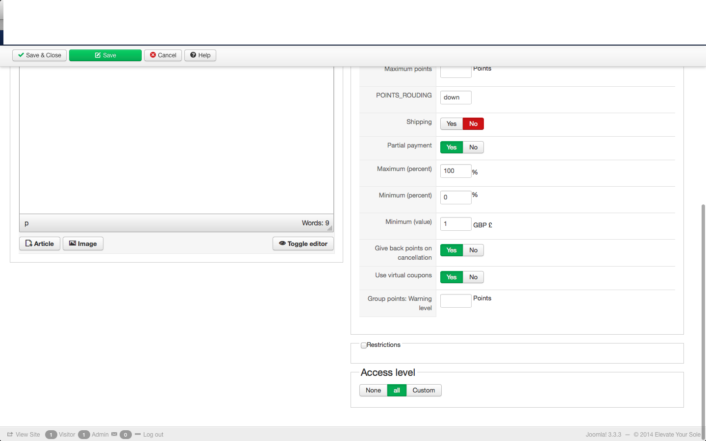

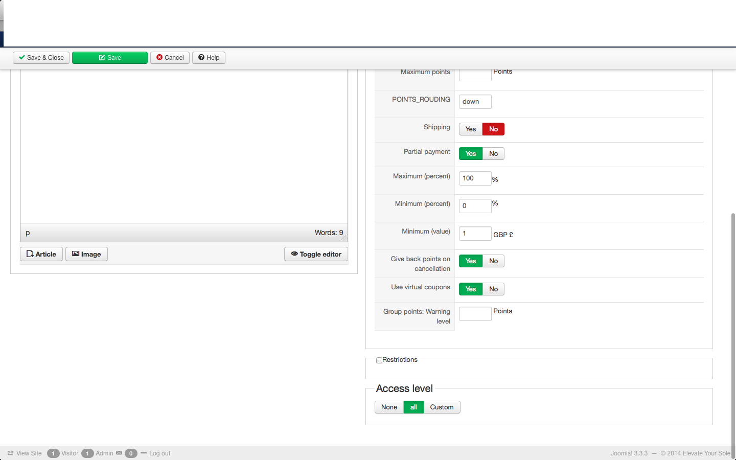

11 years 11 months ago #171998
Try to remove your "down" for the option "rounding".
This fields requires a number, not a string.
  • Posts: 265
11 years 11 months ago #172019
Brilliant,
Thats done the trick for the payment option.

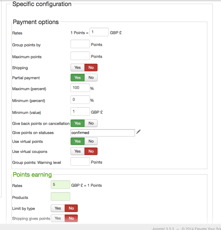

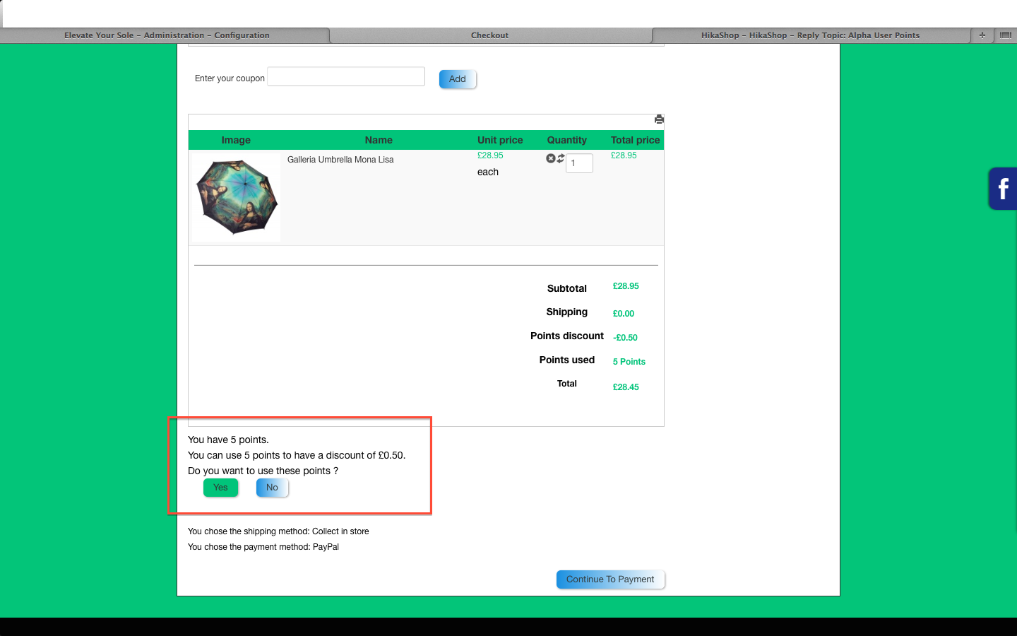

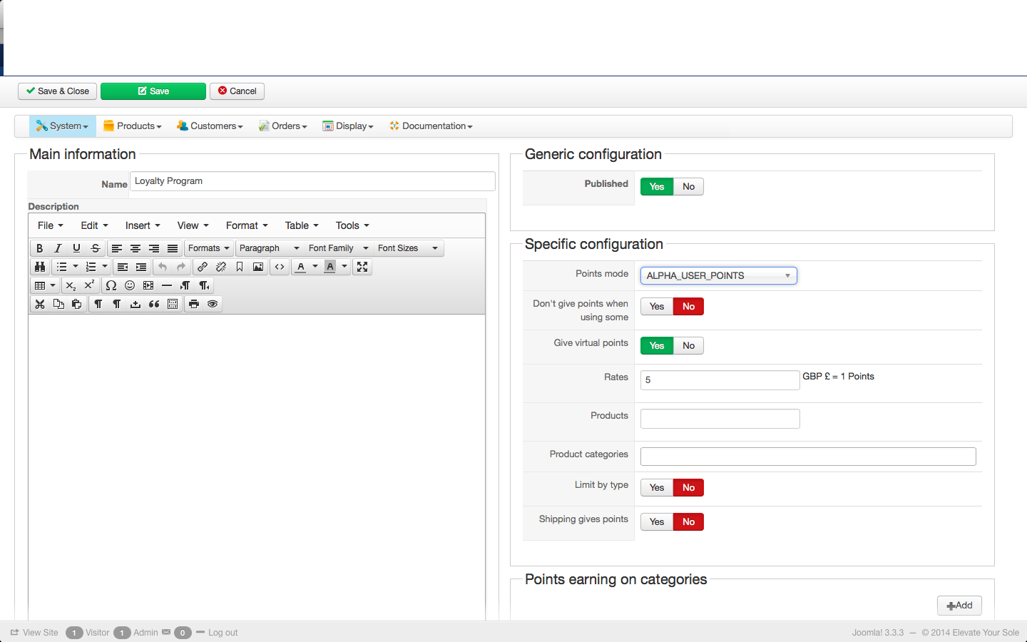

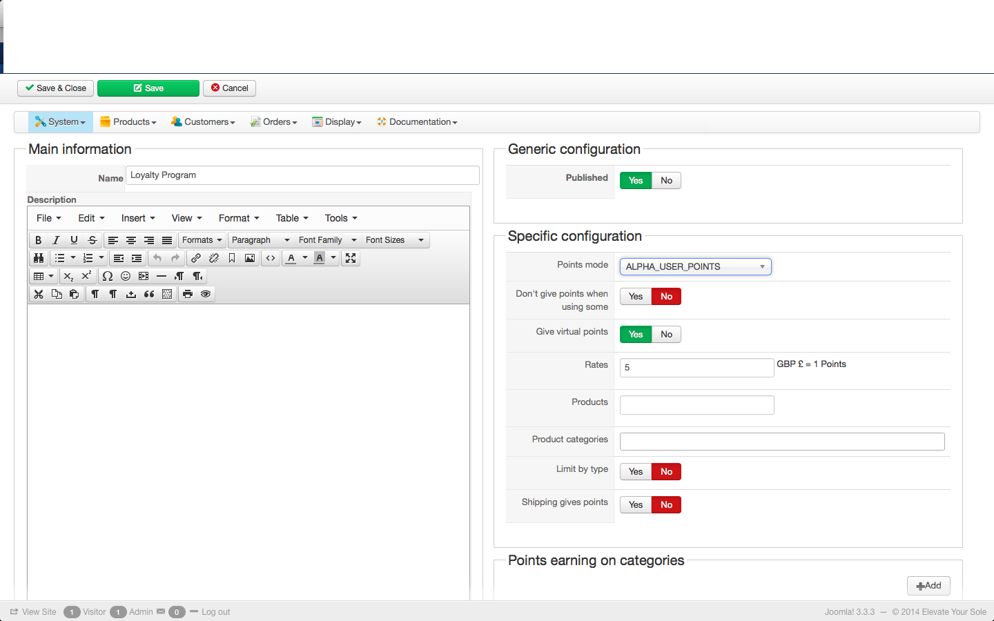

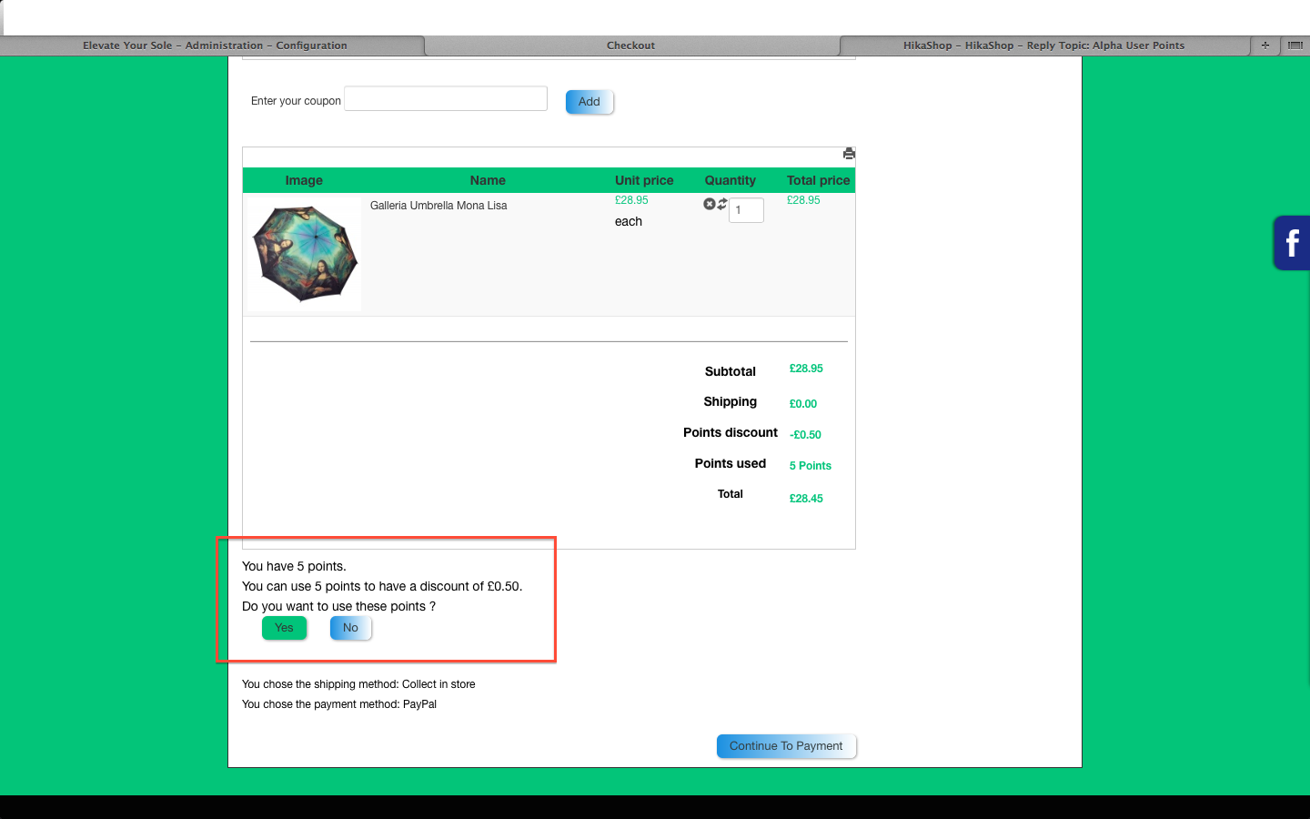

However, I do have a similar problem that I had with the old plugin.
Please see attached screenshot. Even though it recognises that the customer has 5 points to use that equal £5. For some reason it wants to add the earned 3 points to the current order making a total of £8 discount. I want that £3 to be used on the following order.
11 years 11 months ago #172020
Your "earn points" configuration is, completely opposite of what you want.
"Give virtual points" : no
"Don't give points when using some" : yes
The default configuration when the plugin is right, I do not understand why yours is the opposite.
The following user(s) said Thank You: Holmes-Pierce

Thanks for clearing that up for me.
Could you tell me how I can change the text on this screenshot please?
