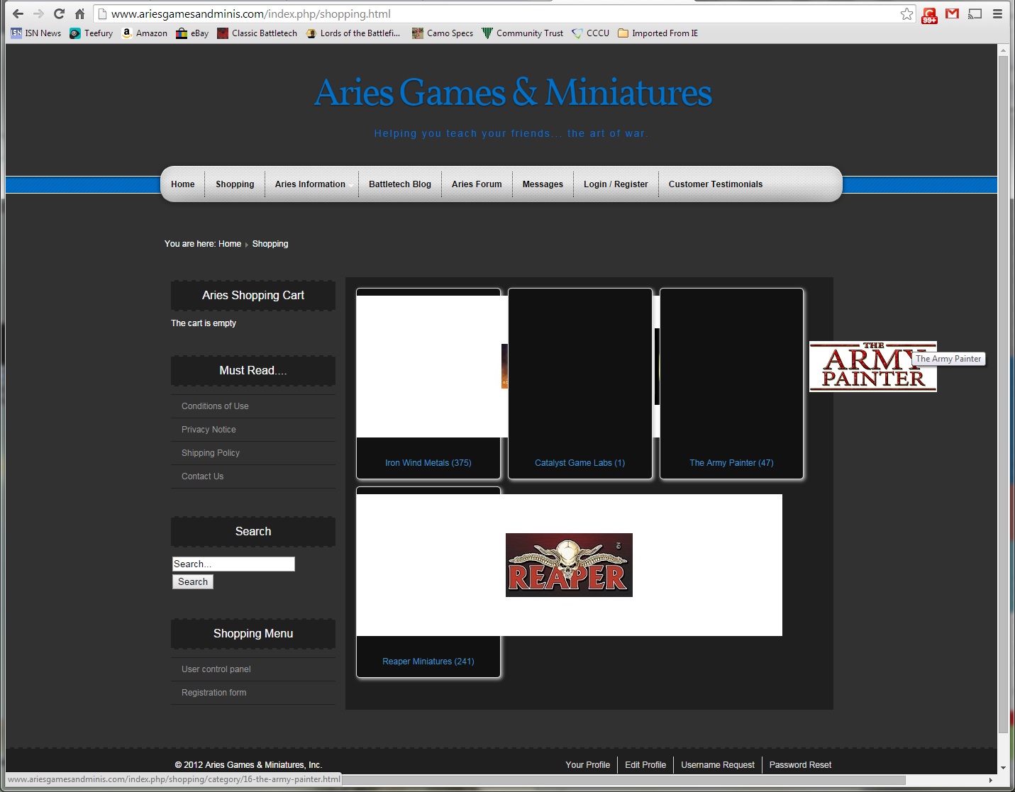

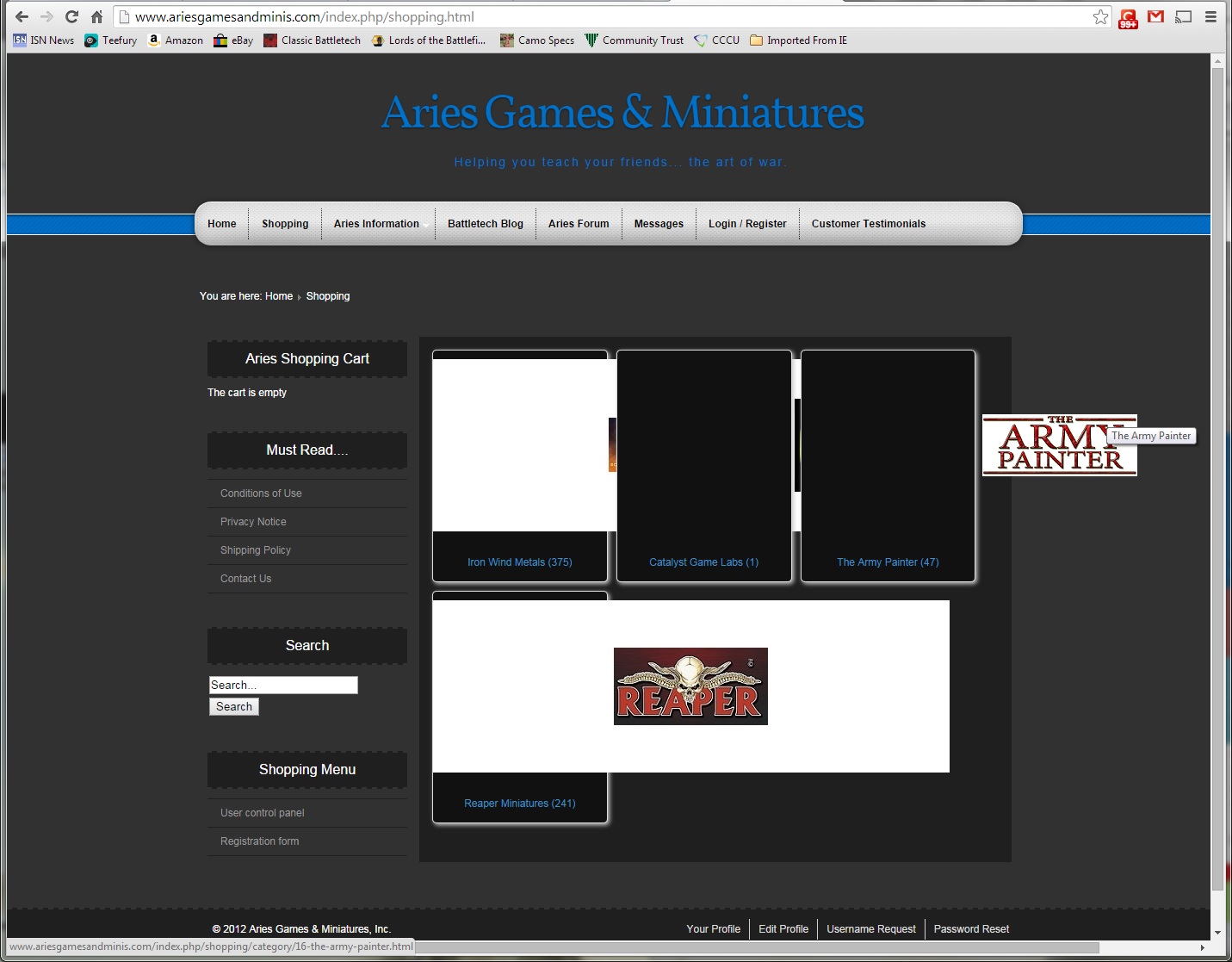

RESOLVED - #2 - I went to check my site to make sure it's working, and on the front end the category displays are all messed up now as shown in the "Category Display" image attached.

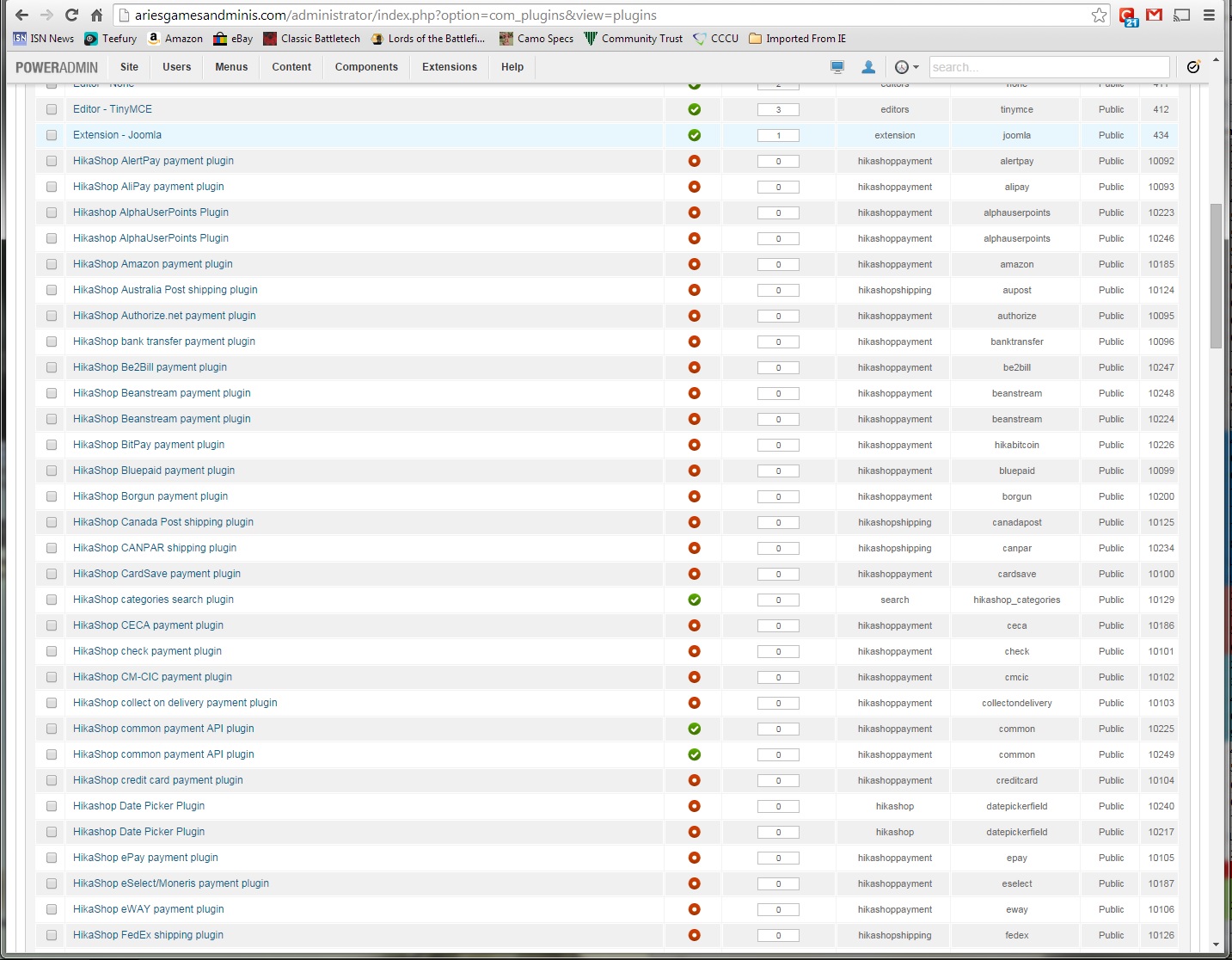

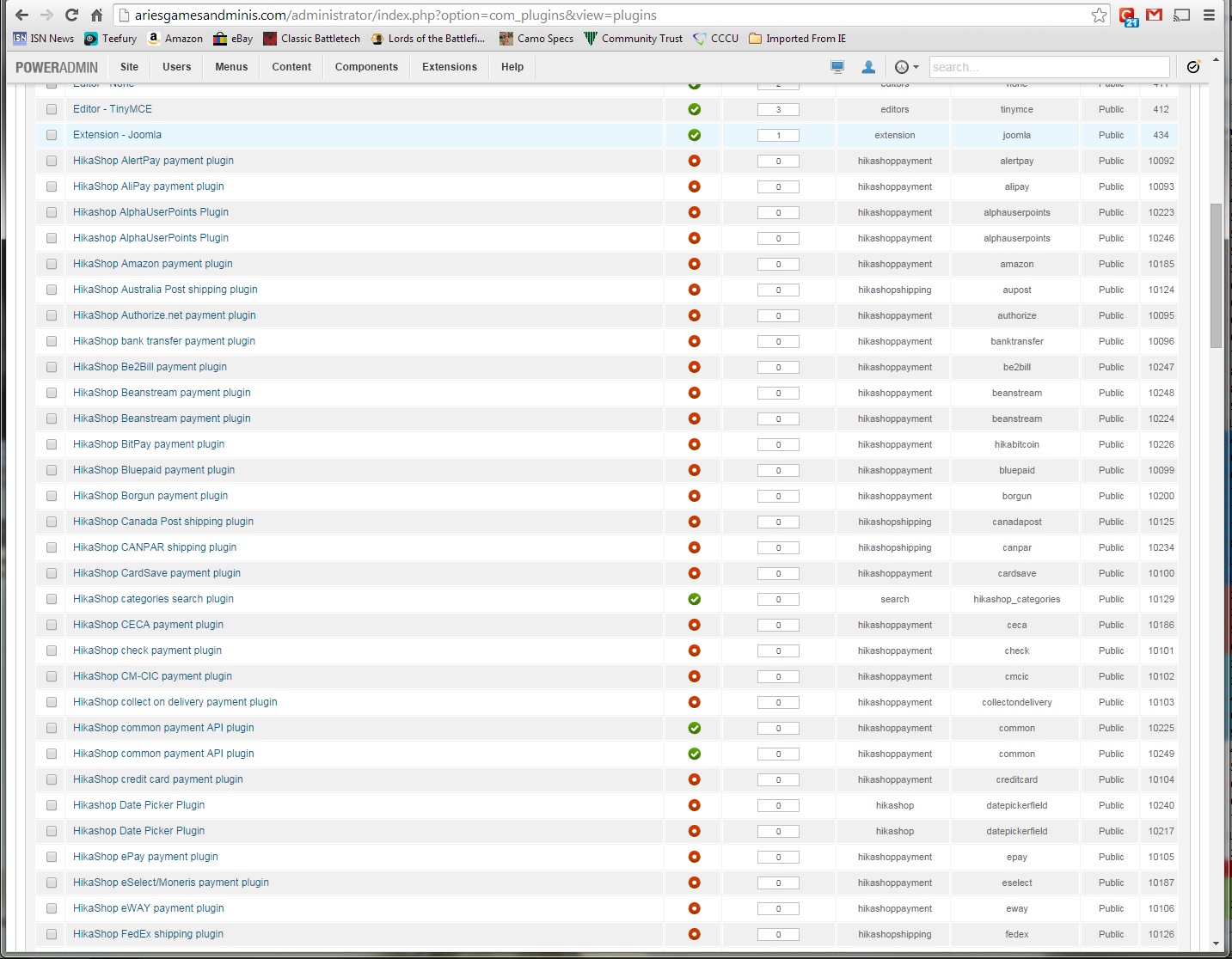

#3 - Also, now I checked in the Plugin Manager...and I've got NUMEROUS duplicate entries now for HikaShop as shown in the "Duplicate Entries" image attached.

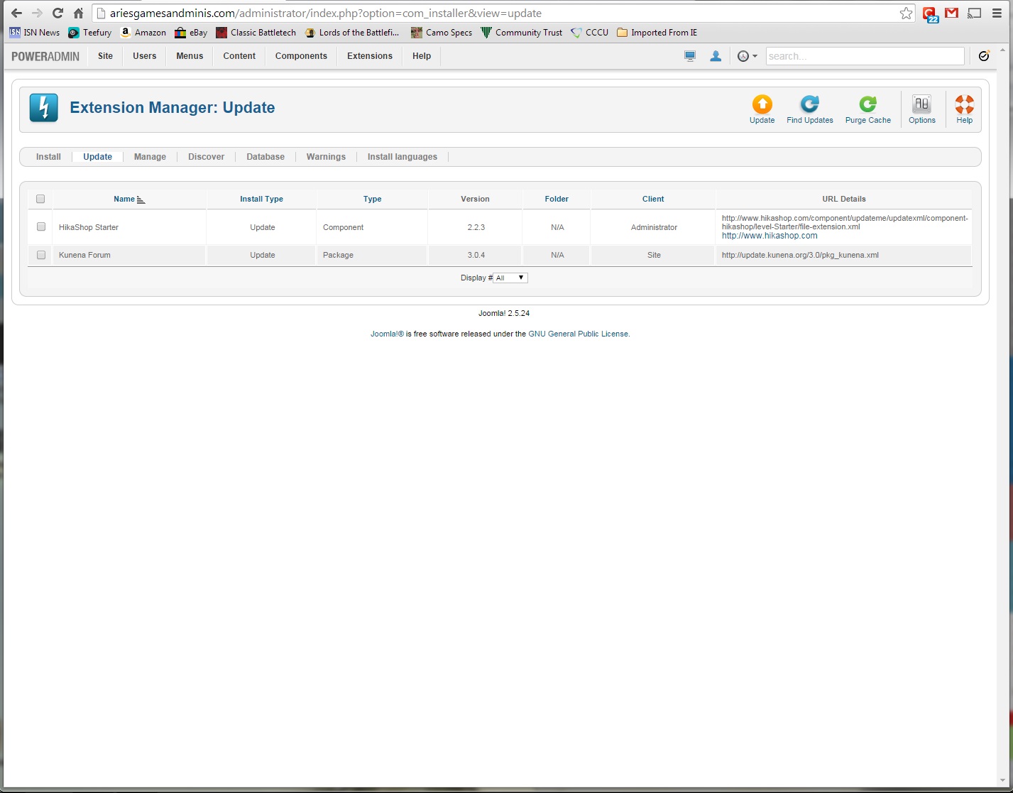

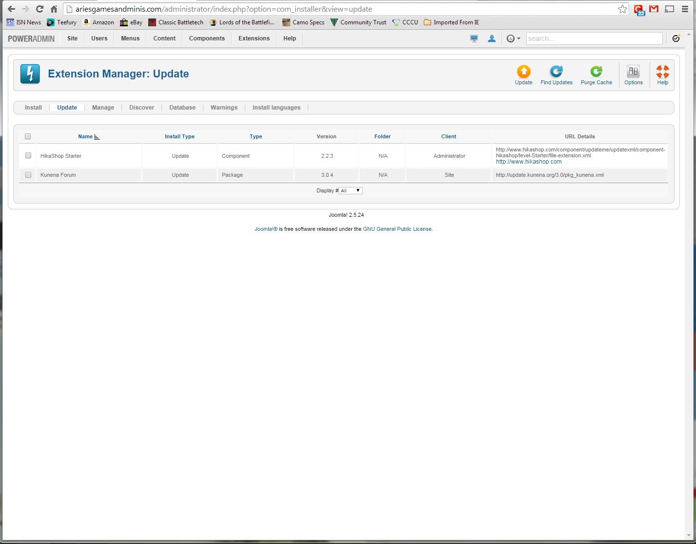

#4 - And to make things even more troublesome for me...the Extension Manager Update shows that HikaShop Starter needs to be updated.

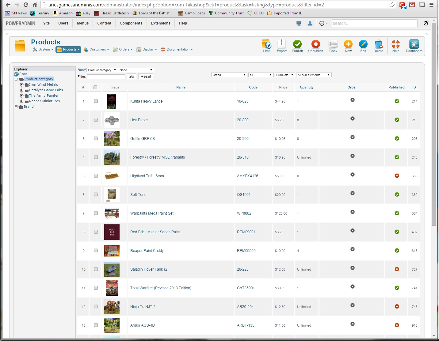

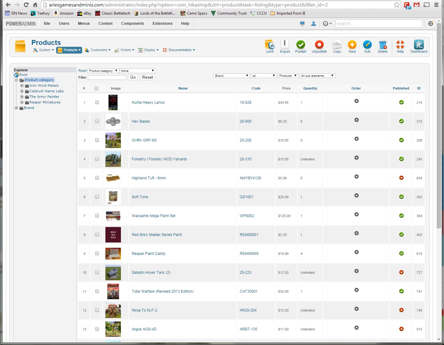

RESOLVED - #5 - Lastly...now, in the Product Category display on the back end under "Products" it shows ALL my items in the sub folder "Product Category" and continues to show all products until I drill in to other sub folders as shown in the "Product Categories Display" image attached. Is this supposed to be like this? In Starter, it was not like this.

EDIT - 09/26/2014 Numbers 2 & 5 have been resolved. Still need help on Numbers 1, 3, and 4.

Ok...I was able to figure out #2 and corrected it...but now images have white borders. I'll try to figure that out as well, but if someone knows I'd appreciate some help.
  • Posts: 713
  • Thank you received: 37
11 years 11 months ago #172726
Ok, I've figured out the white borders as well...have to use .PNG images for the transparency.

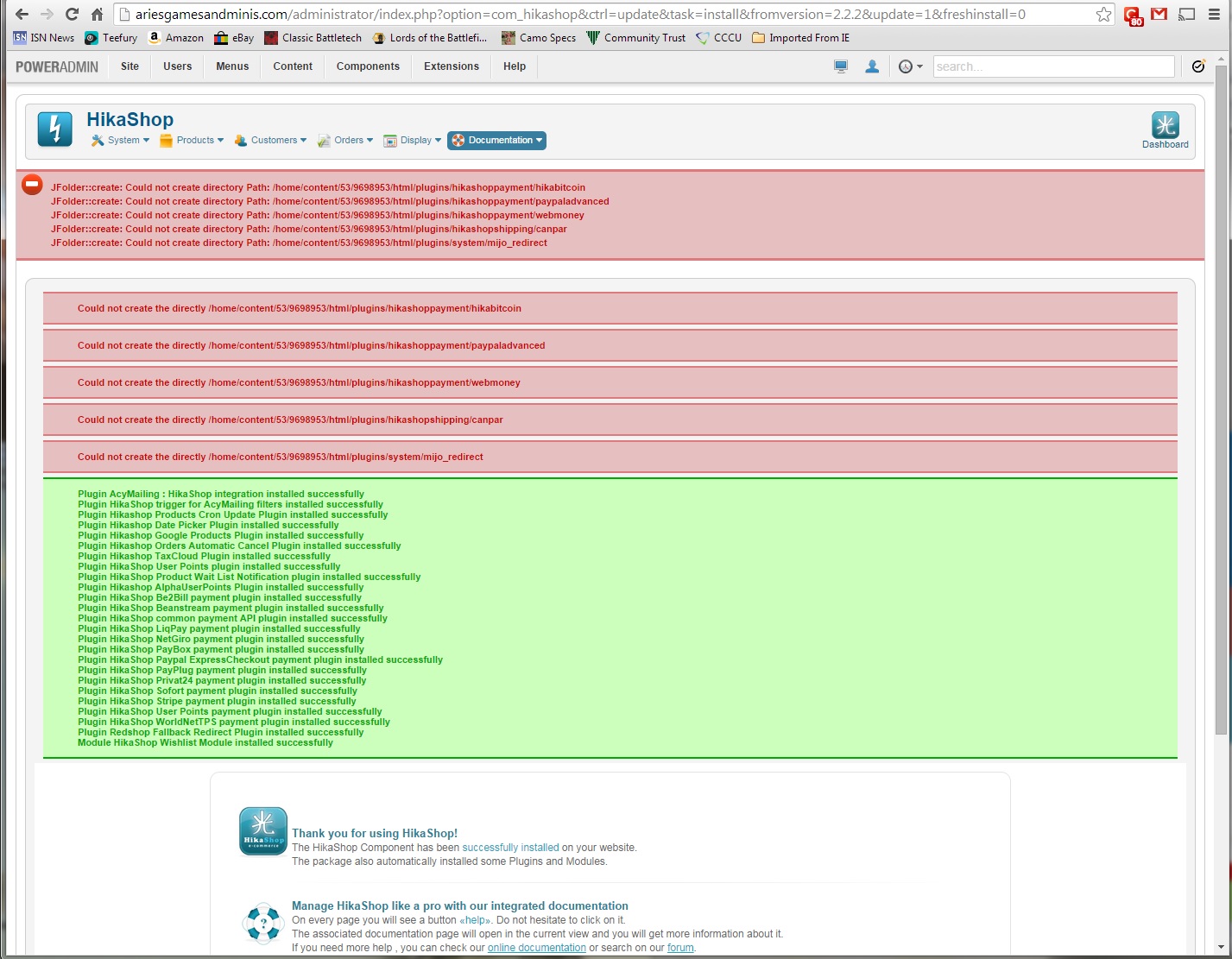

1. The tar.gz file is smaller in size but the compression require more CPU for the extraction.
The install generally check if the plugin already exist before install it ; in your case it looks like some plugin couldn't been found by HikaShop which generate the duplication trouble.
More than that, it looks like you have some folder permission issue because HikaShop was not able to write folders for the new plugins. This folder permission can be the source of the duplication.

You can unpublish one of the duplicates plugins. But if you try to delete one, it will delete the fields and the other won't work anymore. So if you want to clean it, the best is to remove the entries directly in the database.
4. You need to go in the HikaShop configuration to let HikaShop set the correct url for the joomla update.

#3 - Removing the entries from the database sounds a bit higher than I know how to do. Could you point me in the right direction so I can see if it's something I can handle? Is there no way to uninstall HikaShop Starter without messing up HikaShop Essentials and/or causing mass devastation on my online webstore?
If I can only unpublish those duplicates, is it safe to assume that the ones with the higher ID number is the newer one. If so, I should unpublish the ones with a lower number in the ID field correct?
#4 - I'm in the configurations screen, and I've checked each section, but I don't see anything related to the "updating" of HikaShop Starter or Essentials. Where is it?
#5 - Originally in HikaShop Starter, the category that is selected in the image "Product Categories Display" had no products showing in it. Now since updating to HikaShop Essentials, it shows a listing of ALL the products from ALL the sub folders. Only until I go all the way in to the various sub folders does it show the correct product for that sub folder.

More than that, the "auto update" url is set during the install, in your case it's not. So I think the install did not finish clearly.
When you go in the HikaShop configuration, we have a check which should check the server name and fix the "auto updater" url. So just by displaying the HikaShop configuration, you can fix the "auto updater" url, in some cases.
The plugin can't be really duplicate in the way that the files exist just one time.
So you can just unpublish the duplicate entries in your Joomla manager.
If you not confident enough to use "PhpMyAdmin" and remove entries directly in your database, the best is just to unpublish the plugins and does not touch the database.
For your point 5, it's just that you selected the filter "All sub elements".
It's the last dropdown in your screenshot (top right). Just switch it to "direct sub elements".
This problem is not related to the update or starter/essential ; it is something you have modified manually (and which is stored in the user session).

Also...for the plugins...which ones of the duplicates should I disable? The higher ID number or the lower ID number? Lower correct?

About the duplication, you can unpublish the higher or the lower ID number ; there are the same. The idea is to unpublish all "lower" or all "higher" so you have something homogeneous.

Thanks for the tip on the duplicate entries, I will set all the lower ones to disabled.

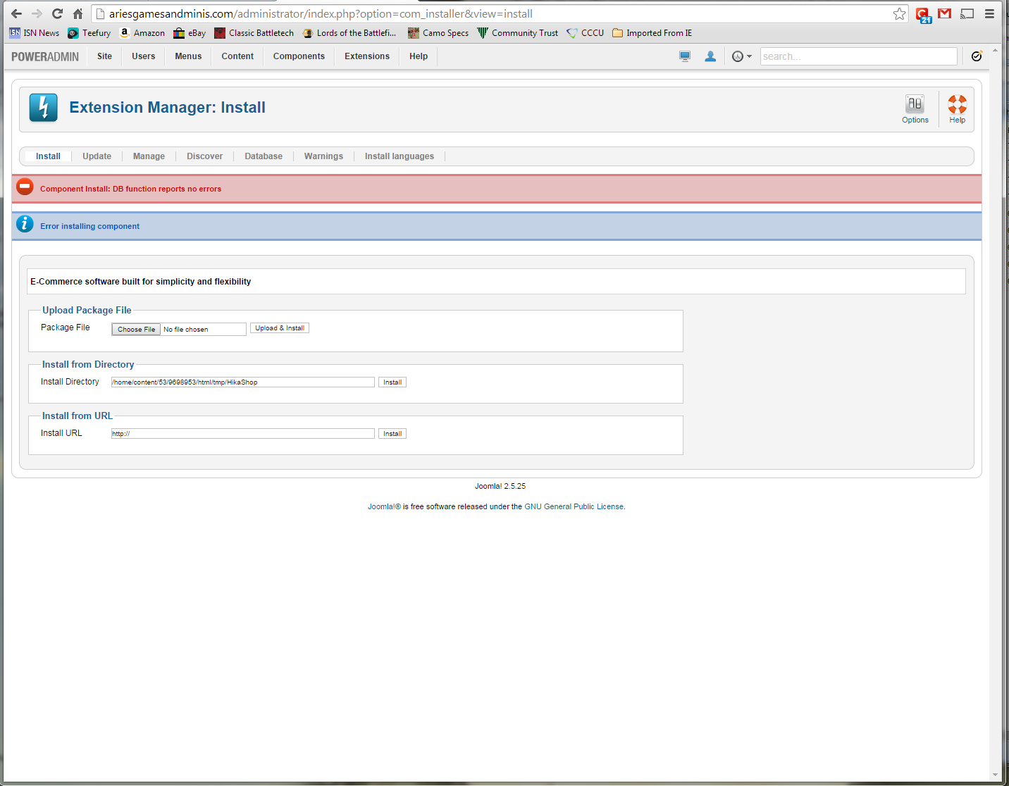

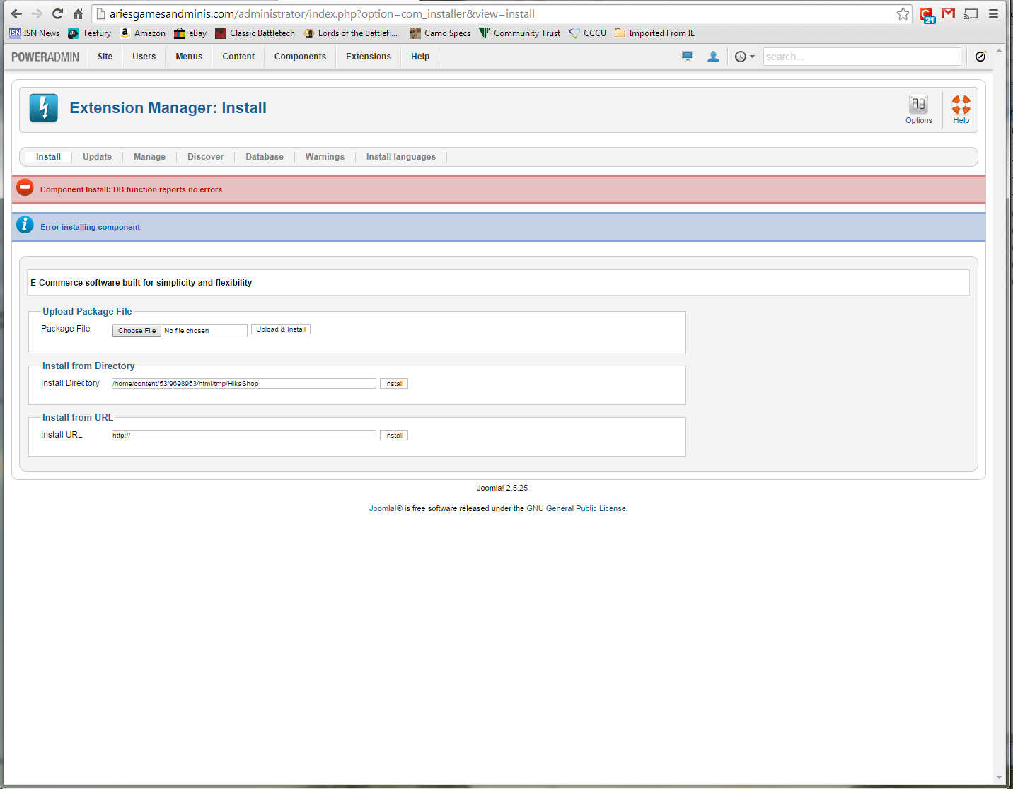

Ok, I've downloaded, unpacked, and uploaded the newest version of HikaShop Essentials v2.3.3 to my FTP, then I installed from the FTP file as instructed, no errors this time around...but, I still have the duplicate entries & Joomla still wants to update HikaShop Starter...so it must not be seeing Essentials.
What else can I do to fix this?
  • Posts: 86094
  • Thank you received: 14197
11 years 11 months ago #173221
Then it would indicate a file permission issue preventing the joomla installer from copying all the files of the package. Rename the administrator/components/com_hikashop and components/com_hikashop folders to something else and do the install from folder again and make sure that you're using the package of the Essential edition for the install. That will force the Essential edition files to the HikaShop files location and you'll definitely get the Essential edition installed after that.

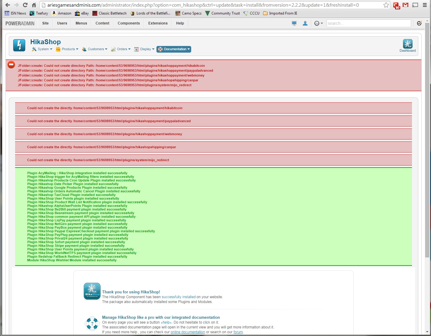

11 years 11 months ago #173313
Ok, I did that, and I got the errors shown on the attached image...also, now my store does not exist as you cannot go to the shopping link. I'd have to assume that is because the folders are not there anymore because you had me re-name them. I went to look for "new" folders from this install, and they don't exist either.

Ok, I just re-tried with a fresh folder full of HikaShop Essentials 2.3.3 from my FTP, and it gave me the exact same errors shown in the image attached above.
I'm renaming the old folders back so my store can be somewhat operational as right now, it's completely down. I need someone to please fix these issues as stated in your Usage description of "Installation guaranteed! If you have any problems installing HikaShop, we'll do it for you."
And I'd like all of my issues due to this bad installation to be fixed as well.
I'm sorry if it seems like I'm getting pissed off, but honestly, I am. I followed ALL of the directions for the install, and I've had nothing but problems, and now my store is being effected because of it. Do you blame me for being mad? I sincerely hope not! I'm not a programmer, I don't write CSS code like some of you guys. I'm just a simple user that needs help due to a bad install.
