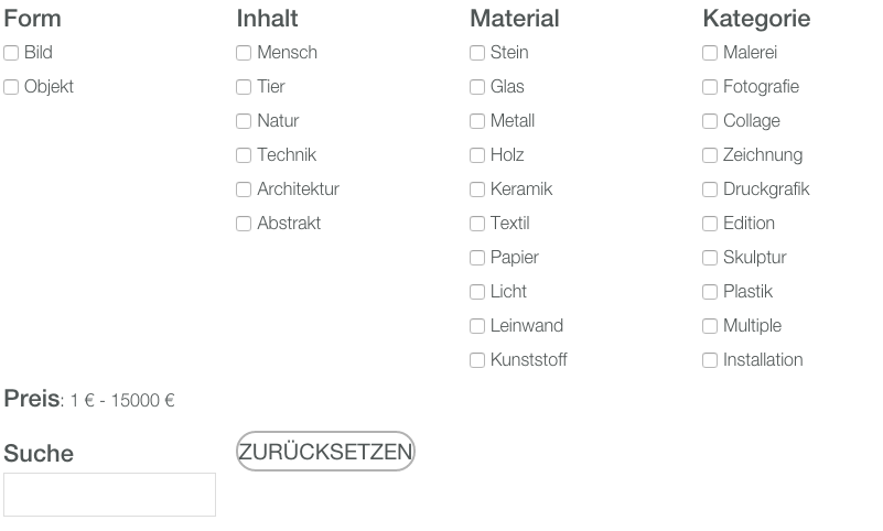

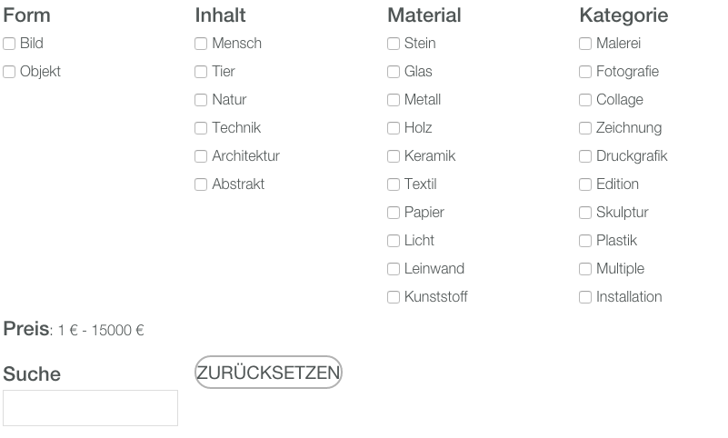

10 years 6 months ago #228990
Hi Jerome,
I have that issue too (please see attachment). But disable the carousel mode that fix that. We had contact in the past about that www.hikashop.com/forum/filters-search/87...iltering.html#174179
the update doesn´t fixed the issue. Can you help me?
THX
