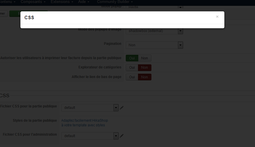

I would like to change some CSS settings but when using System->Configuration->Display->CSS->front/backend->edit, the window is empty.

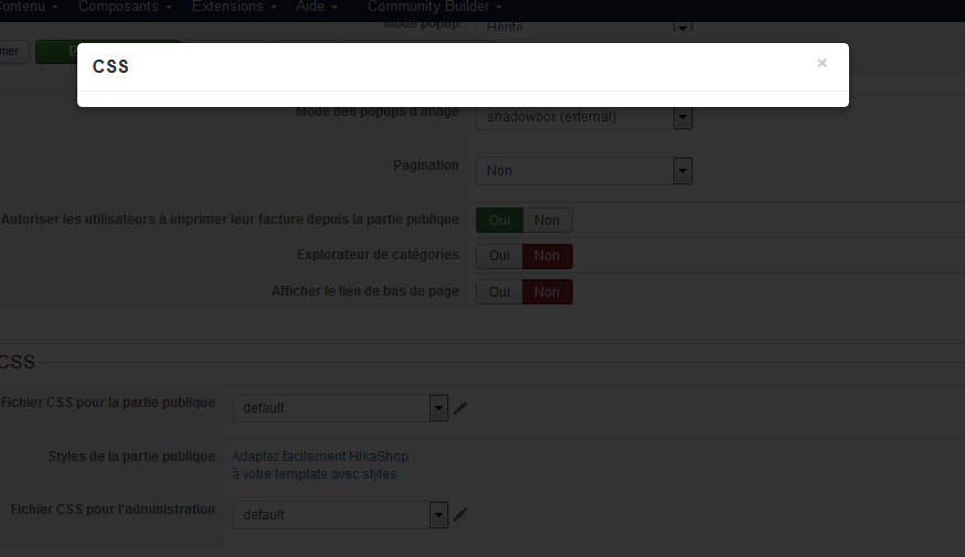

  • Posts: 10
10 years 11 months ago #214187
Hello, Thanks for your answer,
Here is what I get (attached).
I also tried templates beez3 and beez5 for frontend and halthor for backend with no difference.
However it works fine on test site with same configuration.

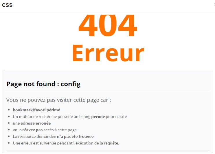

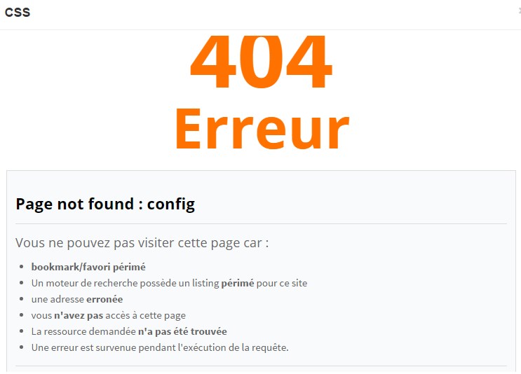

Thank for the tip. The popup now opens but does not open the file and displays an error 404 instead of css.
Same problem to select an image for transport but with error 403
