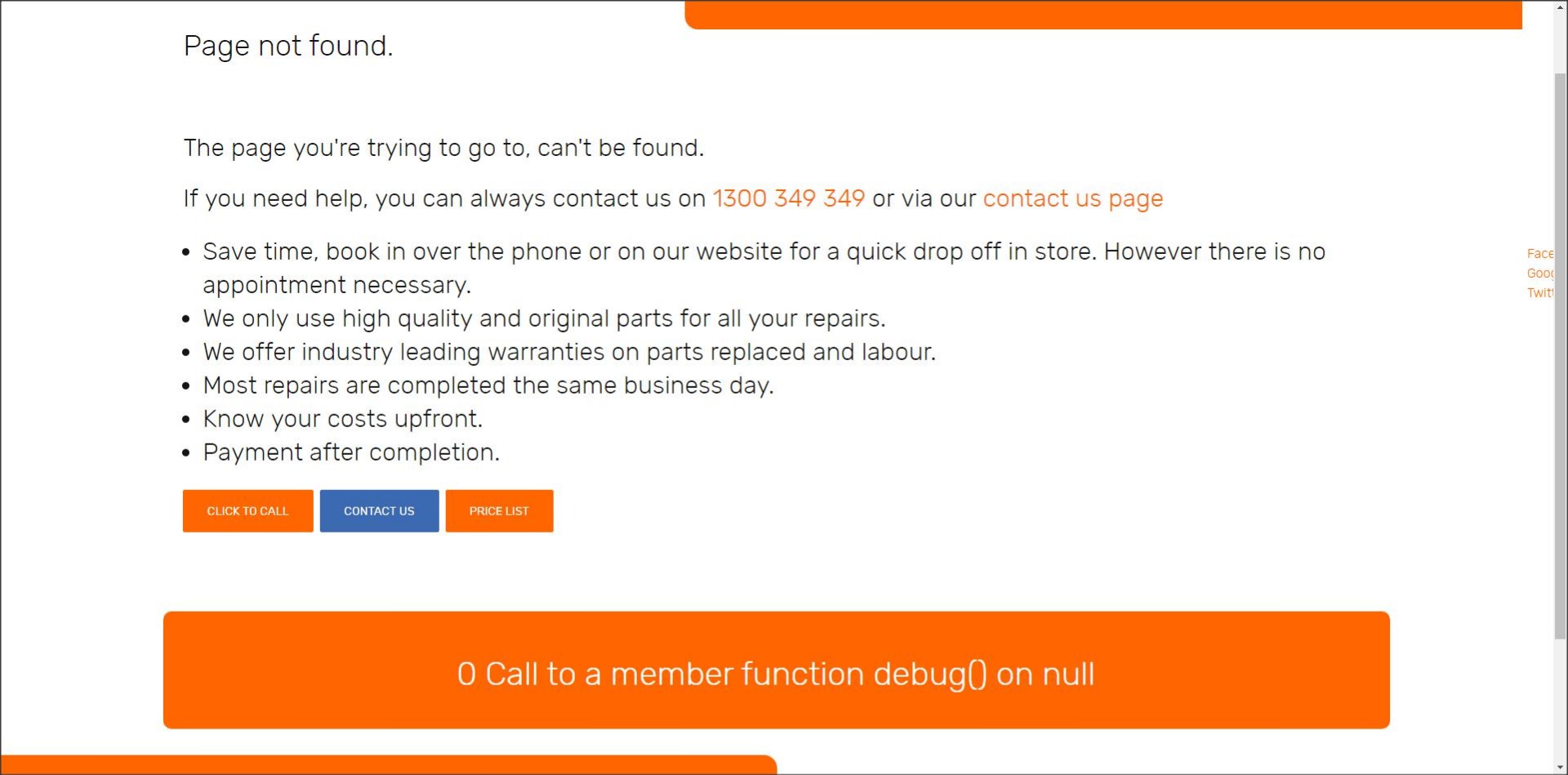

Thanks, I have updated Hikashop and that issue seems to be fixed but now the checkout page isn't working. I don't know if these issues are related or not. But because they might be, I thought I should follow up here.
The issue is now that if I have JotCache enabled, the checkout page doesn't work and shows the error: "0 Call to a member function debug() on null"
Turning JotCache off fixes the problem but I have been using JotCache with Hikashop for years without any issues previously. I updated JotCache but it didn't help either.
Any ideas?

8 years 9 months ago #283370
I guess I'm doing something wrong but I can't seem to get that error in a log file. PHP error logging is enabled but nothing is showing up.
I also tried turning on error reporting in joomla to maximum and still nothing.
I have attached a screenshot of the checkout page error.
  • Posts: 86081
  • Thank you received: 14190
8 years 9 months ago #283382
Maybe you're not looking in the correct log. Make sure that you're looking at the PHP error log, not the apache access log or other log of your server.
And you might want to ask help to your hosting company in order to get the PHP error log.
