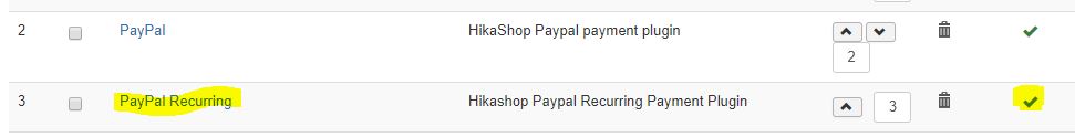

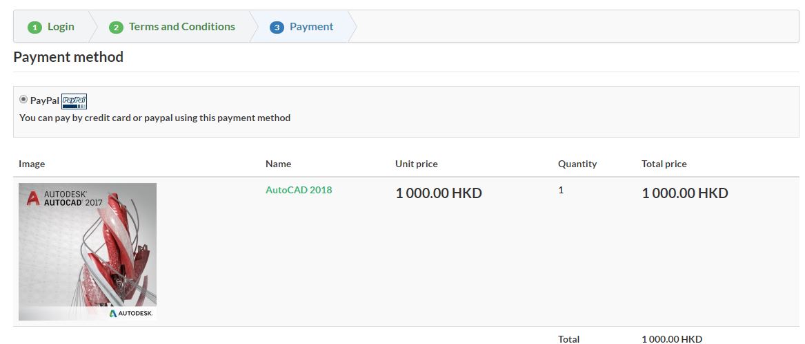

I need to implement the recurring Paypal subscription payment in Hikashop, I have installed and enabled the followings:
1. Akeeba Subscription Component
2. Akeeba Subscriptions - HikaShop Integration Plugin
3. Hikashop Paypal Recurring Payment Plugin
I have read the instructions ( www.hikashop.com/support/documentation/1...a-subscriptions.html ) and configured the Akeeba Subscription Component accordingly. However, the settings do not work at the front end, and the Hikashop PayPal Recurring plugin does not appear for selection in the check-out page.
Please advise. Thanks.
