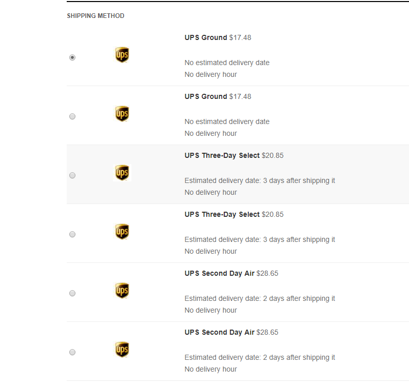

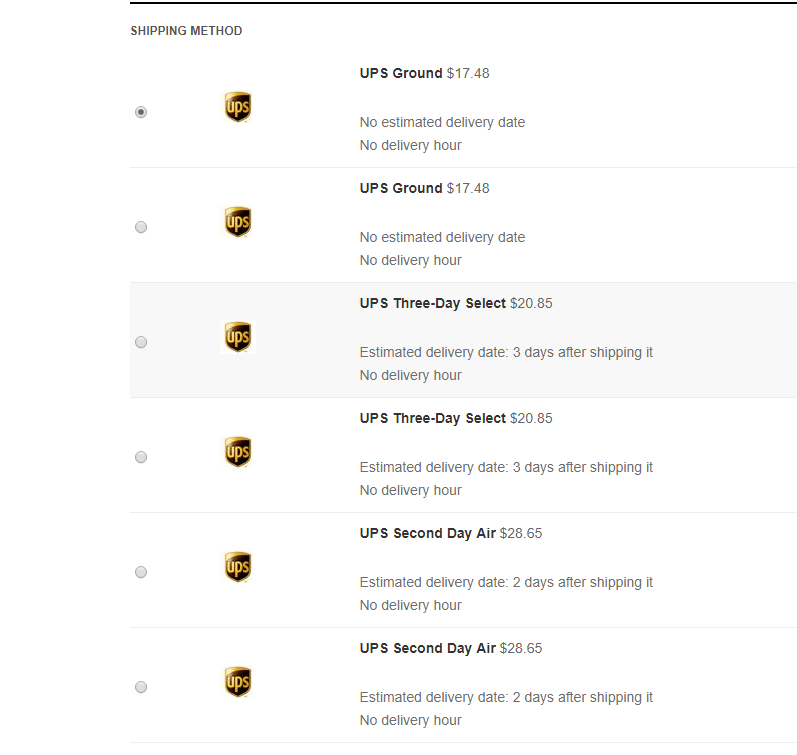

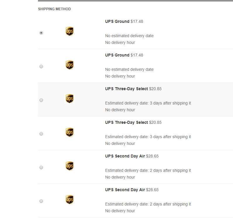

And I just noticed that all the shipping options are showing up twice. This was not happening previously, so I'm not sure if this was due to a recent update or what is going on with that, but I'd love to resolve it.

As for shipping showing up twice, I don't think I was clear. Each shipping option is appearing twice (UPS Ground twice, then UPS 3 Day Select twice, etc.)

3. So it's not the shipping view being twice in the checkout. The problem comes from the shipping methods. You must have configured two shipping methods for UPS instead of one. Please check on that in the System>Shipping methods menu.

That's correct. I needed to setup 2 shipping methods (per Hikashop instructions) in order to have our packages. We have 1 Shipping Method 'UPS' and one for not grouping packages called 'UPS - No Grouping'.

Then I don't see the problem ?
It's then normal that you have the shipping methods doubled. Once for the products grouped and once for the products not grouped.
You get the same prices because I suppose you only have one product in your cart and thus one package.

There isn't a functionality problem, but from the customer side of things it looks confusing and looks like we don't know what we're doing.
8 years 3 months ago #292302
Thank you for your feedback, we'll add on our TODO list the creation of a solution to properly prevent that kind of situation to happen again with the "Group packages" option.
